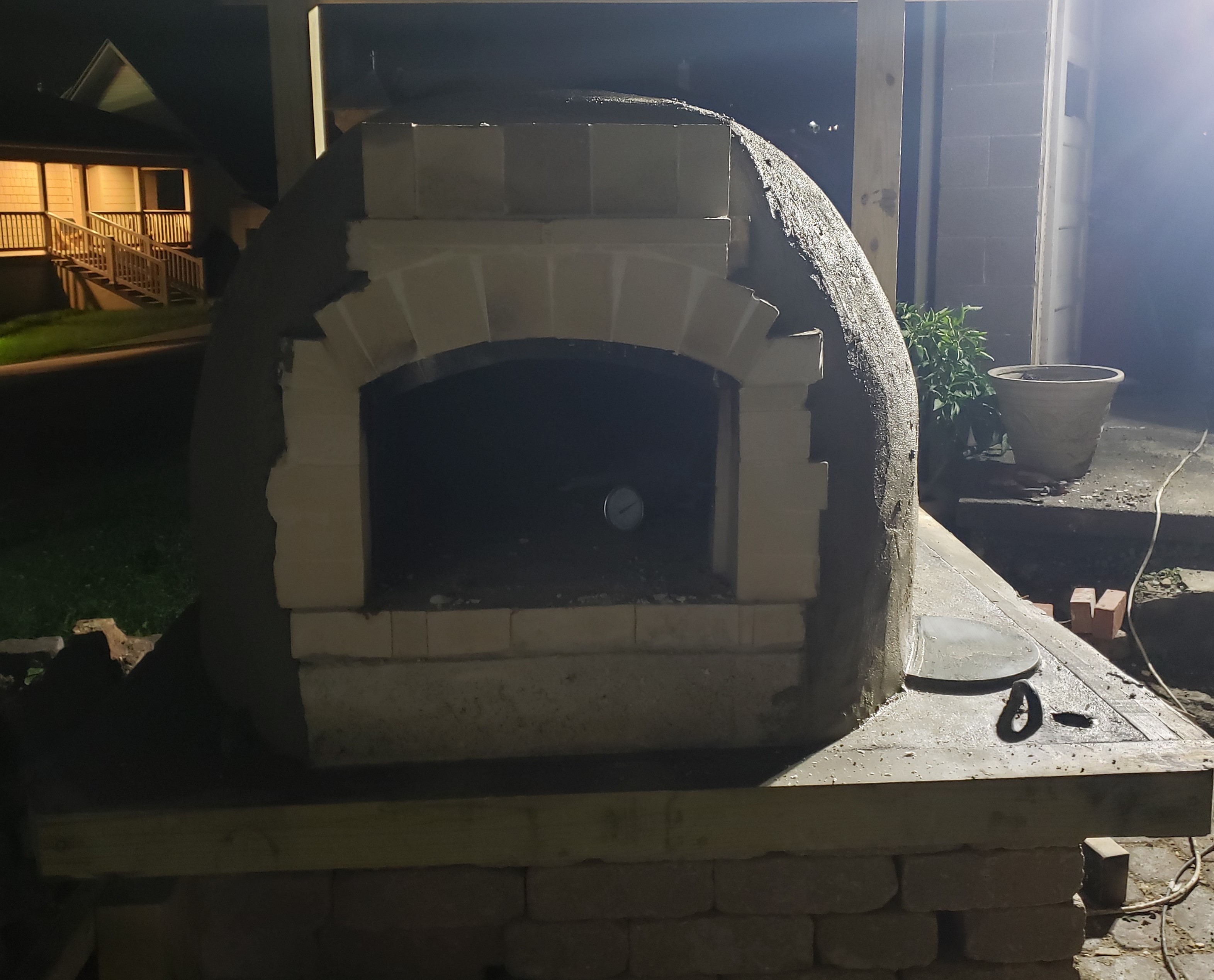

    This is My first Pompeii. I now know ( about 85% of the way done ) that i will build another.
    I will try to add an album.
    I am not a professional and everything i did, I researched and gave it my all.
    I have had issues thus far.
    I have some Questions regarding the dome rendering.
    Question 1 - scratch coat, is that just home mixed mortar?
    I mixed 1 part dehydrated lime, 1 part Portland cement, 4 parts mason sand.
    That was my first render coat ( is this what they call a scratch coat? )
    Question 2 - Is there a different coat/ mixture that goes on now/next?
    I am getting a bit confused with Stucco finish, vs scratch coat / brown coat... ugghh.
    I feel that if just put another layer on with the home mixed mortar, but lay off the lime?( take about a quarter of the 1 part lime out on second coat ).. it will be a bit stronger ?
    then put a finishing stucco on that?
    Question 3 -and what does everyone use?
    lowes/homedepot stucco finish coat? Homemade mix?
    queston 4 - does anyone know, If u use refractory cement over the base coat. would that be wise? or just stick to stucco when i figure all that out?
    Thank you in advance for the help!

          Thank you sir, any recommendations on the rendering of the Dome? I insulated 2'' and covered with part lime 1 part Portland cement and 4 parts sand. a lil extra lime and cement for first ix and layer.
          Please advise if this is ok to do.
          I am still trying to learn as much about rendering that is can at this time. its getting cold and my time is running out !
          I was thinking of getting refractory cement for the second coat then a strong stucco for the finish.
          Am i on the right track?
          or should i stick to the cement mix i used for first layer and lay off the lime and put more cement on second layer?

              And yes, I only did two inches of ceramic insulation. I poured a key stone of refractory cement and covered a decent size of the top.
              I had researched a good bit and did not have the space for the a few inches of vermiculite concrete around the dome. I was only going to do 1 inch of insulation and am glad i decided on 2'' now
              humm, now i am wondering if the render i made will crack after curing?

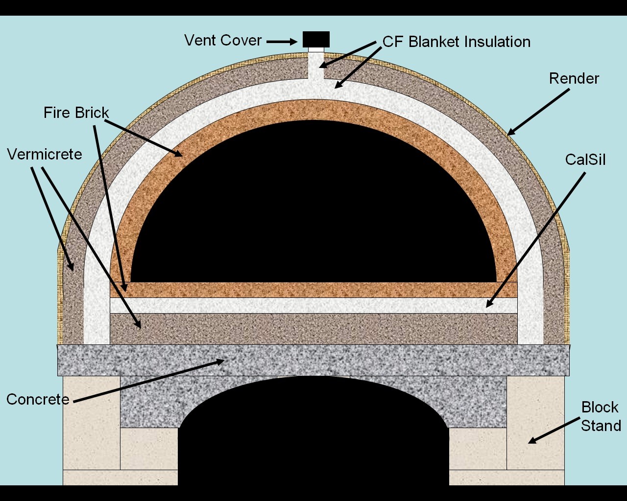

                          I'm sorry for confusing you. The vent/breather is just a hole in the dome shell to allow trapped moisture or steam to escape. It is thought that they are only important during the initial drying fires of the oven and anytime afterward that the oven has gotten wet or has been unused for a long period of time. It is usually placed at the apex of the dome. The hole should extend down to the top of blanket insulation. Though, many of us did, you don't need to think of it as something that you need to get from the autoparts store. But, it will need some method to keep rain from entering. The first one that I remember seeing was (I think) on cobblerdave 's build. It was a simple gooseneck shaped brass or copper pipe that threaded into a brass fitting that was embedded into the stucco/render. I believe that he removes the gooseneck when it is not needed and plugs the hole with a threaded plug.
                          There are other methods of venting the shell. Also, there are a lot of ovens out there without them. It is not a critical item IMO. However, I do recommend them. Good luck on your search. There are lots of discussions about them on the forum. I hope this explanation helps.

                              From what you described, you should have 2" of blanket under your stucco. Don't drill any deeper than through the first coat of stucco that you have installed. If you are uncomfortable about drilling the hole. Then don't. If you do, i wouldn't use a hammer drill. I would also place a depth gauge to make sure that I did not drill down any deeper than just barely through the stucco.
                              The bushing should not stick out above the stucco, but any type vent cover will have to be visible.
                              I don't understand the part of your question that I highlighted. Looking at my diagram and reading a few more threads should help.
                              A metal bushing would be fine as long as it has some type of rust prevention.
