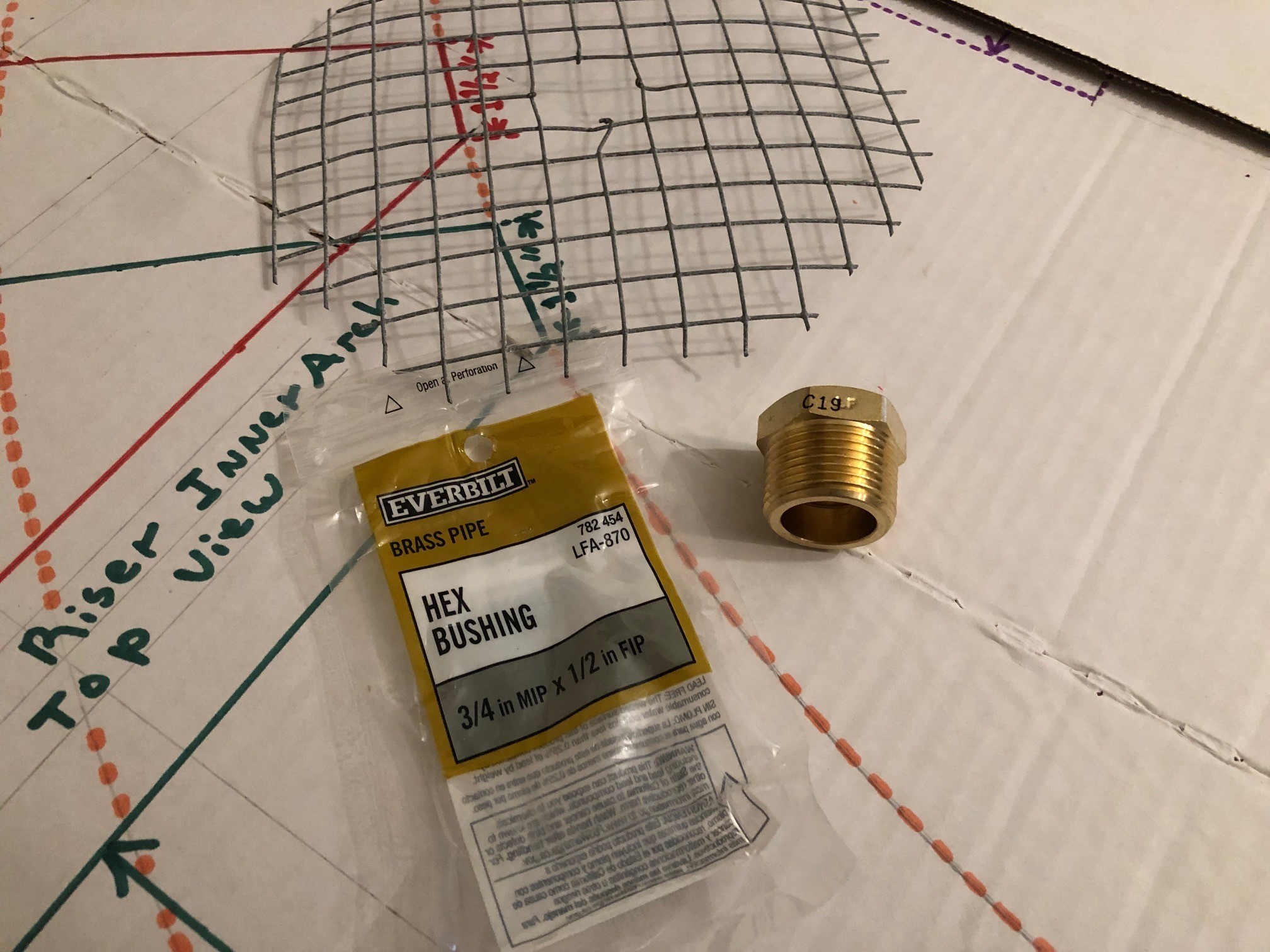

    This is what i purchased.

      That could work. I am assuming that you have test fitted all of this. Pipe threads and bolt threads aren't always compatible. Assuming that they are, here goes:

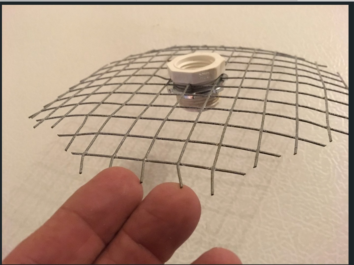

      You will want the bushing or receiver to be firmly embedded in the stucco so that it will not turn if the vent cover seizes a little. You may want to see if you can sandwich a piece of mesh between the brass fitting and the nut. It may take some JB weld to secure it. That will allow you to embed it securely into the next layers of stucco. Below is a pic of what I have done with a threaded pvc reducer and an electrical conduit jam nut. I think that the last one I put together for demonstration purposes had the mesh jammed between 2 conduit jam nuts. I can't find that pic right now. But, I think that you get the idea.

        I found this 3/4" to 1/2" brass fitting while cleaning up my shop this morning. They can be found in just about any hardware store. One like It and a couple of 3/4" electrical jam nuts would probably be a little easier to fab than the fitting that you have IMO.

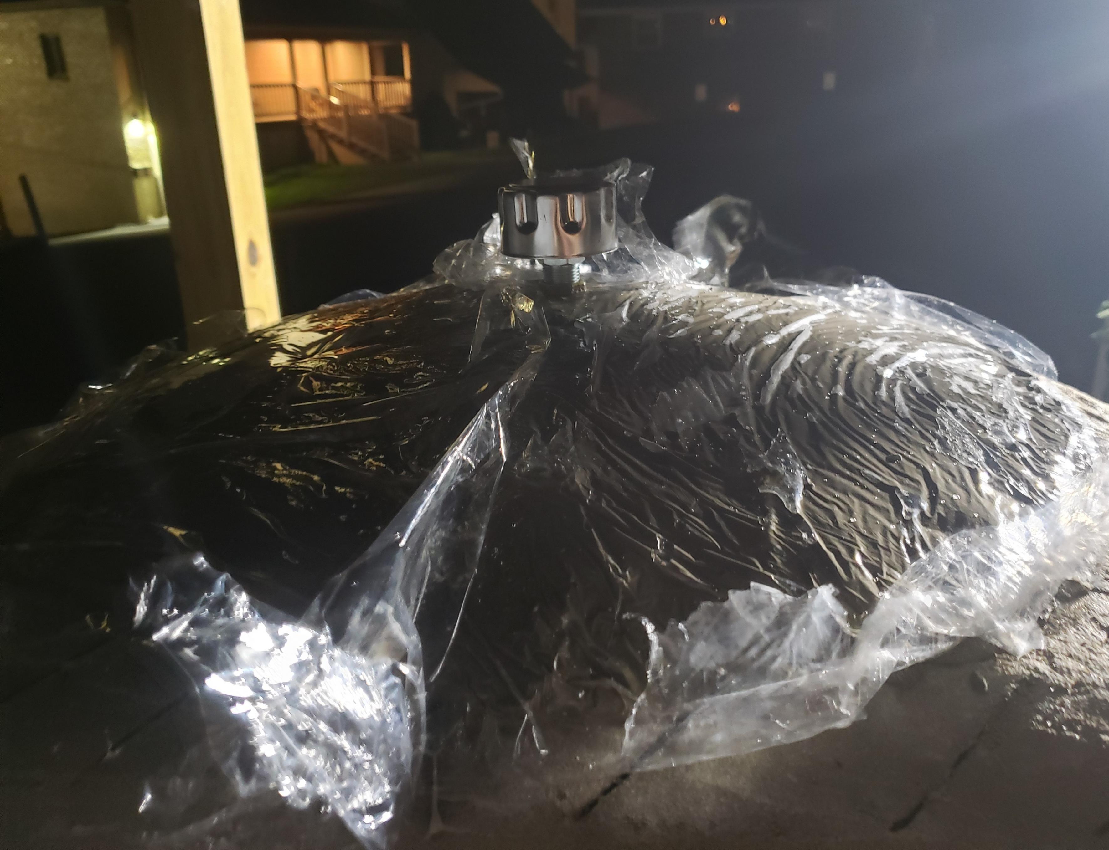

          It worked well
          I had to double the chicken wire up and it locked in well with the nut. I was careful when drilling( with regular drill and a mason bit) to not puncture or damage the insulation.
          I t went it pretty snugly with a few taps.
          I left some room for the scratch coat and finish coat. I may have to make the brown coat a slight bit thinner at very top, around the nut. so that i can put the finish stucco layer on.

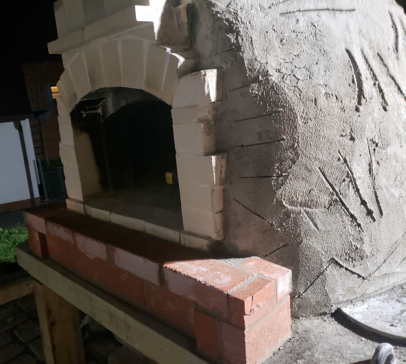

          I also attached the front brick work for the hearth.
          I am going to lay a 1 inch thick piece of soap stone over with refractory mortar. then brick another arch over the rough cut firebrick.
          Thank you so much for the Breather suggestion. I can see it helping a ton with curing and not causing further damage to the oven.
          after the hearth and arch and vent and 2 more stucco layers.. she will be ready to fire up! Im so excited and hope it all works out well enough for my first oven build.
