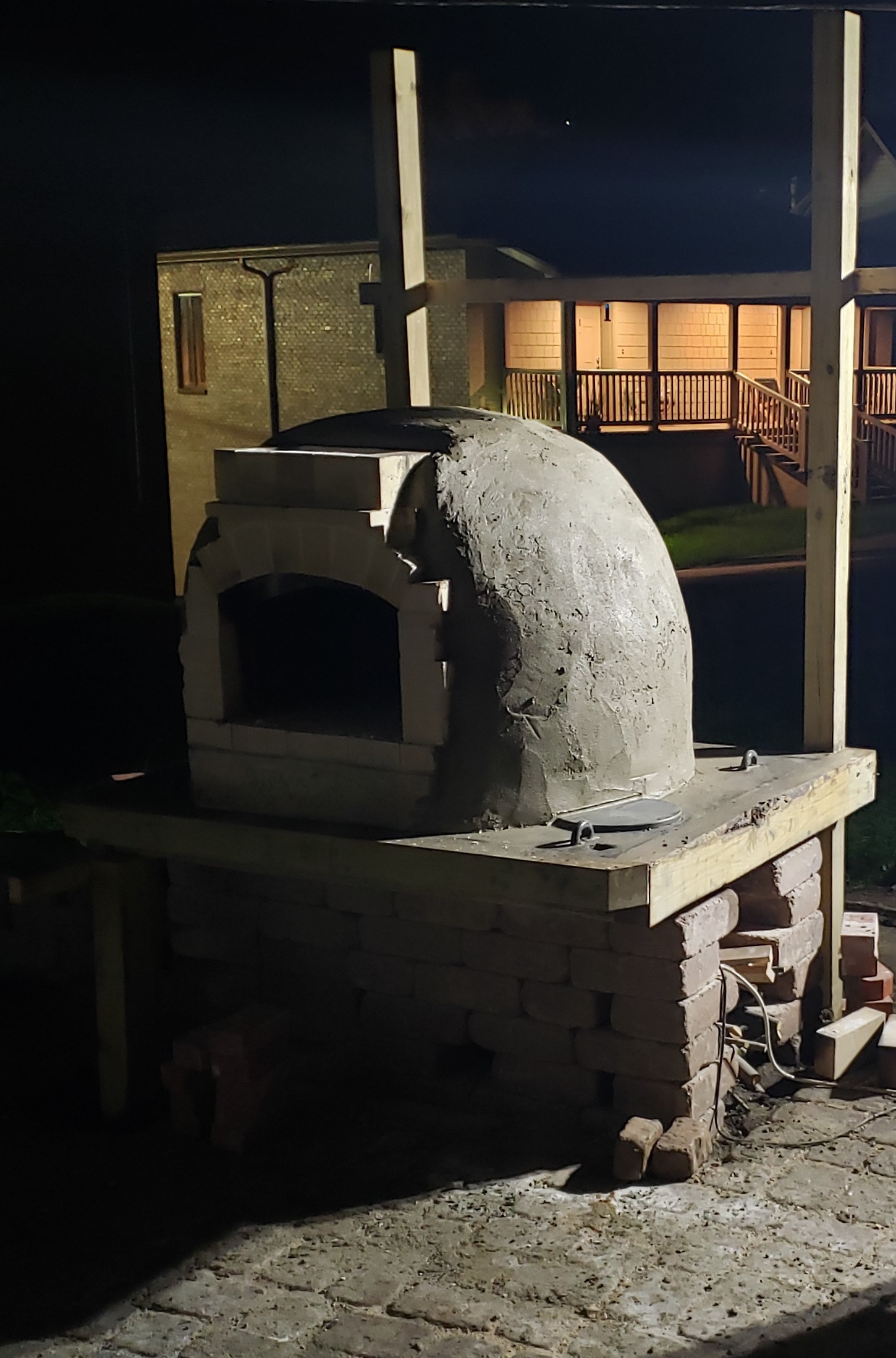

    Thank you sir, any recommendations on the rendering of the Dome? I insulated 2'' and covered with part lime 1 part Portland cement and 4 parts sand. a lil extra lime and cement for first ix and layer.
    Please advise if this is ok to do.
    I am still trying to learn as much about rendering that is can at this time. its getting cold and my time is running out !
    I was thinking of getting refractory cement for the second coat then a strong stucco for the finish.
    Am i on the right track?
    or should i stick to the cement mix i used for first layer and lay off the lime and put more cement on second layer?
    what did you use? for dome rendering?

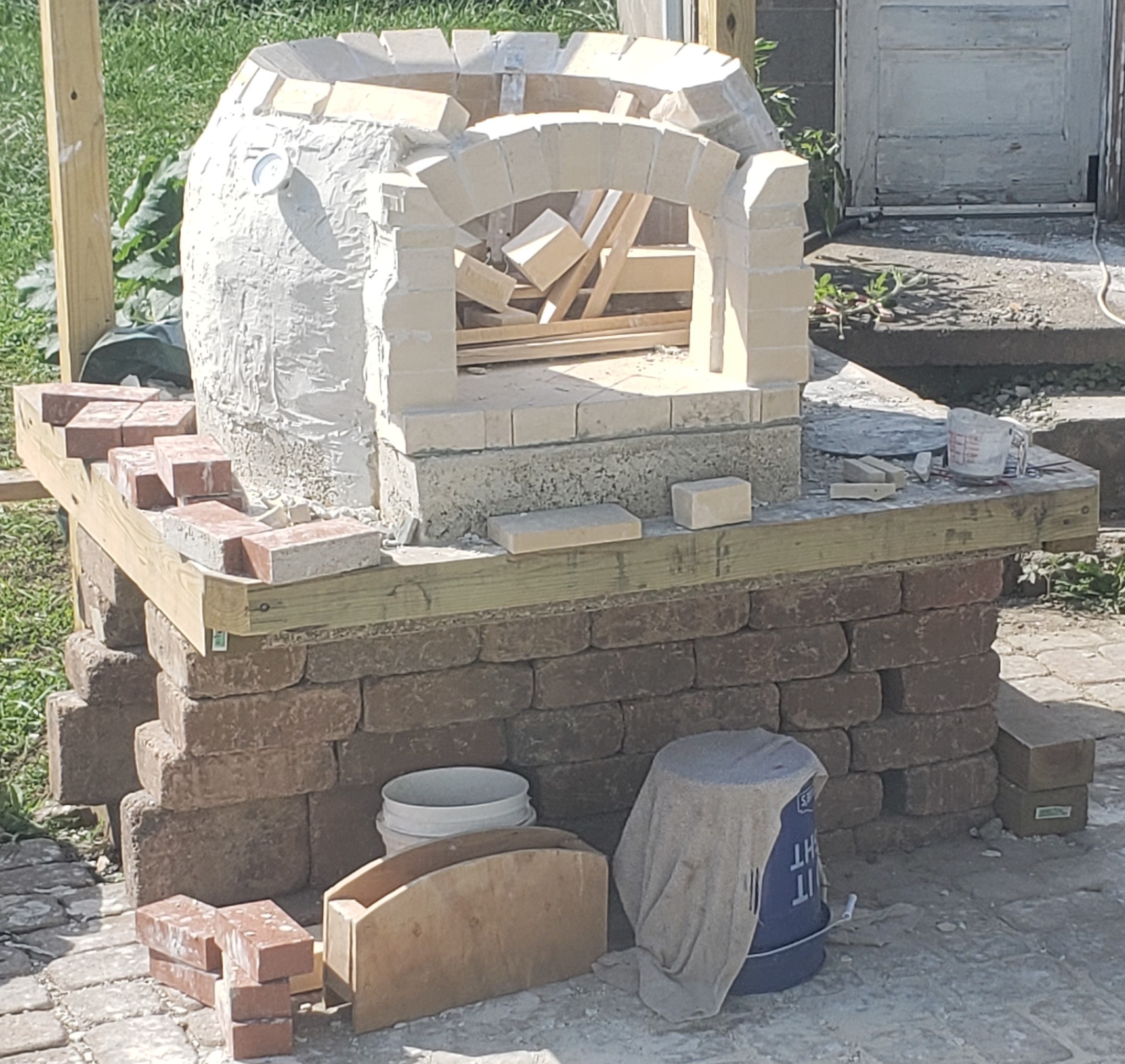

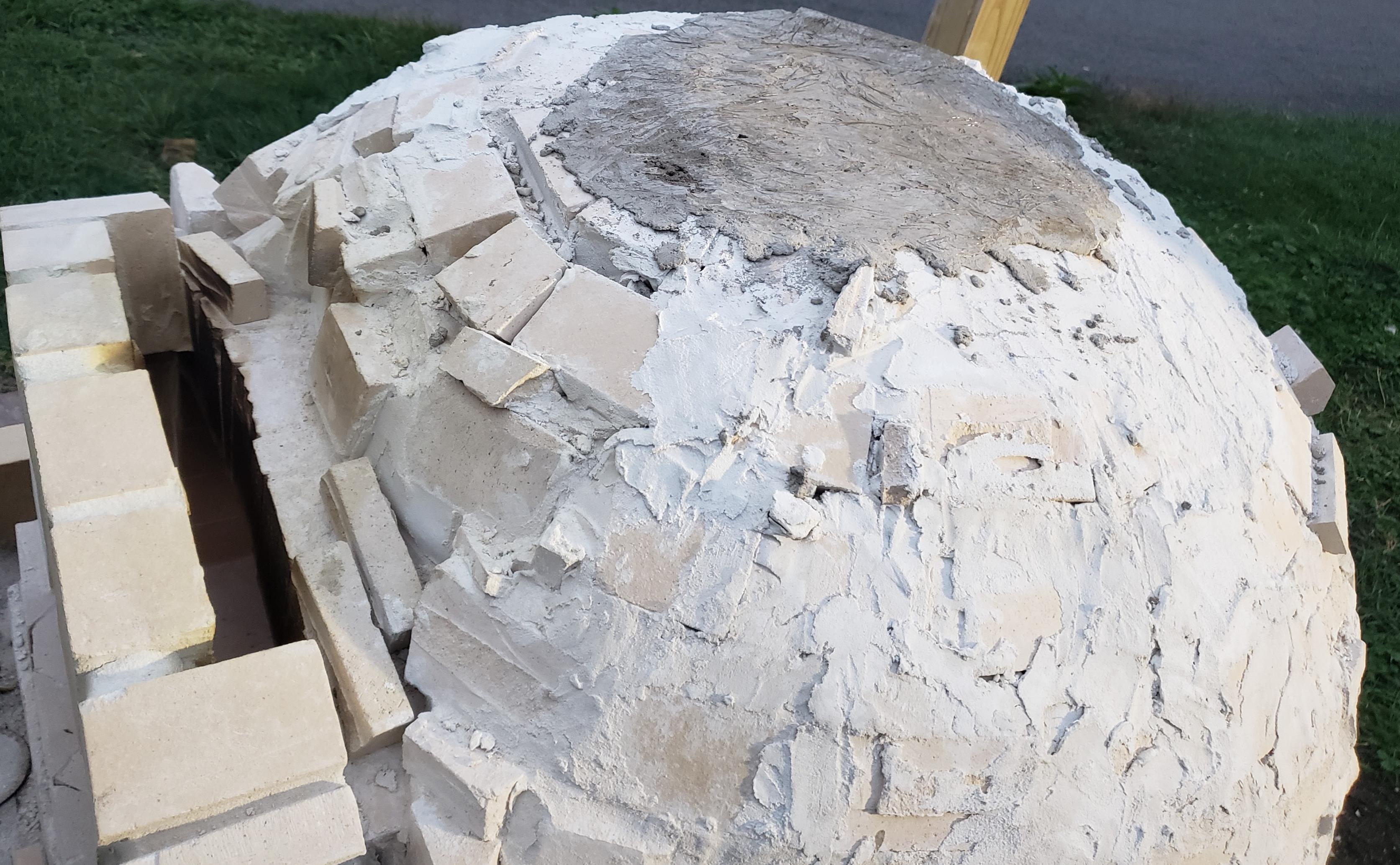

    started a topic 32 inch Pompeii Build
    HEY HEY
    This is My first Pompeii. I now know ( about 85% of the way done ) that i will build another.
    I will try to add an album.
    I am not a professional and everything i did, I researched and gave it my all.
    I have had issues thus far.
    I have some Questions regarding the dome rendering.
    Question 1 - scratch coat, is that just home mixed mortar?
    I mixed 1 part dehydrated lime, 1 part Portland cement, 4 parts mason sand.
    That was my first render coat ( is this what they call a scratch coat? )
    Question 2 - Is there a different coat/ mixture that goes on now/next?
    I am getting a bit confused with Stucco finish, vs scratch coat / brown coat... ugghh.
    I feel that if just put another layer on with the home mixed mortar, but lay off the lime?( take about a quarter of the 1 part lime out on second coat ).. it will be a bit stronger ?
    then put a finishing stucco on that?
    Question 3 -and what does everyone use?
    lowes/homedepot stucco finish coat? Homemade mix?
    queston 4 - does anyone know, If u use refractory cement over the base coat. would that be wise? or just stick to stucco when i figure all that out?
    Thank you in advance for the help!
