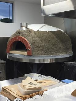

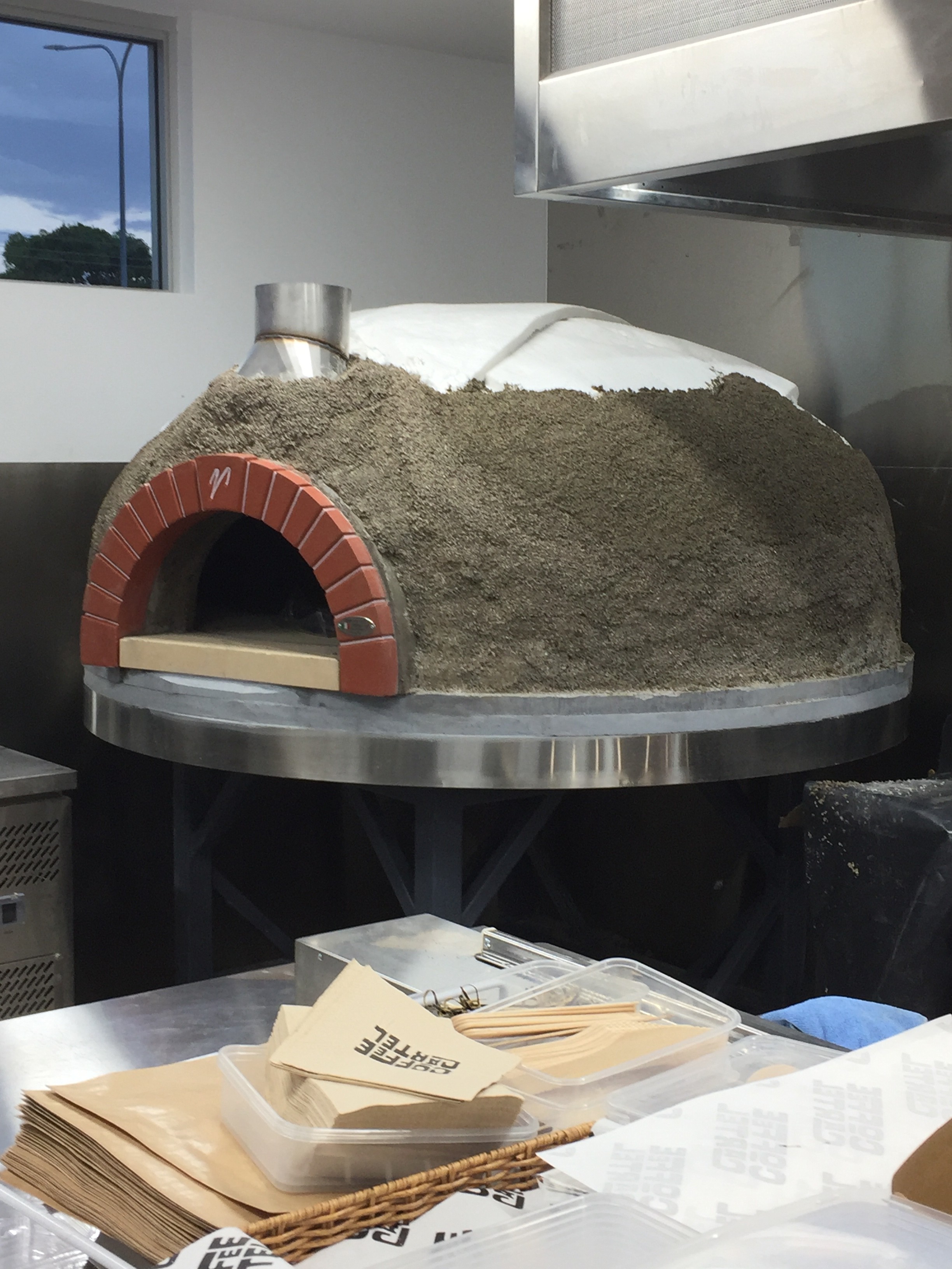

          I hate corner builds. If you can get in behind the oven, then ok, but if the supporting slab is jammed up into the corner, it's a real bitch to build an igloo style oven. I'm currently working on a 1.6m internal oven in a restaurant and the application of the vermicrete requires squeezing into a tiny space behind the oven, entering under the stand and squatting for every handful of mix applied. My quads are killing me.
