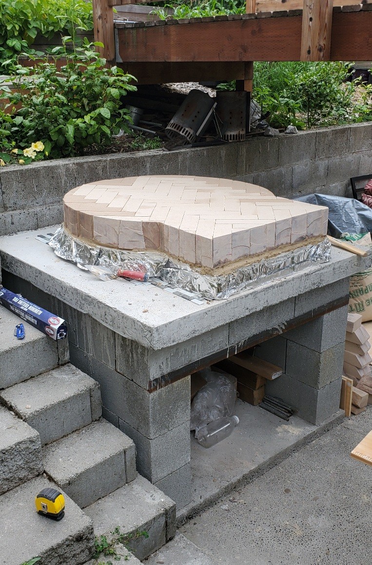

    It's been a while since I last posted on the progress of my oven build. While the oven is nearly finished and has already been used to cook pizza, I will dedicate the next few posts to documenting the build process, hoping that it might help someone in the future.
    After the hearth was poured, I drilled several holes in it and laid out ceramic tiles to elevate the 4" calcium silicate board. In hindsight, I've learned that I should have laid the ceramic tiles bottom facing up, but it should still be better than nothing.
    The calsil board was cut to shape with a jigsaw and covered with aluminum foil to protect from moisture.
    The firebrick was laid on a thin bed of fire clay and sand mixture. I think I was able to get the floor pretty even. Note that I placed the floor brick on their side for extra heat retention. The floor thickness is 4.5 inches.
    For cutting the bricks, I used a 10" sliding composite saw from Harbor Freight that I fitted with a diamond blade. Bricks were always soaked before cutting but there was still an incredible amount of dust. A mask was a must-have.

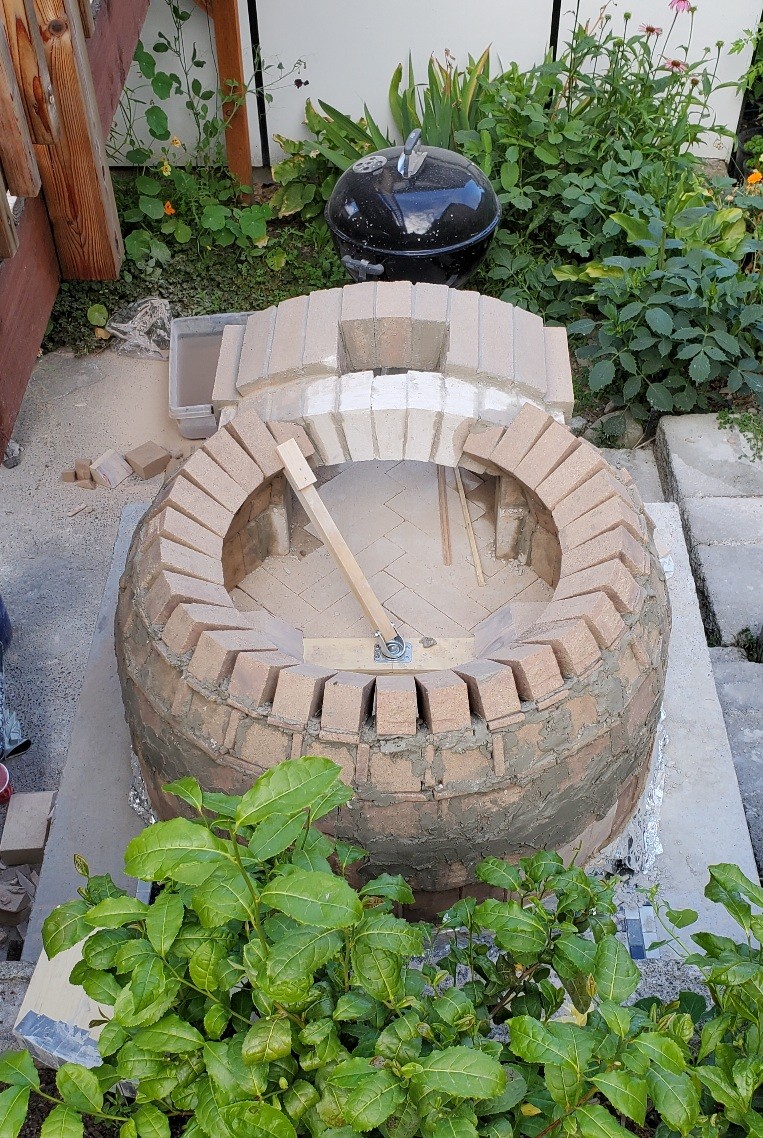

      Next up: Brickwork.
      Building the dome tier by tier. I mixed a homebrew refractory mortar. Lots of wedges between the bricks. Flue gallery and chimney base with carefully angled cuts.
      For the last tier and capstone impatience got the better of me and the fit and finish on the inside suffered a bit. Still very much functional though.
      The build videos on the YouTube channel 'Artisan Made' really helped me.
