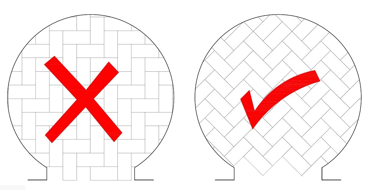

    4. If your bricks are laid herringbone and on the diagonal to your entry, you should not have a problem with hitting the edges of your bricks with your pizza peel.

      I have done he heringbone pattern on my Brick oven but still my peel gets caught - I'll have to maybe set it better on this one.

        Since you're not looking for a super thick floor, you could try 12"x12"X2" bricks if you're close enough to a source to avoid shipping. There will be less joints and you could still set them on the diagonal.
        Giovanni

          Have you gone on the angle?

            Giovanni Rossi here in South Africa, we are limited with variety - i have only seen the regular size firebricks. Maybe I should consider making a mould and do my own bricks.
            MarkJerling Nope, I did not angle them and looking at both side by side - I can see why angling them would make a world of a difference. Thanks for this, I have added it to my notes.
