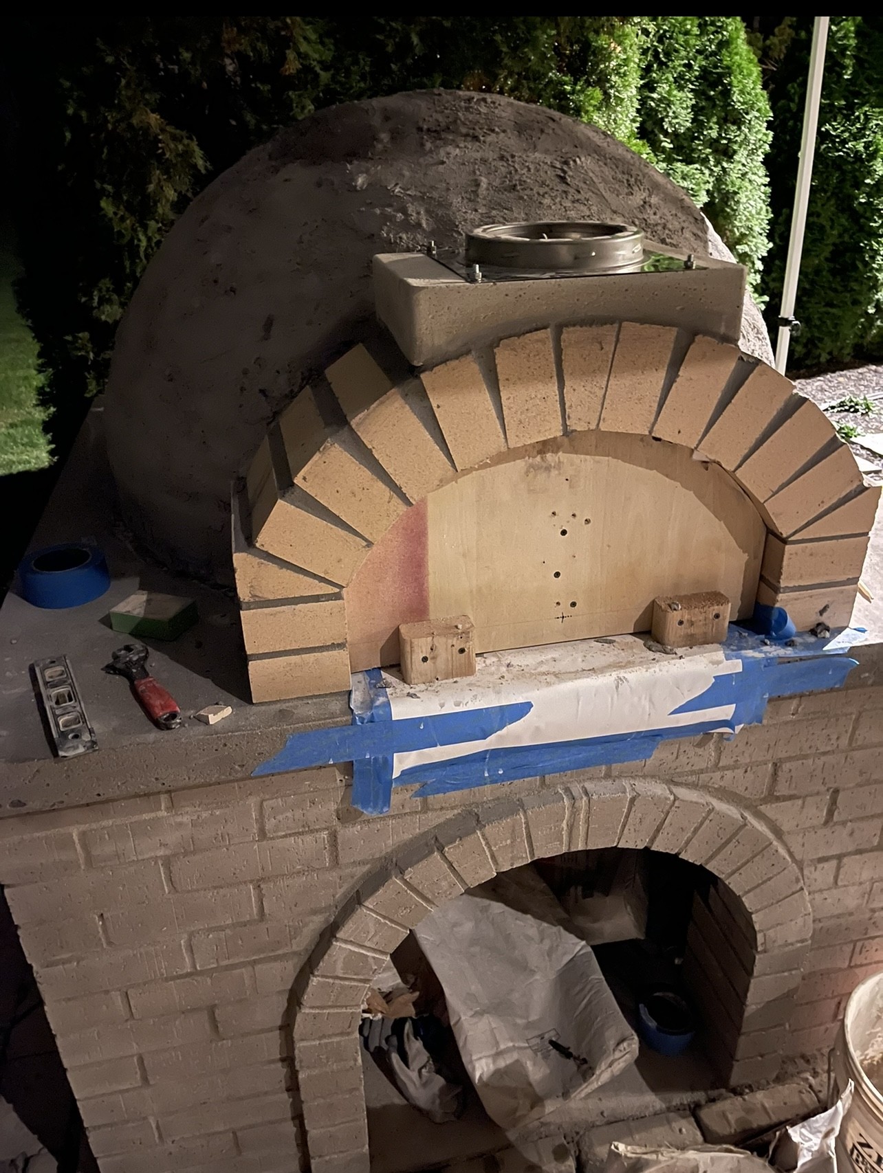

    Here’s my dome build. Next I’ll insulate with fiber blanket and render over it. Still haven’t decided on render mix. And I’m terrified about drilling a few screws into the dome base to hold down the chicken wire. We’ll see how it goes.

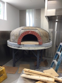

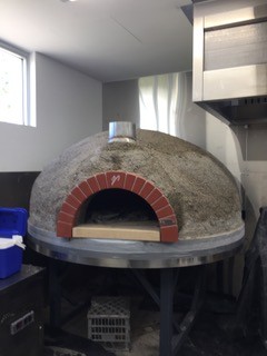

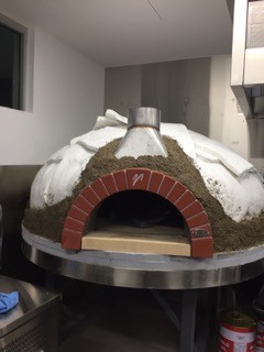

          As I said before I have never used chicken wire to tie down the blanket. In fact I don't tie the blanket down with anything. As an extreme example, here are some pics of a large (1.6m internal) oven I built which shows the vermicrete over the blanket. Unfortunately the owner installed the stand and cast slab really close to the walls on either side of the corner (I hate corner builds). This meant that there was only room for two layers of 1" blanket on the sides, so i compensated by putting 5 layers on top. The 35mm of vermicrete over the whole oven easily covered the dome to restore a nice shape. It required a variation in vermicrete thickness to smooth out the steps created by the uneven blanket layers. The vermicrete application was difficult at the sides and the back. The only way I could access the back corner was to continually crawl under the stand and squeeze into the triangle in the very corner,( a real bitch)
          I would not recommend insulating an oven with vermicrete only because a thick layer takes ages to dry. The beauty of the blanket is that it's already dry. A 1.5" or so layer is pretty dry after a week, especially if out in the sun and wind. We set up a fan because this was indoors.

                Entry arch and chimney mount.

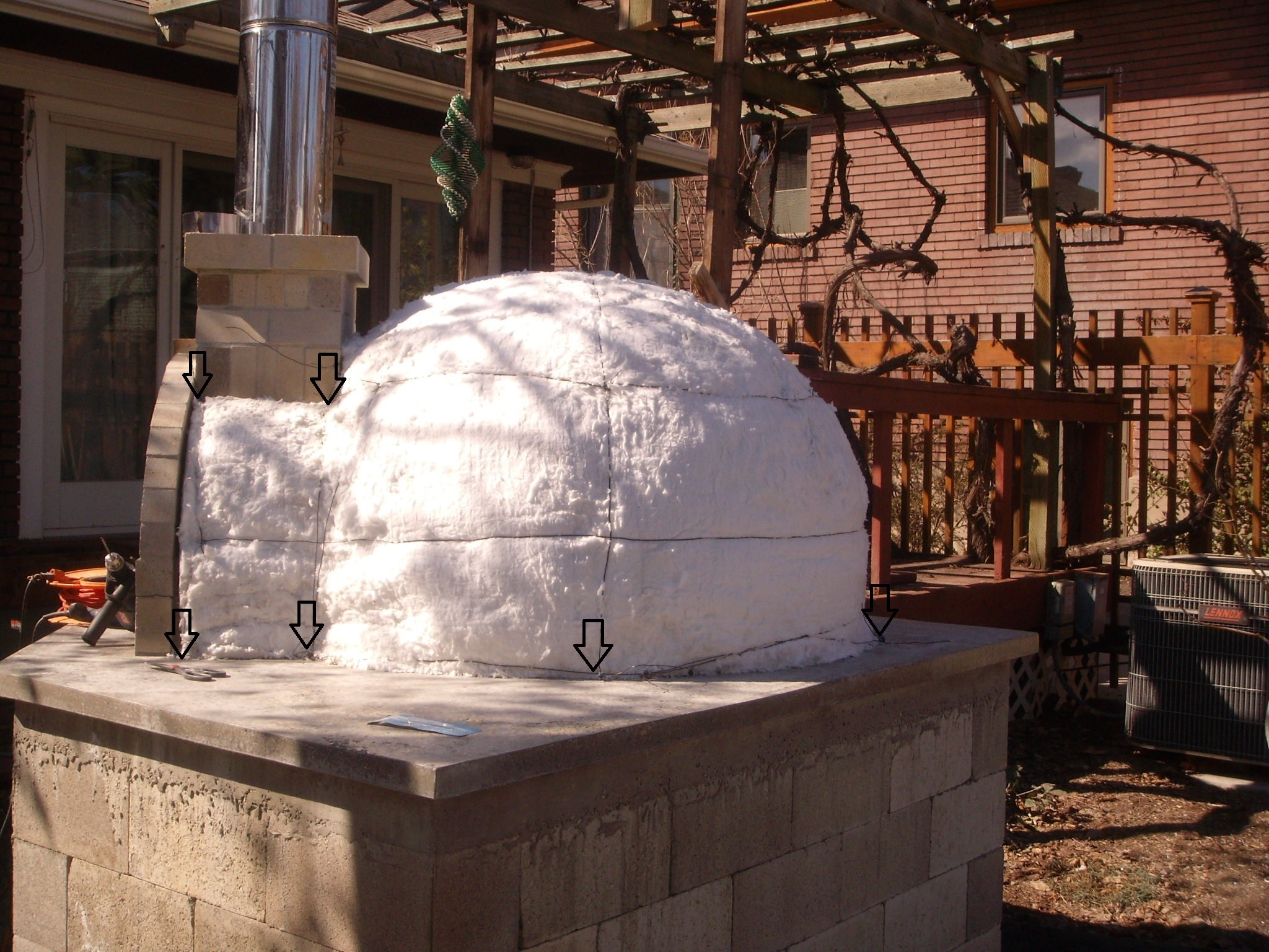

                      You can use small TapCons to drill into the base to fasten wire to hold the blanket down. You don't need many. This is what I did to fasten my wire down.

                      • #71
                        Thanks! I like this approach. Good compromise. I’ll just put 6 or 8 screws in the counter top and wrap them over the dome. I’m not going to use fiber blanket on the entry tunnel (I’ll just render that) because I have a gap between that tunnel and the inner arch which is filled with heat stop caulking.

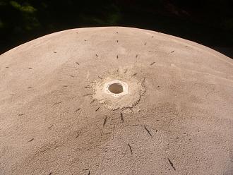

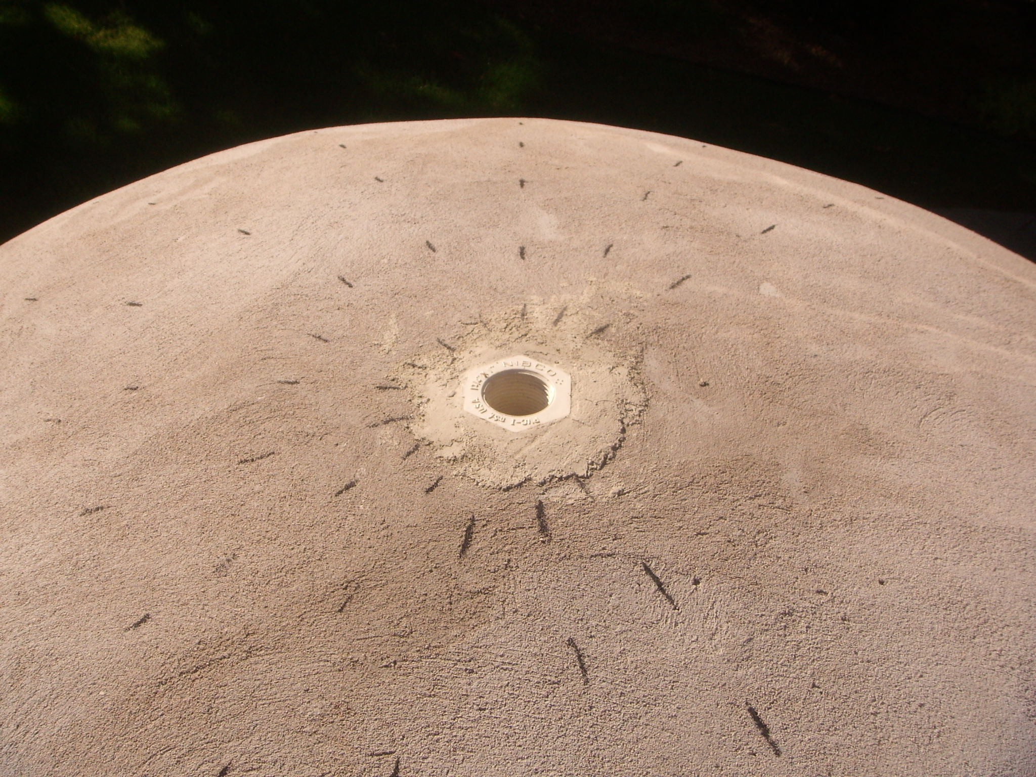

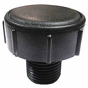

                            You can start curing with charcoal briquettes, gets you about 200 F without flame impingement and you can do a dutch oven or cast oven meal on the coals as a bonus. When you start wood, very slow go. One extra piece of wood will spike the temp very easily. This is where we see many builder get impatient going too fast too hot and crack their ovens. The turtle wins the race in curing an oven. Also, any thoughts of installing a vent at the apex of the dome since you sealed the bottom in with AL gutter foil it will also keep water that gets in from getting out. By install a vent in the apex, water vapor can escape. When water sublimates from a liquid to vapor the volume increases by 1500 X with the potential of pressurizing the dome and possible cracking. Vents are cheap and available at any auto store for under 10 bucks. Both Gulf and I use them in our builds. We used a threaded pvc bushing embedded in the stucco with the opening to the depth of the blanket.
ID:	455876 Click image for larger version
                            • #74

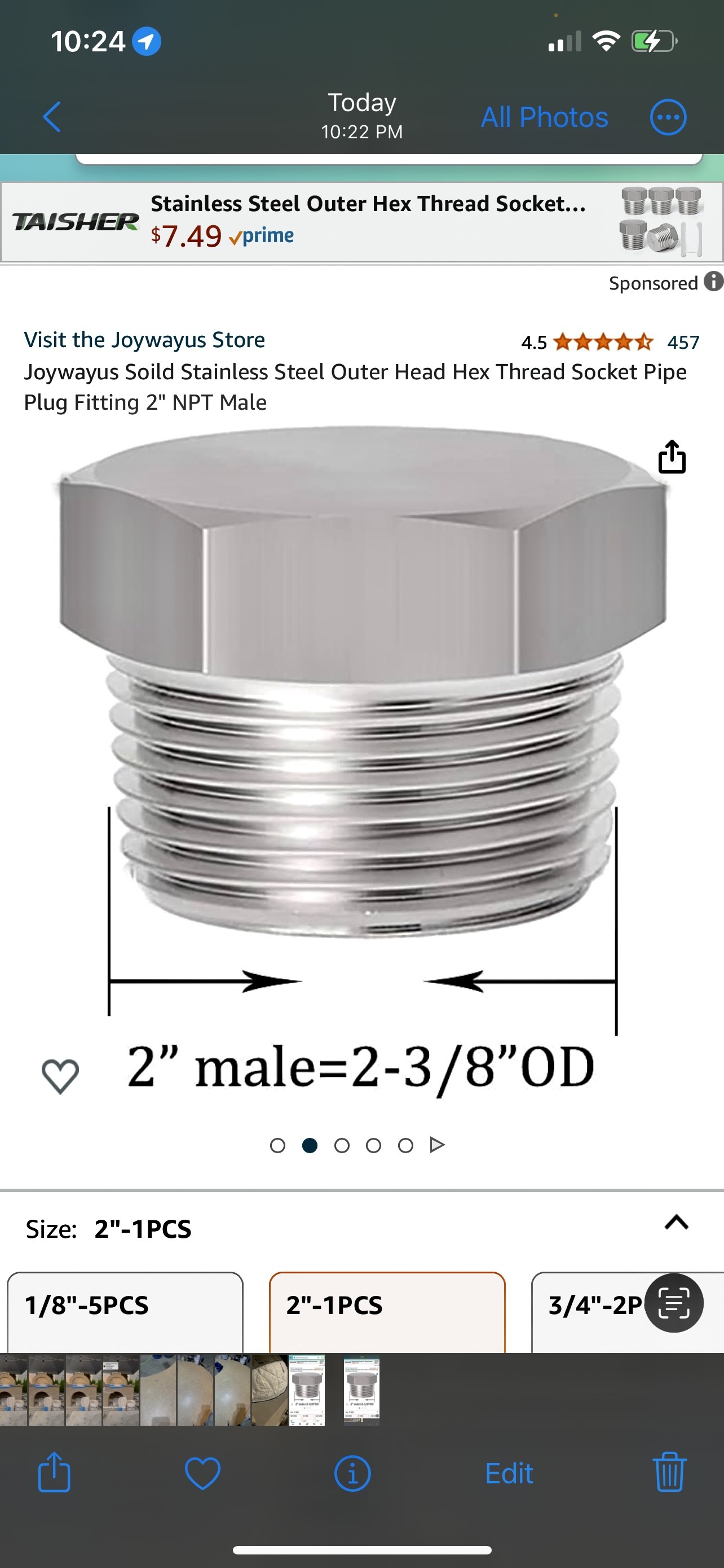

                              Man. Thank goodness for you guys. I do have drain holes in the stand, with tile/channels under the vermicrete layer. Can the water escape downward? If I get a vent on top, you’re saying it only needs to get to the blanket layer? Thank you again for following along and pointing out these things!

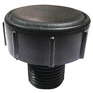

                              • #75
                                How about something like this?
