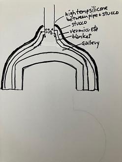

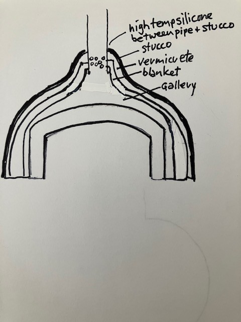

I'm a big advocate of vents for the underfloor insulation as well as for the dome insulation. After lots of thought I don't believe that a vent at the top of the dome is the ideal location for the dome vent apart from it being a bit unsightly. I have a system where the insulation that surrounds the flue pipe can exit between two terracotta collars, but this requires some specialised fabrication. A far simpler system that won't be seen is to drill some holes in the base of the flue pipe where moisture can escape.(see attached pic)

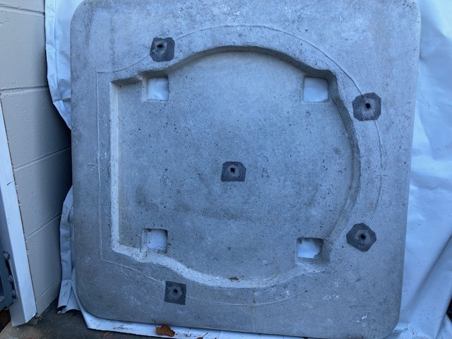

I also now have 4 vents in the supporting slab that line up with the dome insulation, as well as one in the centre for the under floor insulation. The reasoning for the placement here is that as the top of the dome on the inside gets hottest the quickest because of heat rising by convection, The dome insulation will dry out fastest in that location. As moisture accumulates in the lower parts of the dome insulation and will want to travel away from the heat source and down by gravity. Additionally, any steam pressure higher up will force moisture down, particularly as it hits the cooler outer rendered shell and re-condenses. Moisture will pass readily through blanket or lean verm/perlcrete.
Imagine if you had a saucepan of boiling water and it had a drain in the base of the saucepan. If you blocked the hole in the lid the steam pressure would very quickly empty the saucepan.

Right now I feel good about the downward drainage through the floor. A cap vent on top wouldn’t look bad (especially if I glue a tile to it), but I don’t fully understand the benefit yet. I’m thinking the concern is water/pressure building up between the dome brick and the rendering layer?Comment
Steam pressure can be enough to crack the outer shell, but the main issue is to efficiently remove any moisture that can accumulate in the insulation layers. Because water conducts heat, wet or just moist insulation will not work well and heat loss will be high, as well as considerable amount of energy is required to vaporise it. Vents allow its exit efficiently.Kindled with zeal and fired with passion.Comment
