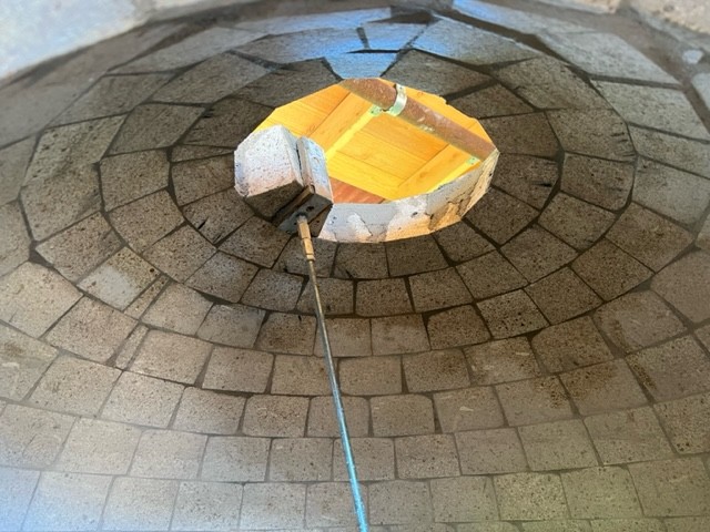

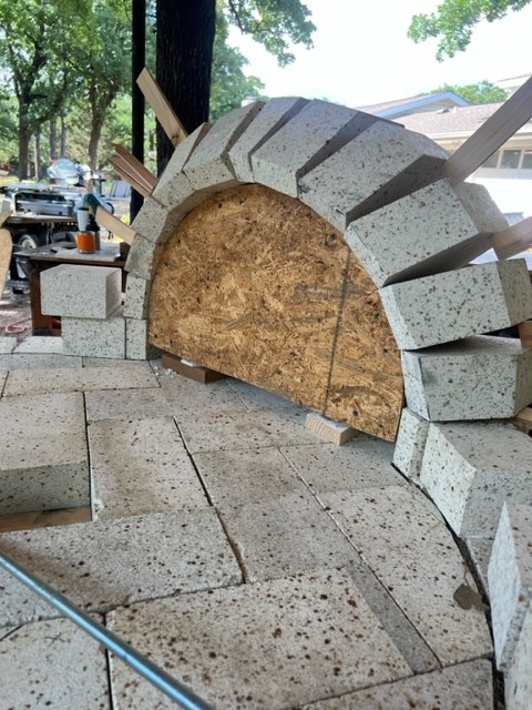

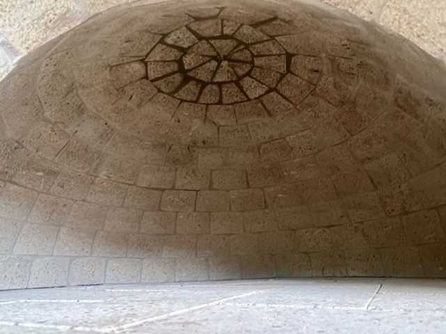

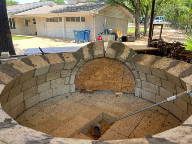

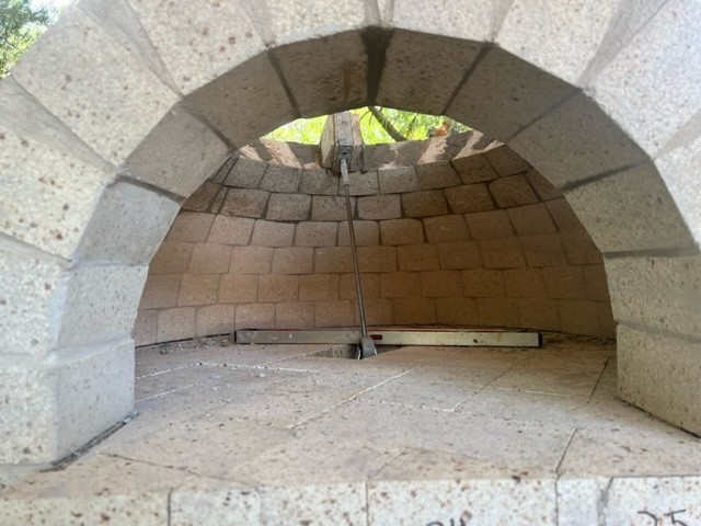

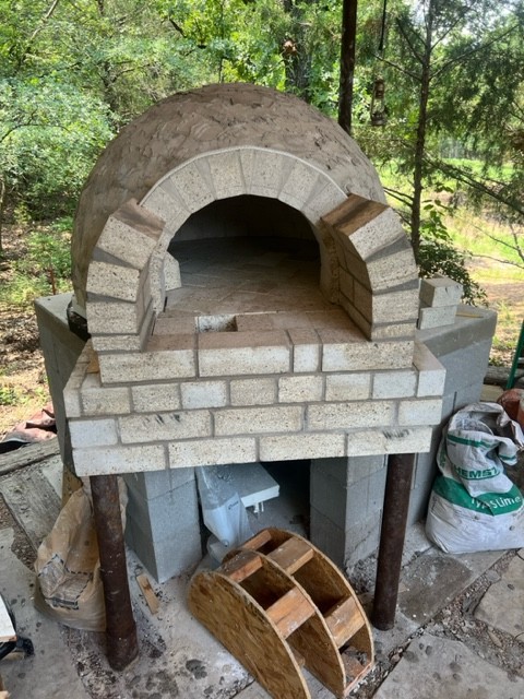

    My 9 year old son and I have been building this together and it has been going fairly well. However, today I realized that I may have given a little bit too much empowerment to him, he has been the "Mortar Man". The mortar mix that we have been using since we started turns out to be a 2-1-1-1 homebrew (silica sand, Portland cement, Hawthorns Bond, and Lime). I am keenly aware that the recommended mix is 3-1-1-1 and I own not double checking our work.
    I'm hoping its not the end of the world, but he and I could use some reassurance if anyone is willing to offer it?!?
