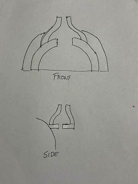

        You have in effect a gallery on top of a gallery, so the smoke flow will not be as efficient as it could be.
          Yes, a fully open path directly into the chimney would be more efficient. Luckily the actual profile is not as bad as in your sketch. The width of the gallery arch is much larger than the width of the vent arch. The chimney inlet width is roughly 90% of the vent arch width --> so no significant restriction. Depth-wise the position of the chimney does present a restriction: as a result of the very deep gallery and having the chimney centered on the gallery there is quite an offset from the face of the vent arch. For the smoke to exit the front of the gallery it would have to travel much further as well, because the gallery is so deep. Therefore I'm not too concerned at the moment, but we'll see how the actual performance is once the fires start burning.

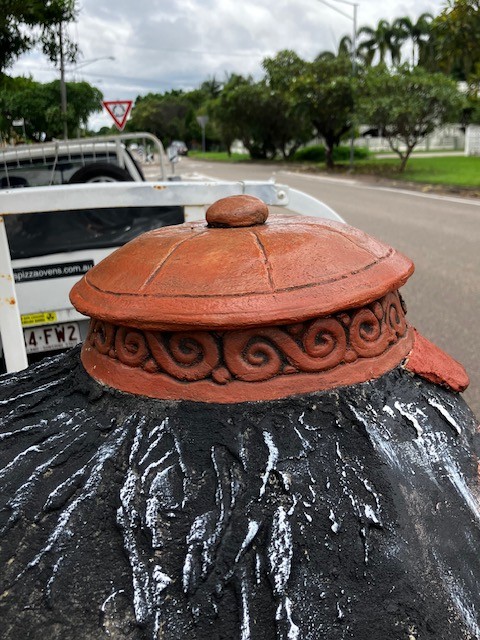

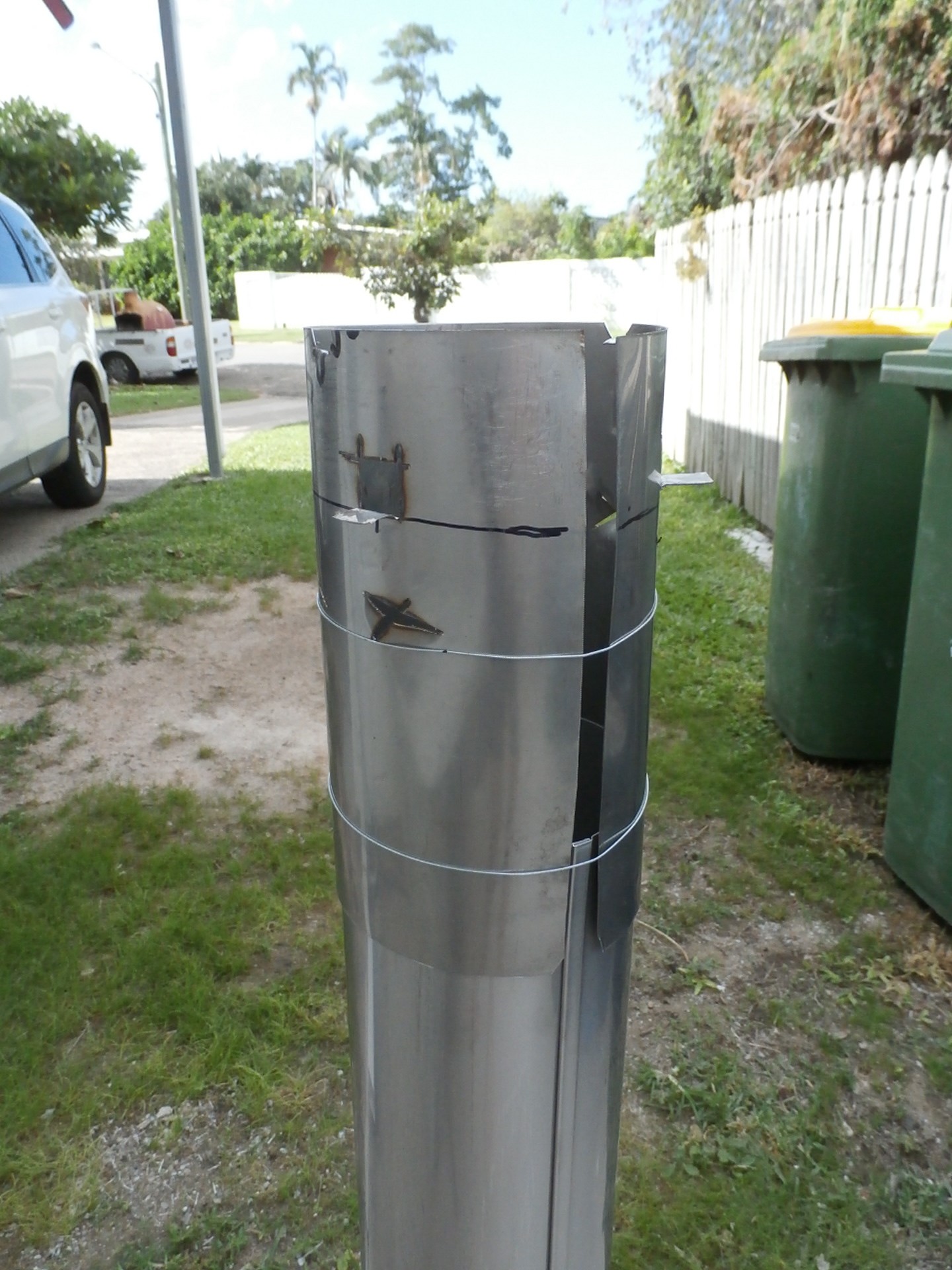

            The sleeve I make for accepting a removable flue is made from 0.55mm 304 stainless. Being thin it is easy to shape by hand. As shown in post #53 there is a space so that it does not complete a full circle. This helps in providing some room for expansion as well as providing a space to accomodate the lapped joint of the flue pipe that fits into it. To make the pipe fit inside it I wrap some plastic around the pipe, then fit the sleeve over it and tighten the wires up so they are just firm, but not really tight. The plastic allows for easy enough removal as well as providing enough of a gap so the pipe is a nice sliding fit.
            Also added a couple of pics showing the fitted sleeve and the weather cap I use when the flue pipe is not in place. Hope this helps, maybe too late.

              Thx! I'll also have to think about how to make a nice edge and a cap around the final product. The thinnest sheet metal that I could get was 1mm, so bending it in shape is a lot more difficult than 0.55mm!
              Don't worry about the gap: instead of a gap I left an overlap, so that the metal can easily slide on itself when expanding.

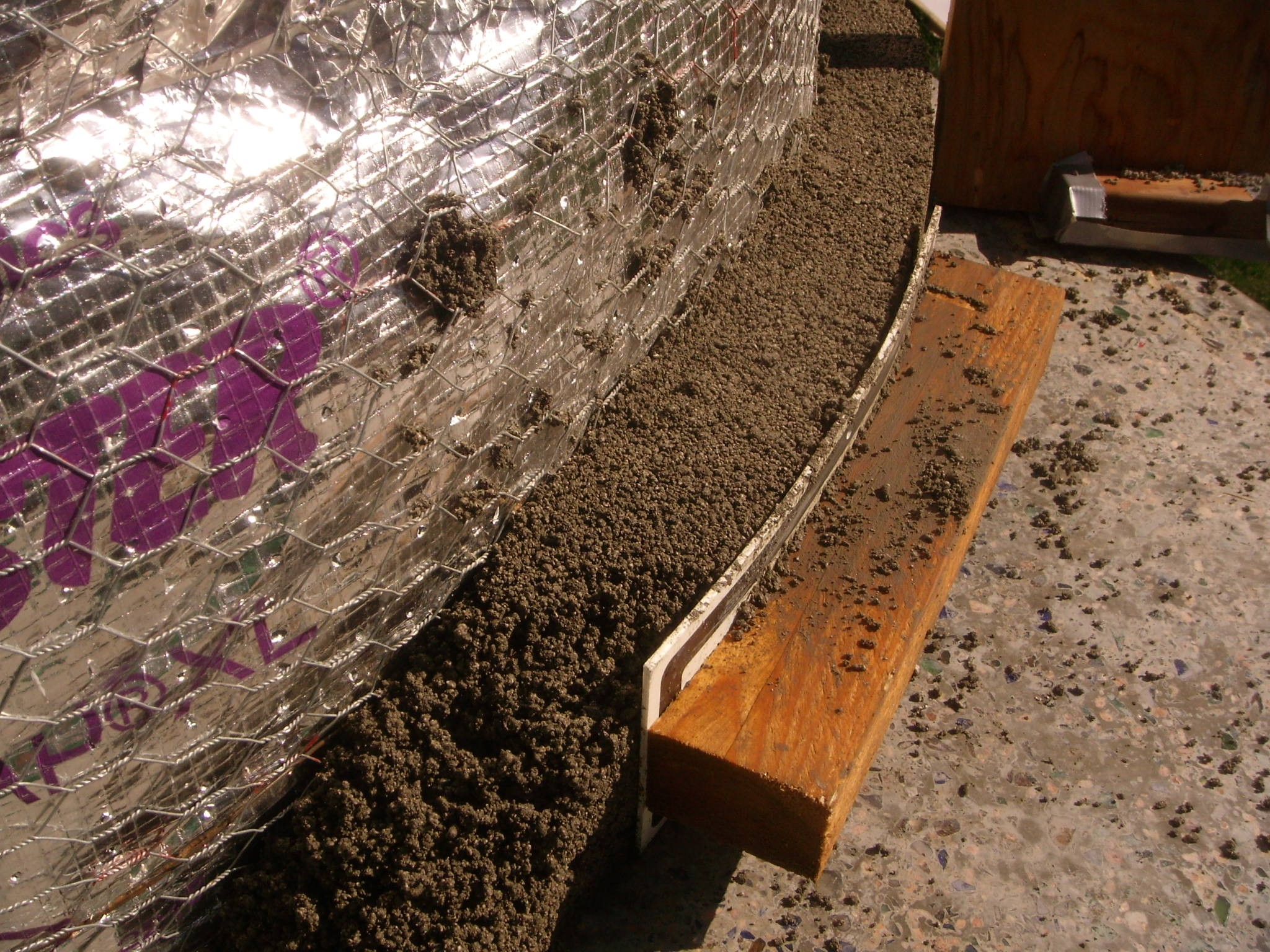

                  The good weather is back! The oven is now fitted with chicken wire to fixate the ceramic fabric a little bit more, and the first two courses of vermicrete are in! Really feeling like the last steps towards the curing fires.
                  A couple of questions on the vermicrete mix:
                  By volume I'm using 5 parts vermiculite, 5 parts perlite, 1 part portland cement. Waterwise I add until it starts loosely sticking together.
                  When applying I have to compress the mix a little bit for it to stick properly and I was wondering if that's indeed the way to go, or if I should make the mix wetter for it to stick immediately? The first course I compressed quite a lot, but now I'm just loosely pressing it with a float, so that it stays together and doesn't crack loose again. Is that what I'm looking for? Does anyone know of any good video's that show the consistency?
                  Also quantity wise: I'm now mixing up batches of 10-12L (roughly a bucket), which fills roughly one course of 8cm high (5cm thickness). Applying takes roughly an hour or so. Should I mix more in one go? I'm not sure if I have enough time to apply and if it will stay in tact with higher courses?
                  Pictures attached.

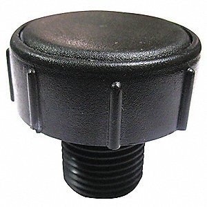

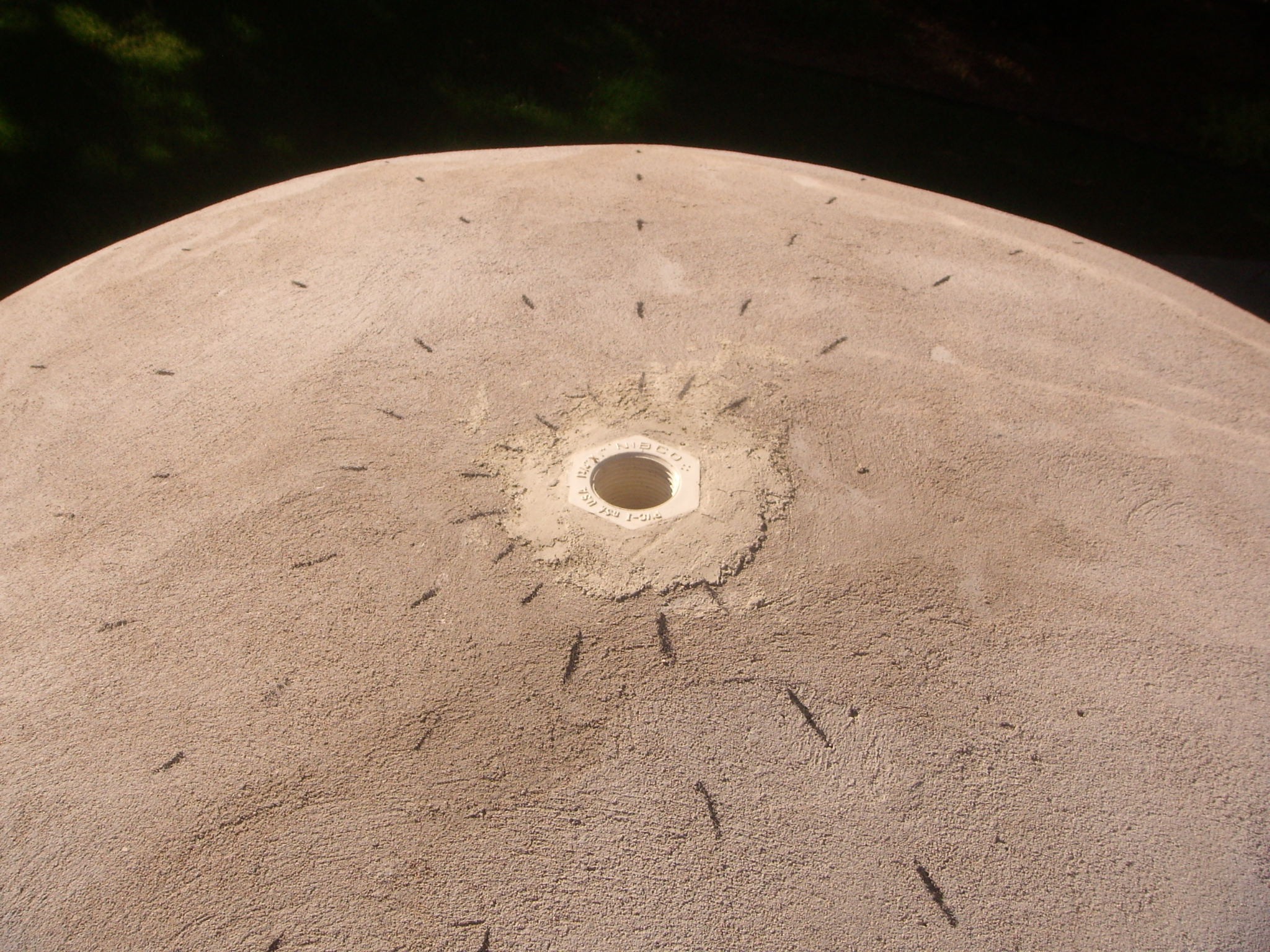

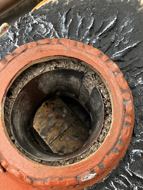

                    I used a homemade curved float and compressed the v/pcrete mix to assist in keeping the dome shape from slumping. Have you considered install a vent in the v/pcrete to allow steam from any water that may get into the dome? When water sublimates to steam, the volume increase by 1500 times and can cause internal dome pressure that can potentially crack the outer dome material.
                    Click image for larger version  Name:	83B Curved Trowel 4.26.13.JPG Views:	0 Size:	846.8 KB ID:	464753 Click image for larger version  Name:	87B Vent.JPG Views:	0 Size:	833.2 KB ID:	464754 Click image for larger version  Name:	breather vent.jpg Views:	0 Size:	25.9 KB ID:	464755
                      That's a nice solution. Your courses look very flat on the top? Did you compress it down by hand? I'm assuming you compressed mainly from the top? Or also towards the dome? Any idea of how much? Ie. one or two inches inwards or sth? Judging from the picture it also looks slightly wetter than mine.
                      I extended the mosaic tiles underneath the blanket and the vermicrete, thinking that that will be a good path for any pressure to escape around the whole circumference of the dome. Also from seeing pictures where the moisture/steam is actually being driven downwards due to the temperature gradient. I might still add a small U-shaped pipe on top, but with the channels in the mosaic tiles quite 'open' to gas pressure I'm pretty confident that no significant pressure could build up like that.

                        Steam will pass fairly readily through the blanket and a lean vermicrete mix, so I don’t believe an additional path is necessary. At 10:1 a lean vermicrete mix has approximately the same insulation value as blanket, with the weight of cement being a little more than the weight of vermicrete or perlite.(see attached table). This leaves the mix fairly open when set, negating the need for any steam channels. The mix sets up strong enough to act as a substrate onto which a cement render can be applied. If you do want it stronger, the addition of more cement will work, but also drastically reduce its insulation value as well as impeding steam passage. If the mix is made too wet it will wash the cement off the grains leading to an inconsistent mix. I’ve found 4 parts water to every 10 parts of vermiculite or perlite by volume, works well for the stuff I get, but it also depends of the grade of the grains. The finer the grade the more water is required. Another way is to add water to the dry mixed material until it just starts to pool in the bottom of the barrow.

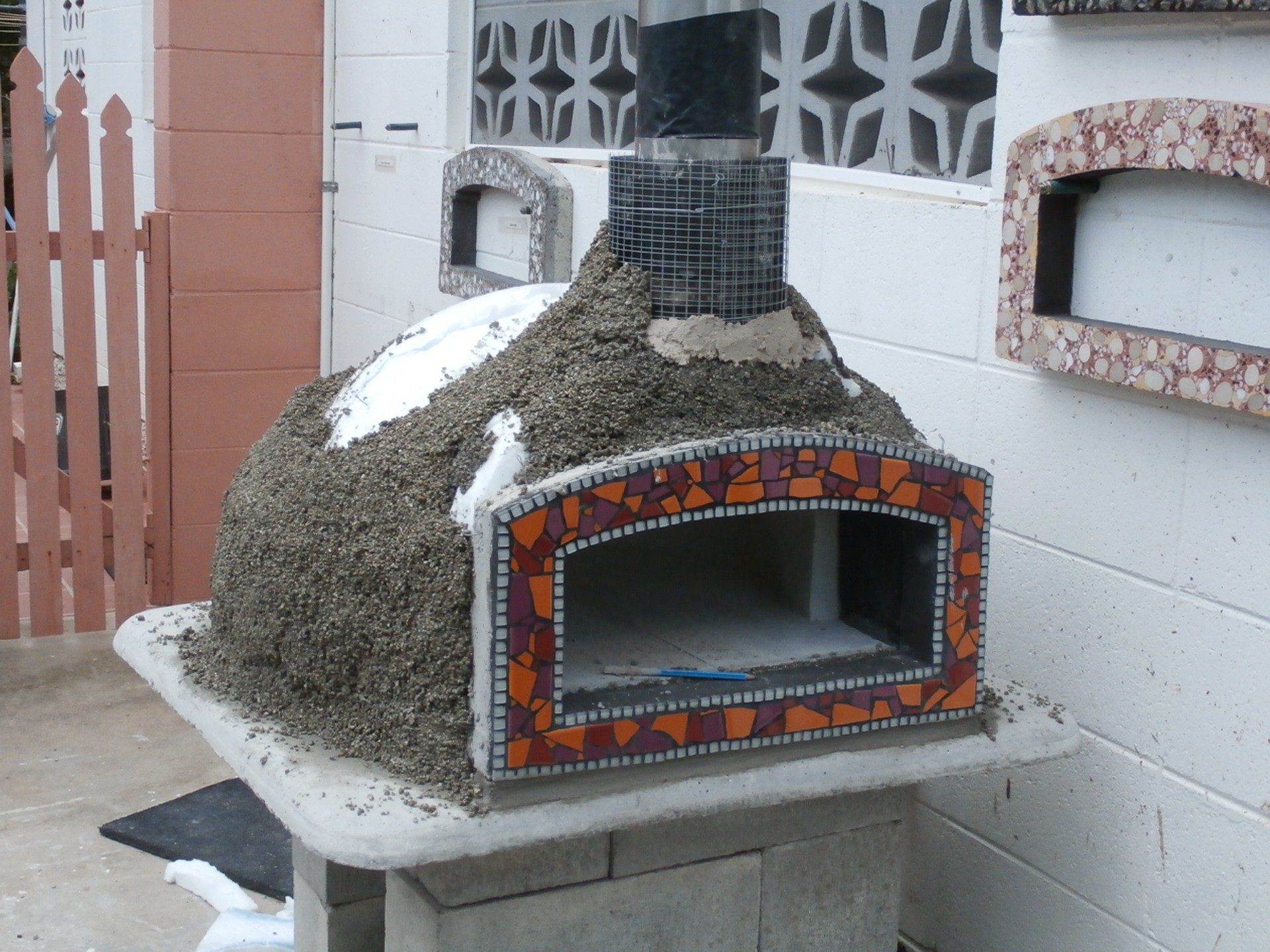

                              Well, two days spent well, but the vermicrete will be finished next Saturday... I didn't have enough 10:1 mix to fully close the dome. In the end that was ok, as for the final part I first had to figure the chimney out first anyway... Not sure if it's fully according to your design david s , please let me know. I wrapped the whole chimney and adapter part with two layers of chicken wire, and then filled it all in with 6:1 vermi/perlcrete. You also mentioned putting refractory castable, but I'm not really sure where I should put it? Do you only do a thin layer of vermicrete and then a thick layer of homebrew around it?
                              Please see the pictures.

                                Well, gambled that the 6:1 vermicrete would be sturdy enough with a layer of cement plaster on it to hold the chimney in place. So went ahead and finished it... now a week of damp curing and then finally time for curing fires.
