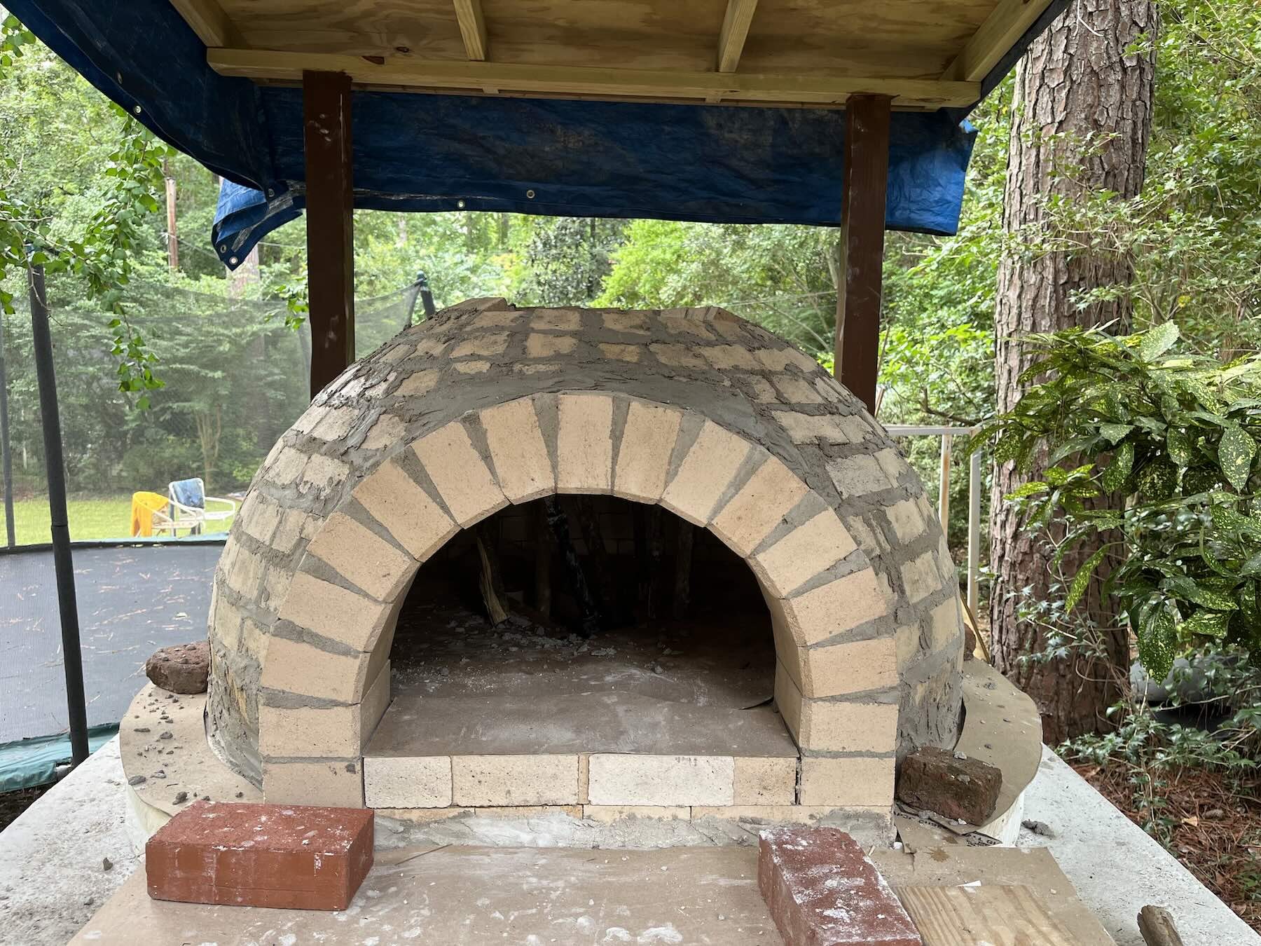

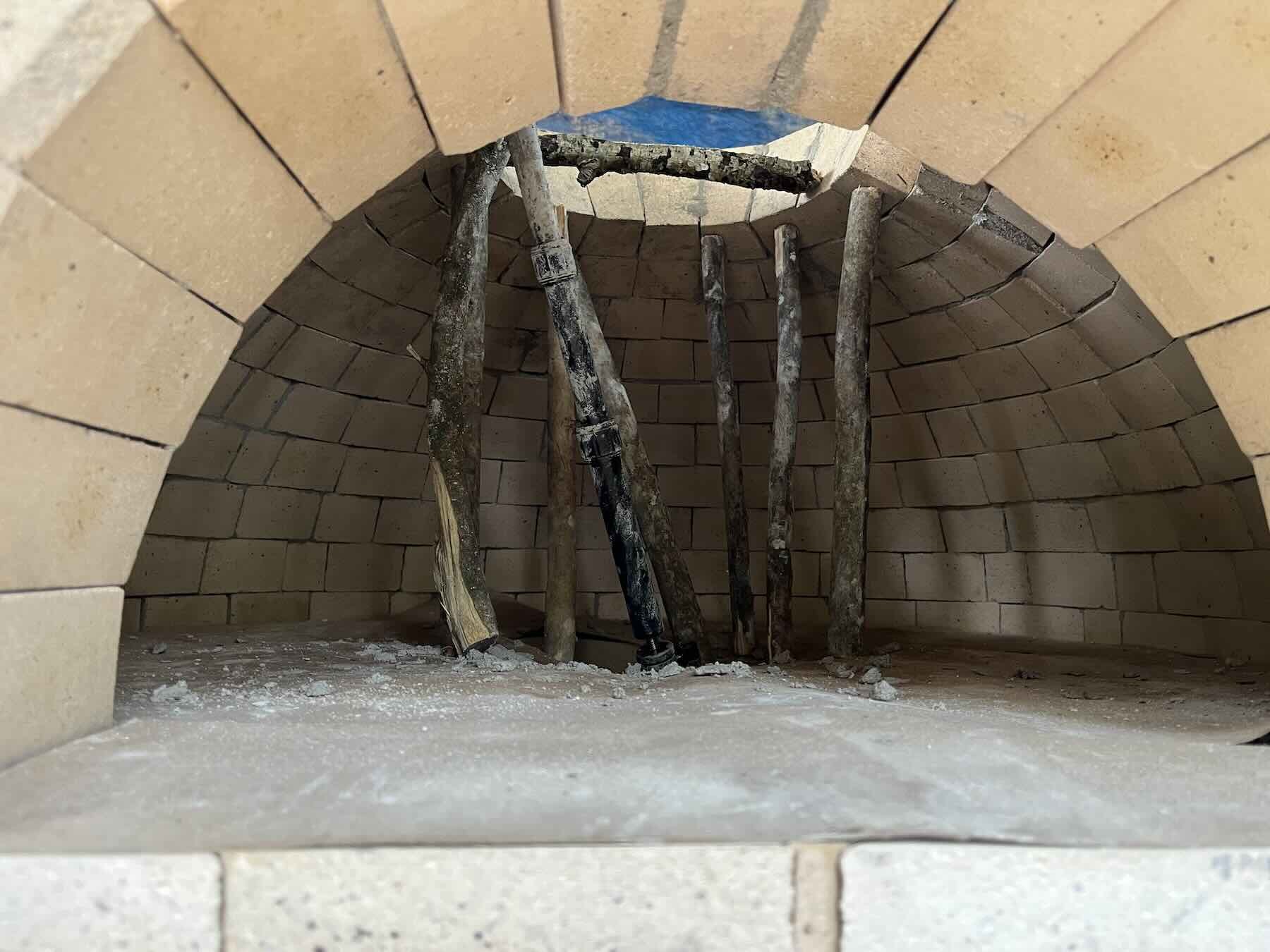

    Laid another 2+ courses. I'm definitely having to use sticks to hold bricks in place now. I also realized, belatedly, that the closer one gets to vertical, the less the taper should be. The first half of the current highest row is a bit over-tapered. It's not a real issue, but my bricklaying is definitely not winning any beauty prizes! :-) On the plus side, I do feel I'm slowly acquiring a feel for basic masonry.
    I estimate I have 3 1/2 courses left, plus the plug. I am close to reaching the limit of the bevel on my jig, but my saw can also tilt, so I'm going to experiment with that for the last few courses.
    I am quite pleased that my hearth slab is long and wide enough that I can walk on it all around the dome, which makes it easy to get in position to place the next brick. I am also happy to have a roof already in place, but it does mean I can't stand up straight, so my back gets quite sore after a while.

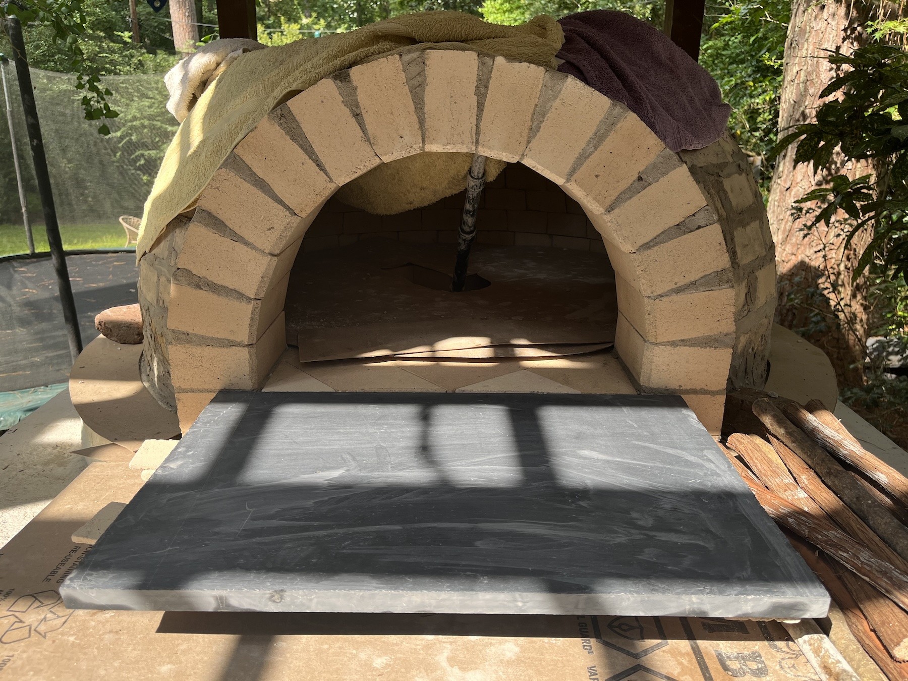

    I sawed down the pool table slate with my angle grinder. Took a bit of effort, but worked pretty well in the end. I cut off all the edges (which had holes for the pockets), then cut the front landing, which will cover the entire width of the hearth slab, and the vent landing, which is of course much narrower. I have a third piece remaining, which I will divide into two pieces to go on either side of the vent landing for additional work space.
