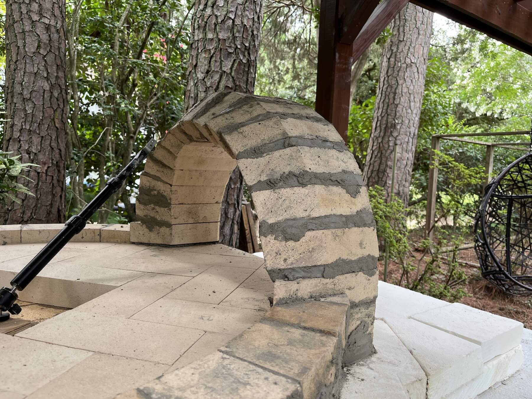

    Toiletman Yes, looking at your pictures I see how interlocking in that way can make sense. It may be easier to do when the entry walls go up straight for the first few courses, as in your build.
    Ironically, I had decided that interlocking with the dome courses might weaken the arch's own structural strength, but I think you're right that it would strengthen the connection between the arch and the rest of the dome. In the end it's probably "lood om oud ijzer" :-)

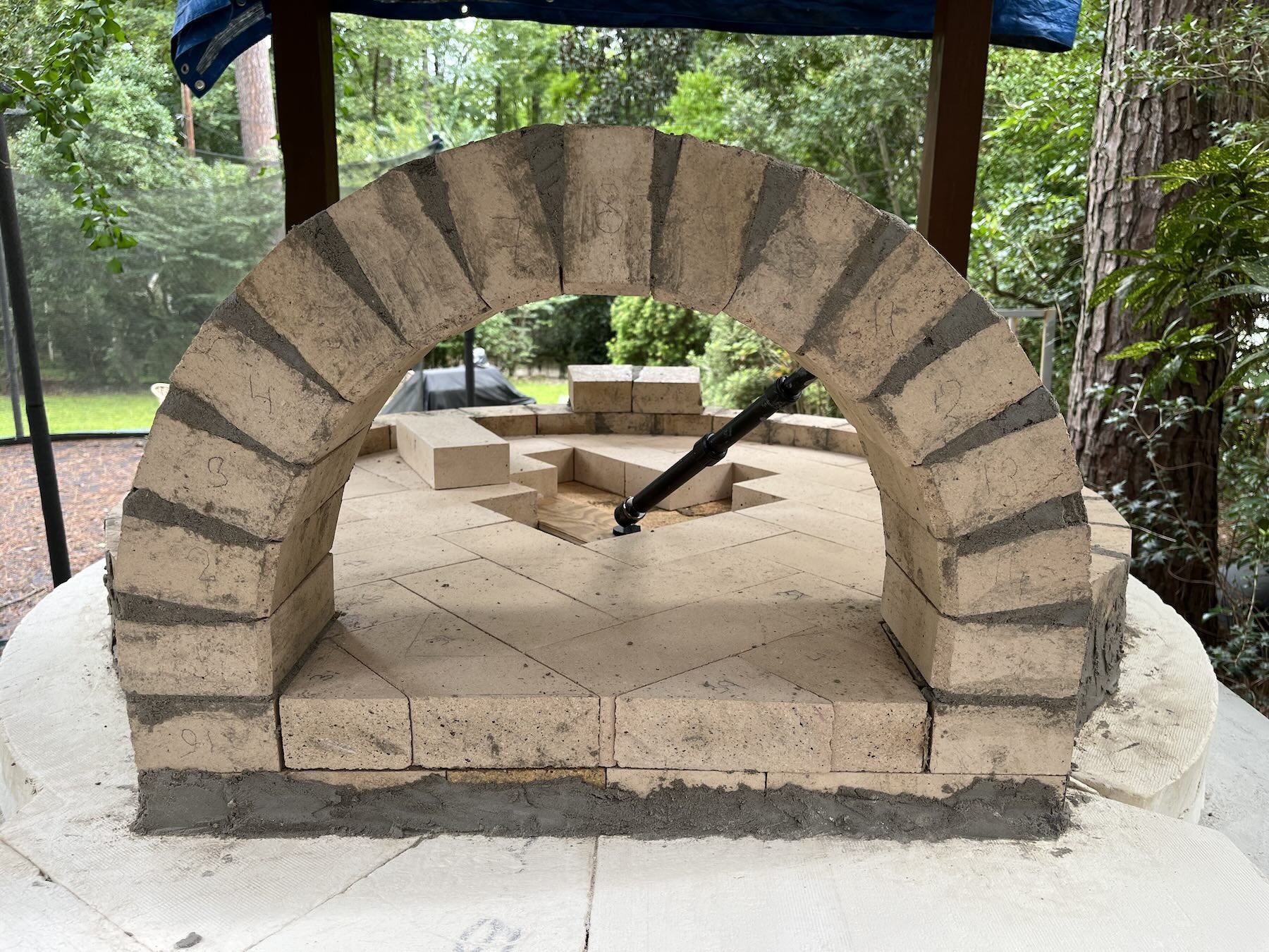

  • Toiletman
    replied
    Originally posted by nlinva View Post
    Yesterday I did the first mortaring, using the 3:1:1:1 homebrew formula.
    It's definitely a learning process. The first batch of mortar was a little too wet; some bricks were a little too wet, some a little too dry, etc. But I think I'm getting the hang of it (fingers crossed!). Despite the heat (around 90F), the mortar remained quite workable for as long as I needed -- possibly because it's so humid here right now. It probably helped that I used chilled water to mix it, as recommended in several places on the forum.
    I put in the first two courses, one thin, one normal-size, plus the inner arch. I ended up having to taper the bricks on either side of the TDC brick a little bit, but other than that everything seems to have gone smoothly. Today I removed the form (very glad I had raised it on some shims, because otherwise it would've definitely been stuck!).
    I had a little mortar left over, so I put in the first 2 bricks of the next course, which will be the first to curve inwards. I'm thinking I'll need to build a jig to standardize the taper/bezel. I thought I might be able to do it by eyeballing, but I think a jig of some sort will be more efficient.

    Wow, ambitious to start with the arch! But great progress!
    For my arch I opted to cut each stone to width towards the dome while laying the courses such that the arch bricks would also interlock with the dome courses for added structural strength. But I guess you are past that station now. Don't think it really matters.
