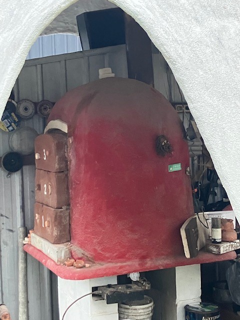

                      As you have around 25 bricks plus a fair amount of mortar to join them all, you have a lot of thermal mass there in the gallery. Separating it from the dome does reduce some heat transfer by conduction, but it won't see temperatures and the resulting thermal expansion which approaches that of the dome. The evidence of this is that the black soot doesn't burn away in the gallery.
                      I'm really not sure whether mortar or high temp silicone would be the better solution to join your outer decorative arch, because my approach detailed below is quite different. If choosing mortar I think you'd be better using homebrew, but cut the clay content back because it promotes shrinkage cracking. I now always use 3:1:1:0.5 for this reason.
                      Adding a decorative arch will further increase the depth of your gallery, making the oven more difficult to work.
                      I have approached this problem from the other direction. My gallery is very shallow (13cm/5"), set back a little over the oven mouth and supporting a 5" flue made from fibre reinforced dense castable but quite thin resulting in only 10 Kg in weight. Because the light weight does not present a heat sink problem it is mortared directly to the dome and my expansion joint/conduction break sits between the outer decorative arch which is then integrated into the outer rendered shell. Adding this to the gallery depth as well as mortar joints results in a depth of 19cm/7.5" which gives me great access and the facility to use short handled (50cm) tools.

                        Thanks for the feedback, david s ! I was thinking of the issue primarily in terms of heat loss (hence the thoughts about insulation), but it is useful to also think of it in terms of a heat sink (not that those two things are unrelated of course). Not sure yet whether that should change my preferences, but definitely an important additional angle to keep in mind!
                        Thanks also for the suggestion for the modified homebrew mix to use!
                        The decorative arch is set back by the 2" reveal, and it is only a bit over 2" deep. I tried it out with different implements, and there is no real way for this to make the gallery feel deeper unless there is some tool with a broad handle that is right near the vent arch-decorative arch transition. So on that front I'm not really worried.
                        I take your point about the different approach doing castable, allowing a much lighter (and thus less of a heat sink) chimney transition. That being said, would it not be a proportional issue? In other words, is your gallery/chimney lighter _as a proportion_ of the dome weight than mine is? The greater total weight will obviously matter for time to heat up, but if the proportional difference is about the same, the heat sink issue should also be about the same, right?
