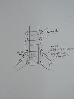

                  Question for the experts: What is the best way to handle the bottom of the anchor plate? As you can see on the attached picture, there is a little bit of space between it and the surrounding bricks. My plan has been to seal that with the red high temp silicone caulk, but the gap is narrow enough that maybe leaving it alone is fine too.

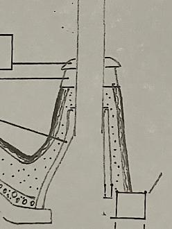

                    You haven't detailed how you have secured the anchor plate to the bricks of the gallery. If drilling holes and using fixings, this is the first problem, because drilling the bricks is inviting cracking there. Additionally any fixings are going to expand in the holes exacerbating the issue. If anything bar stainless is used they are highly likely to corrode. Ultimately it's all hidden so once in place it probably doesn't matter that much. If you plan on filling the gap under the plate with high temp silicone I think you will find it will fail, especially if you allow your wife to tend the fire and she allows decent flames up the flue. Some homebrew squished in there would be my preference. Because of all these problems coupled with the ridiculous expense of anchor plates, I don't use them. but use a different idea (pics)

                    • Sorry, I didn't make my question clear.
                      I did not use any tapcons or similar. The flat part of the anchor plate is attached to the flat bricks on which it rests with Rutland gasket cement. It may fail, but I'm not sure how crucial it is anyway, because the plate has a circular part below the flat plate that goes down about 1.5" and that will hold it in place in terms of lateral movement.
                      I ground the surrounding firebricks to fit around that, and there is some space around it to allow for expansion. That means at the very bottom there is a bit of space between the plate and the bricks, maybe about 1/8" on average. I can seal that with silicone, or I can just let it be. What do people think?
