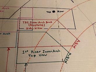

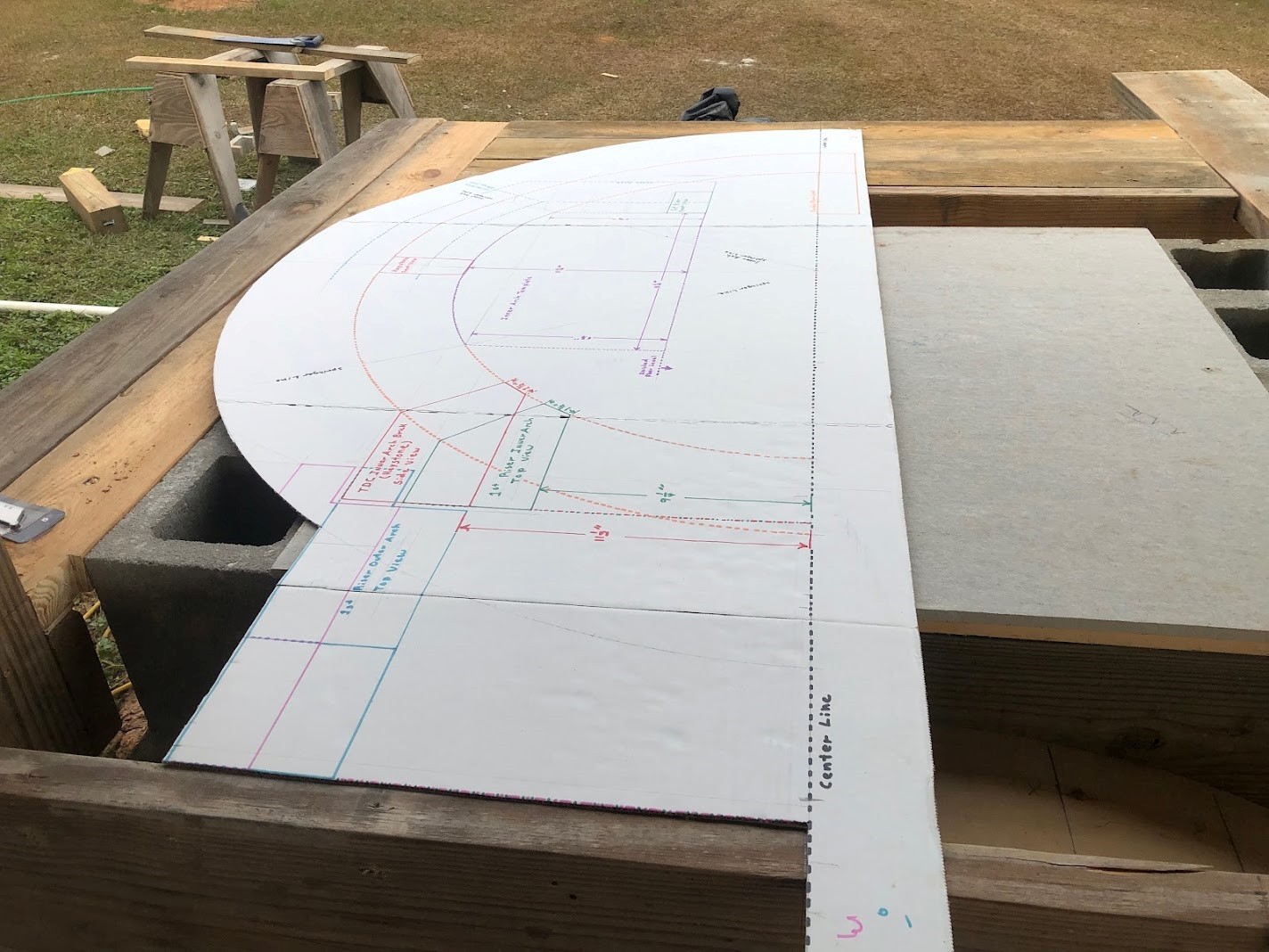

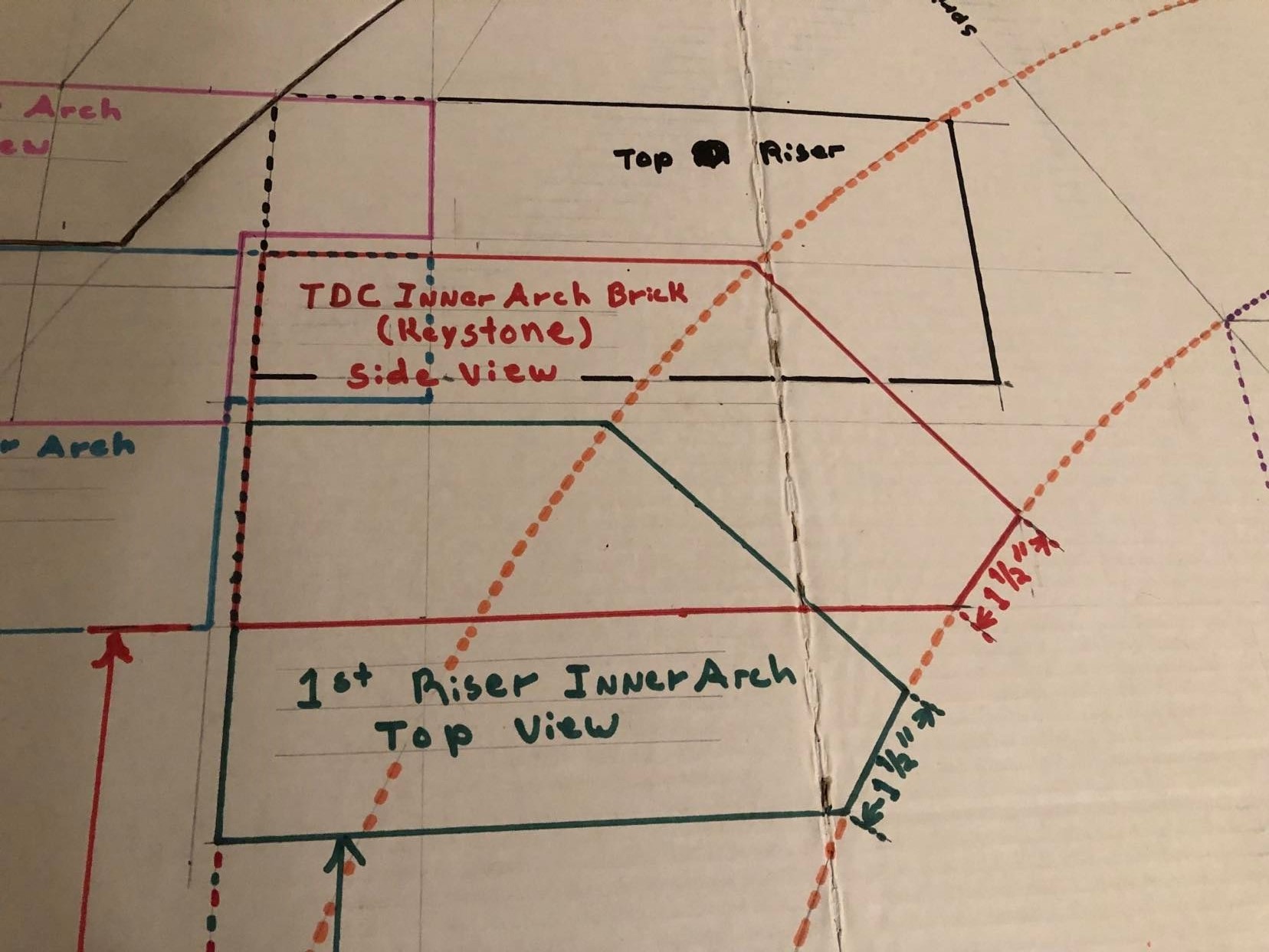

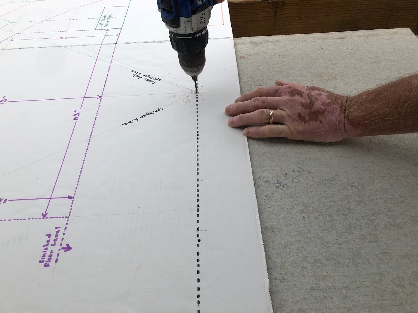

                      Our oven sizes are small enough to draw in full scale. It's "old school" but the drawing can also be used as a template in the real world. No program to purchase. The cost of a school project board, a yardstick, and a push pin is minimal

                        CAD = Cardboard And Drawing
                        • #13
                          Plus one on JR and Gulf. Even though I am a retired Engineer and had full access to AutoCad I opted to go Old School like Gulf. Much easier to visualized the oven on the hearth in person.
