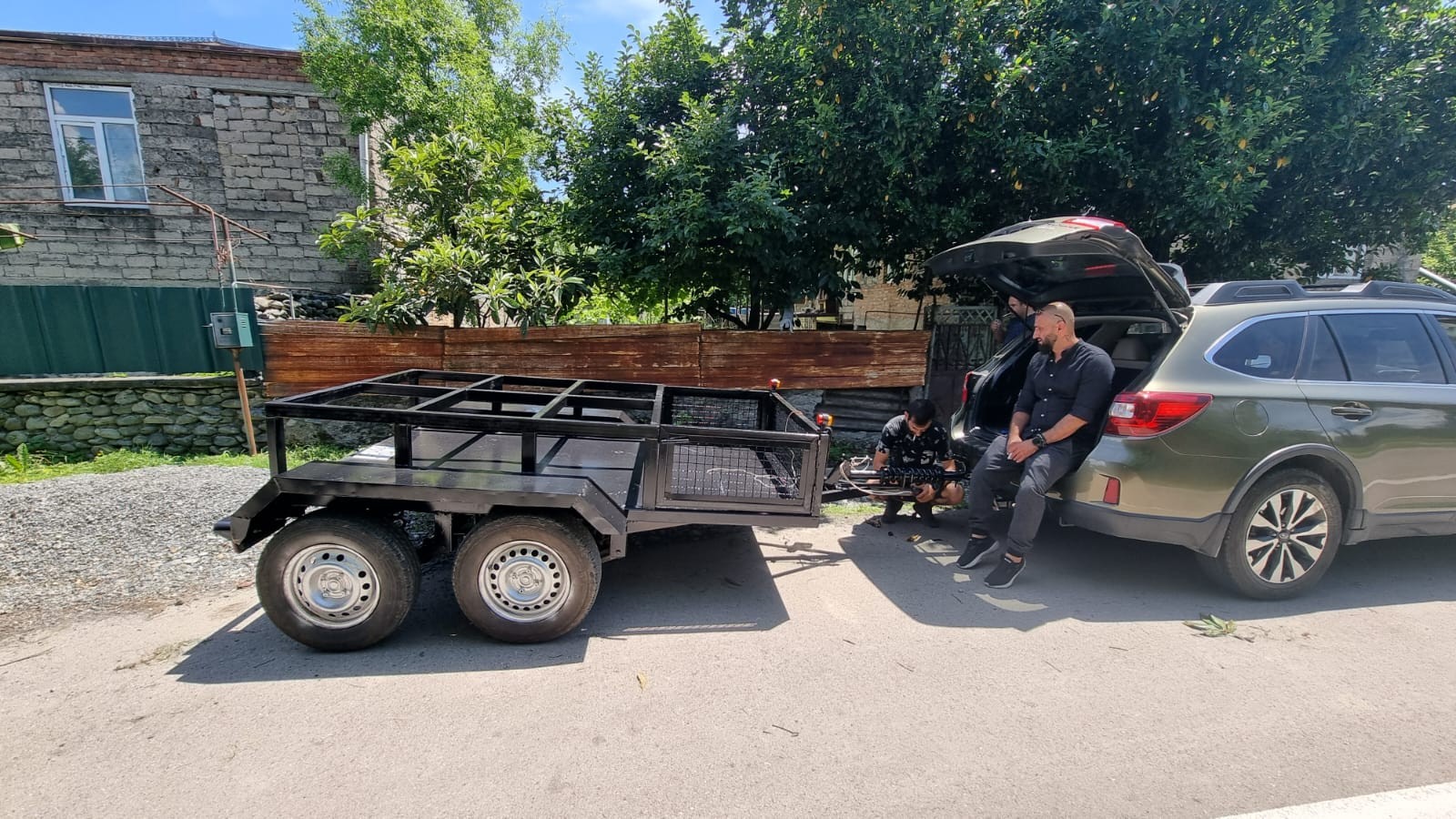

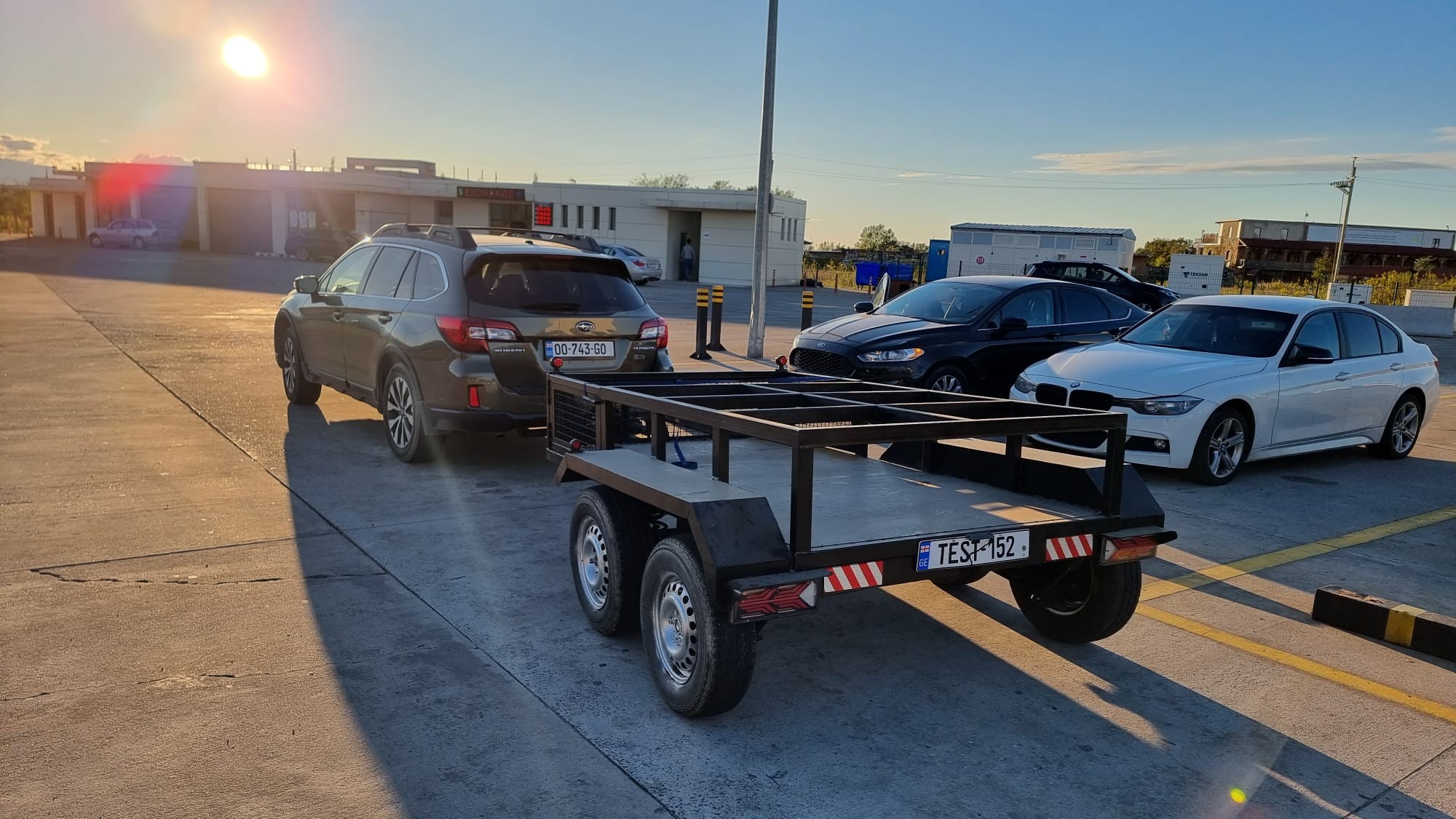

          the next step is planning the details of the oven. my table size is 150x170cm of the trailor - so I hope to come up with a good design.

            Meanwhile a question has arised:
            - My trailor dimensions are 150cm wide, 170cm long (as a maximum)
            - I'm planning to have maximum insulation, that means for sure 10cm. With perlite towards 15cm (I dont know how much Ceramic Planket I have left)
            - For the floor I will have 6cm - the same what I have used in the past: Fire-Bricks. (not 8cm)
            -> how thick should I mortar the oven? also around 6cm?
            I mean I want a solid stability, but of course not too much mass which makes the oven heat up too slowly. Also if the trailor is not ridiculously heavy I would also be happy. But it should of course be suitable for festival production. What's a good balance?
            And another question which came up is: Usually the door is 63% of th dome hight. Is there a "golden way" for lower domes as well, or does the same apply?

                My trailer is of a similar size (1.46 X 1.75 m internal dimensions) with a single axle. So, I presume yours is also a single axle. Apart from the weight that has to be supported by the axle, the load on the drawbar is also more important for a single axle trailer than on a dual one. Also for safety, there is a danger of the load, which has its centre of gravity well above the axle, creating an accident causing the drawbar to elevate violently. To overcome this problem and to be able to adjust the balance point over the axle, I made a trolley that the oven sits in, held in place in the trailer with chains and turnbuckles allowing fine adjustment to the balance over the axle. This also allows me to roll the whole oven off the trailer, onto a steel stand and use the trailer for other purposes.

                  My trailor has two axles, see above in the first post. The high center of gravity made me do this - also the ability to move it around. Good point, the springs I might need to adjust later.
                  What a cool feature to slide it off the trailor. I'll consider that too! I def. had a construction in mind to take it off - but putting some wheel bearings and a rail makes alot of sense.
                  I wonder: when the oven is off the trailor, the trailer will be higher due to no weight..how can I overcome that problem?

                    All good. The pics of the trailer didn’t work when I originally looked. It looks quite suitable. If it’s of any use to you, my mobile oven weighs 250 kgs, but only 540 mm internal diameter. Your double axle trailer should easily handle a much heavier load.
                    Do make it with a removable flue so it doesn't flap around in transit.

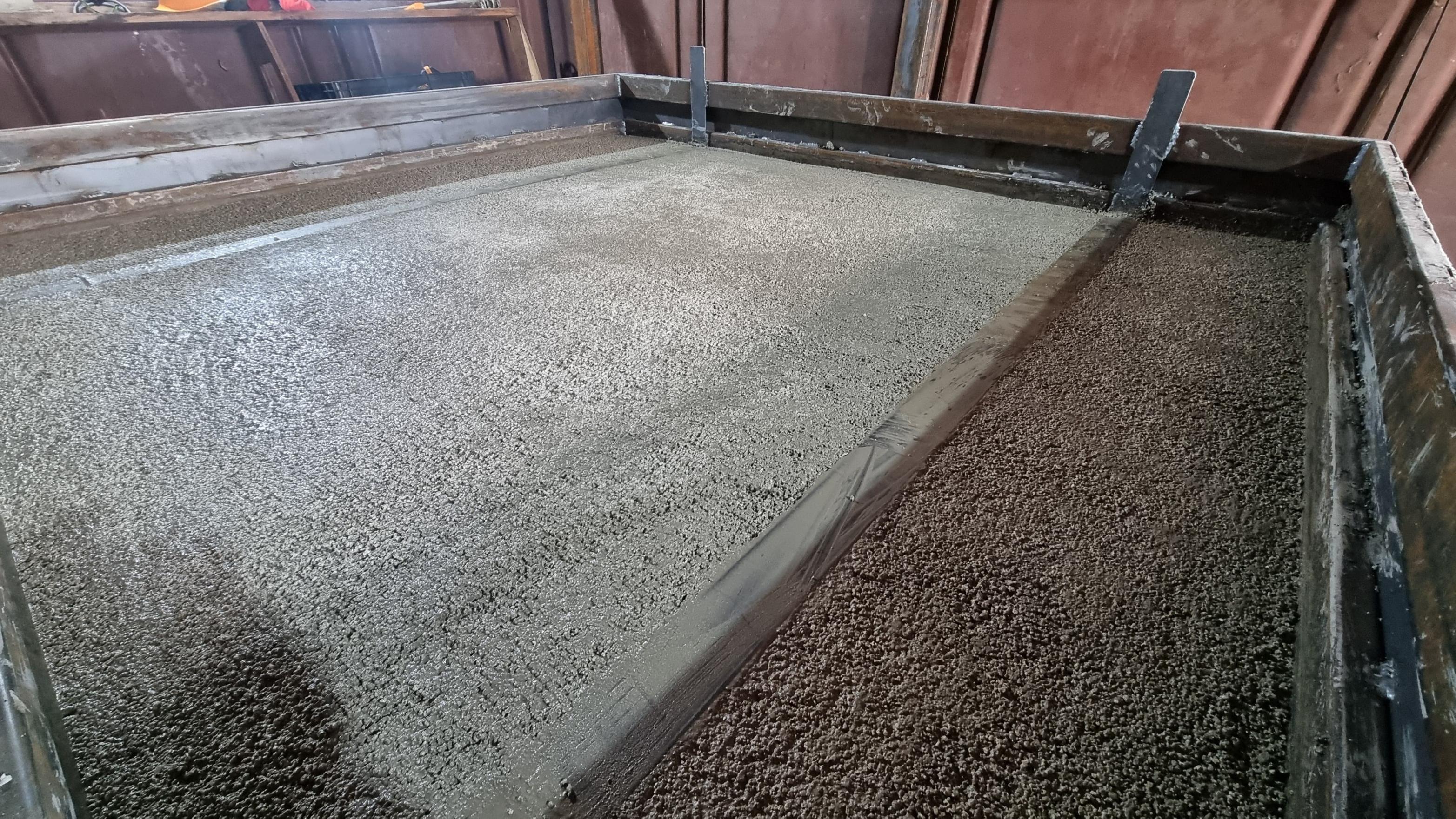

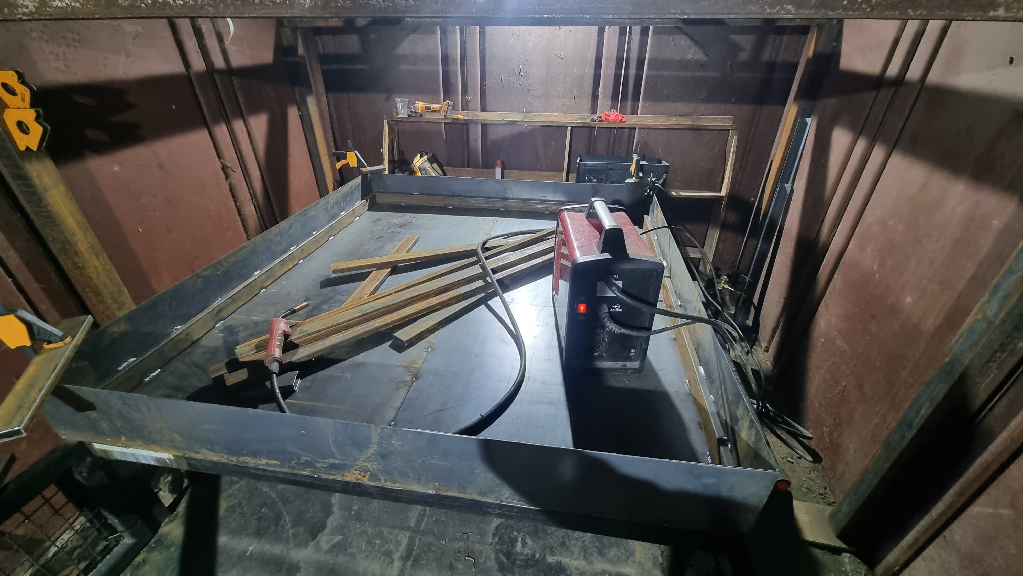

                    • #11
                      Slowly things are moving..
                      Below some impressions of what I did in the past weeks.
                      I bought a garage to have a decent location for the oven,

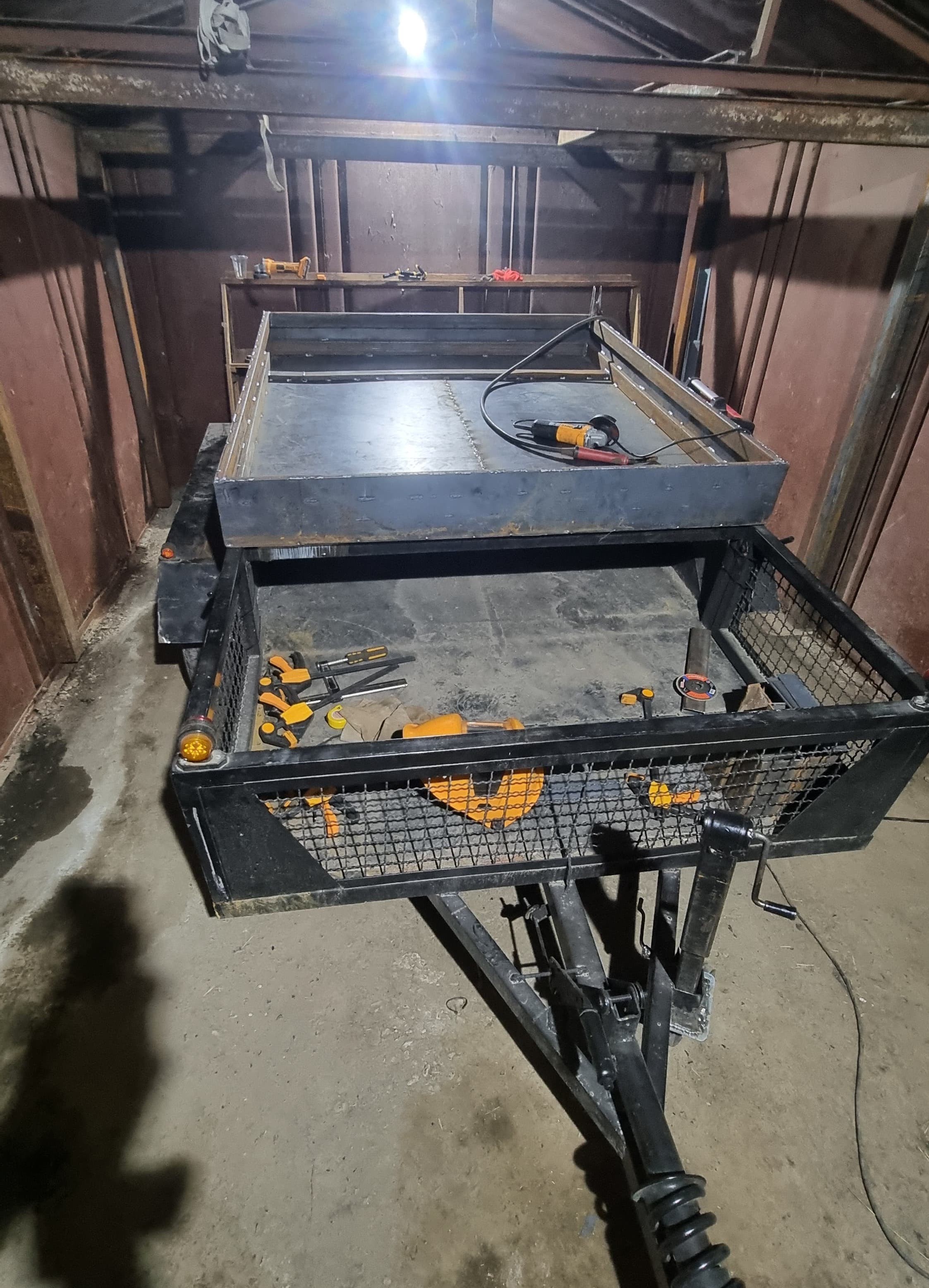

                      I welded the "pan" of the oven, its a 2mm sheet with a 2x6cm metal tube wich I used to give it additional stability. I have also added 4 points to later lift the oven.
                      The 2cm on the bottom I then covered with a 6:1 Vermiciulite - Concrete to even things out.

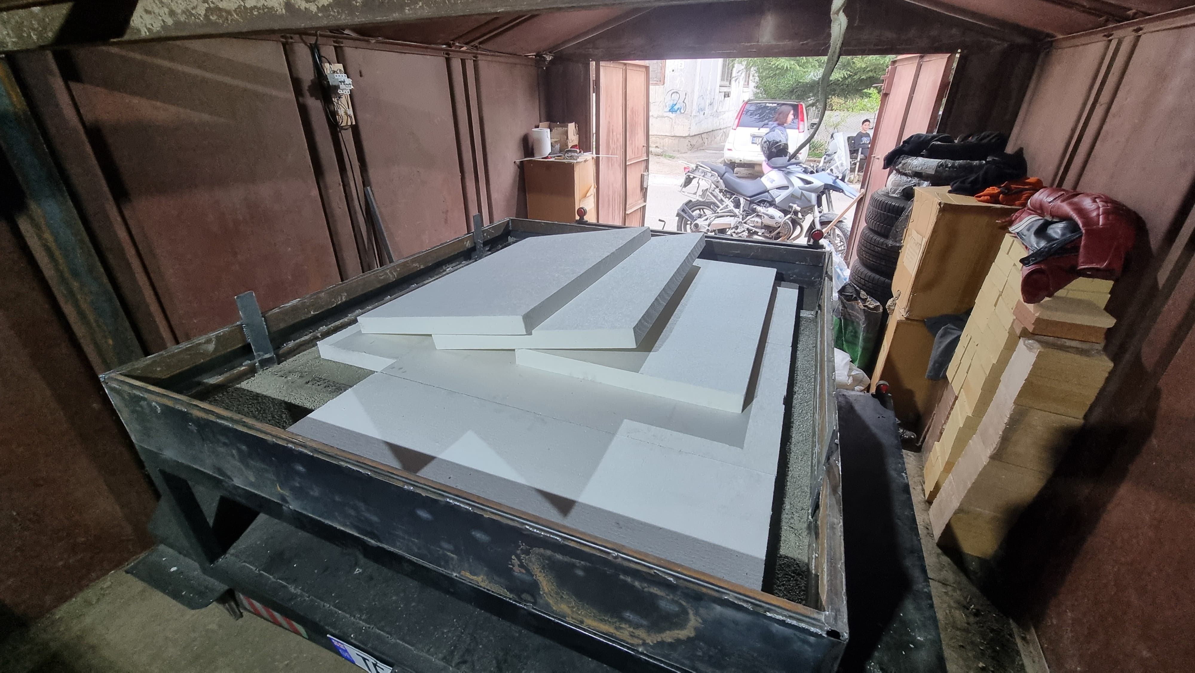

                      Now I'm adding 10cm of fibreboard.
                      After that I will put two layers of 3cm thick firebricks (20x20cm). Instead of the usual 6cm bricks. I believe the bigger but thinner ones might be better for potential fibrations on the road? Any thoughts on that?
                      stay tuned
                      Best,
                      Marvin
