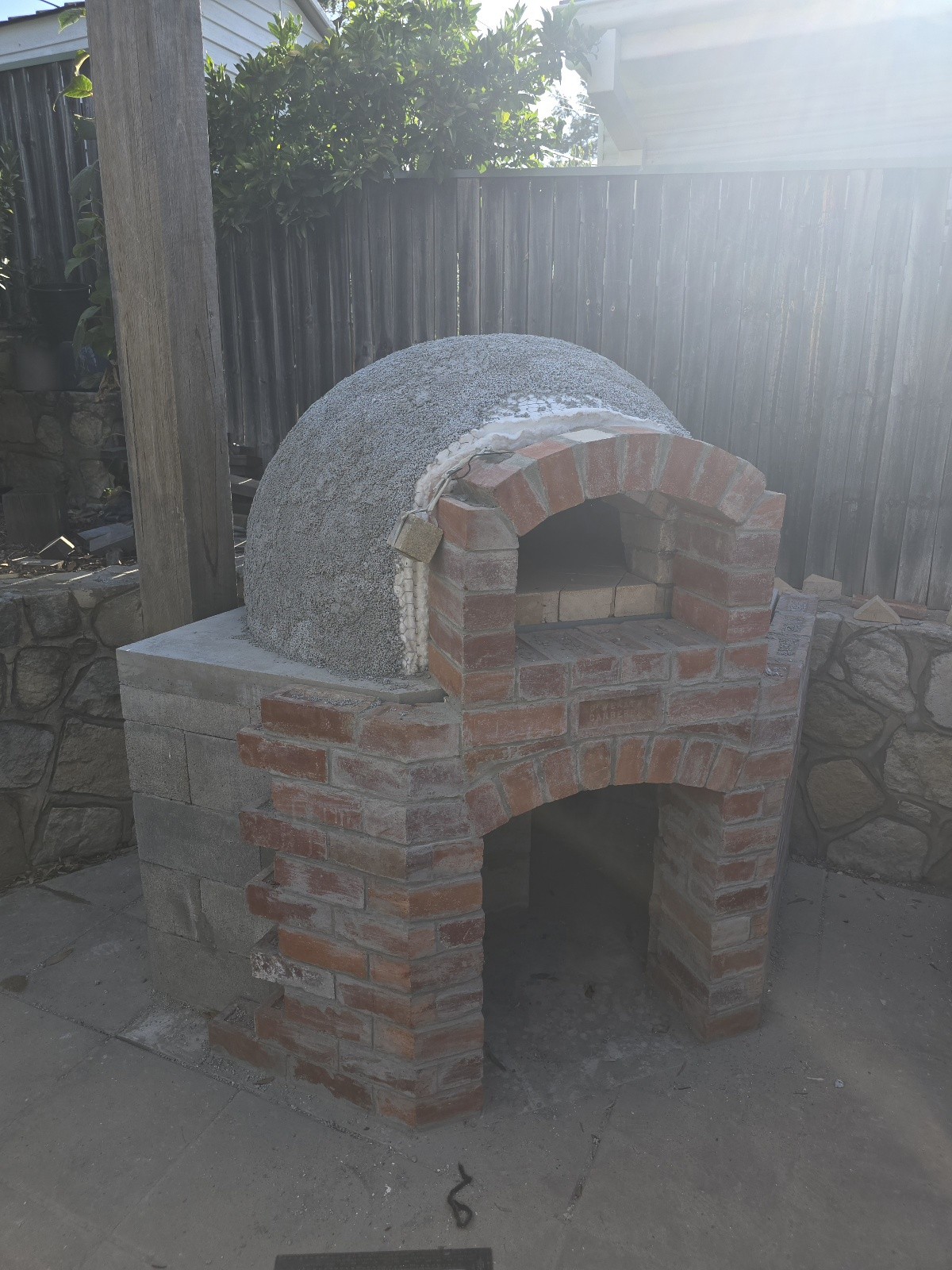

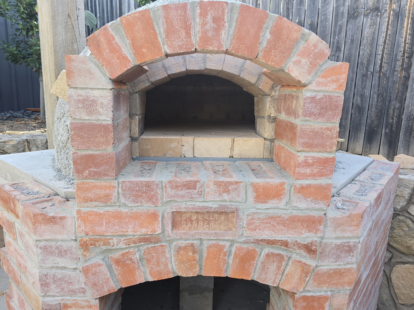

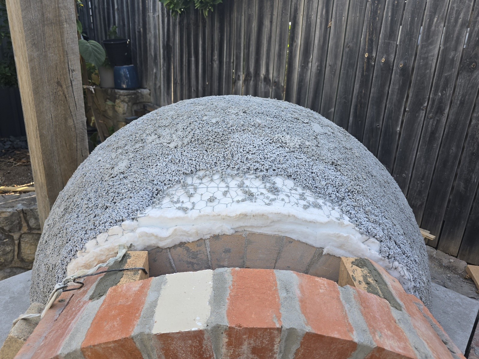

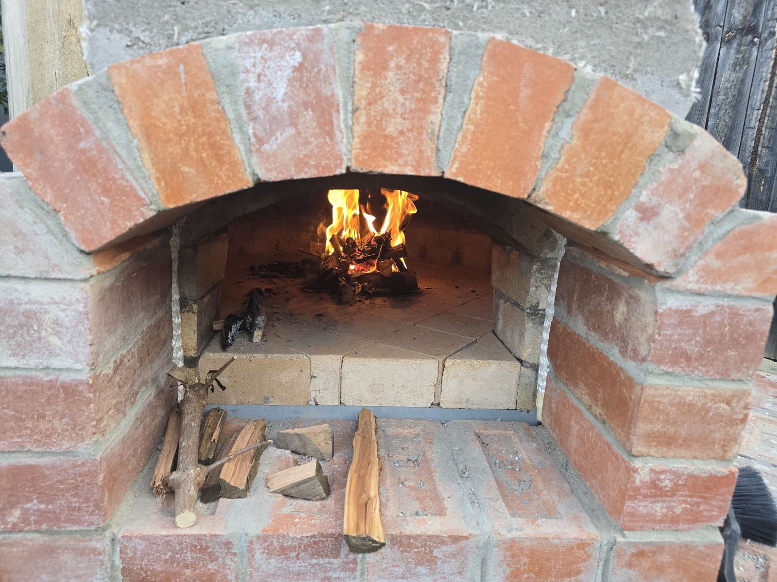

    Update:
    Completed the brickwork for the outer arch.
    Also fixed up the inconsistent thickness of perlite.
    I left a 20mm gap between the inner and outer arches for the door. There's going to be a landing slab placed on the bottom row of brick.
    There's also a 25mm thermal break between the inner and outer arches, which I will fill with heat-resistant rope.​
    Click image for larger version  Name:	20260110_180021.jpg Views:	0 Size:	762.8 KB ID:	469115
    Put a wedge of brick to straighten the path of exhaust and support the vent
    Click image for larger version  Name:	20260110_180026.jpg Views:	0 Size:	676.6 KB ID:	469116
    Click image for larger version  Name:	20260110_180003.jpg Views:	0 Size:	456.6 KB ID:	469114

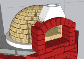

      Vent Design Questions:
      Hey guys, time to design the vent and I am in need of assistance.
      The vent construction is going to sit on top of the inner and outer arches. My idea is to stuff leftover pieces of CaSi in the thermal break (cut into L shapes so it fits not only the thermal break but sit between the vent construction and inner arch) to define the flue opening.
      The arches were designed this way because the outer arch is normal brick (kilned) not firebrick. Insulating the vent as much as possible from the inner arch minimises heat leakage to the outer arch.

      Sample Sketchup:
      Click image for larger version  Name:	Screenshot 2026-01-17 233020.png Views:	0 Size:	56.7 KB ID:	469119

        I think your solution is pretty sound, but it may lead to exposed cal sil at the sides of the entry and the stuff is not particularly strong so would be susceptible to knocks and abrasions there. Casting the vent transition is way easier than building that kind of form in brick. It also allows for a big reduction in weight and therefore heat sink.
        i’ve found the 3:1:1:1 recipe leads to excessive shrinkage (you don’t want shrinkage cracks), from the high clay portion so I halve it, with much better results. 3:1:1:0.5, but you will need to add the very fine polypropylene burn out fibres for steam spalling protection. A casting thickness of one inch should be sufficient.

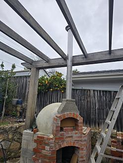

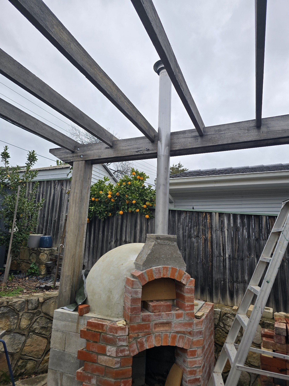

                • #23

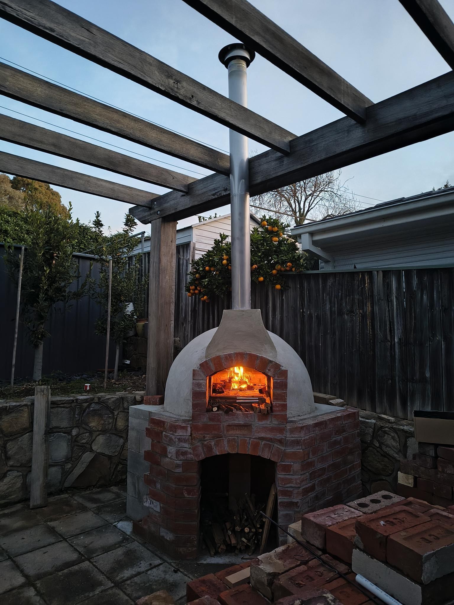

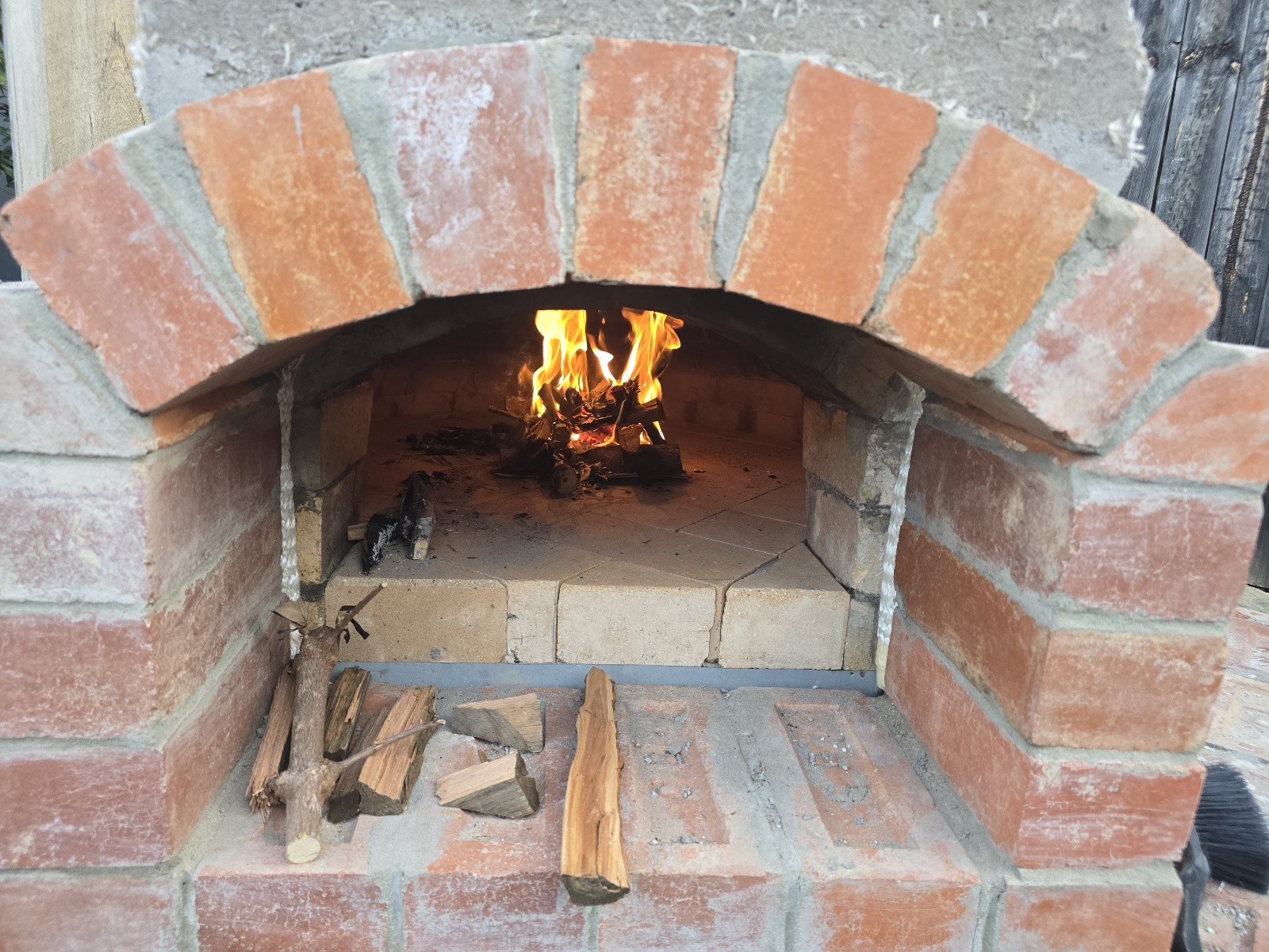

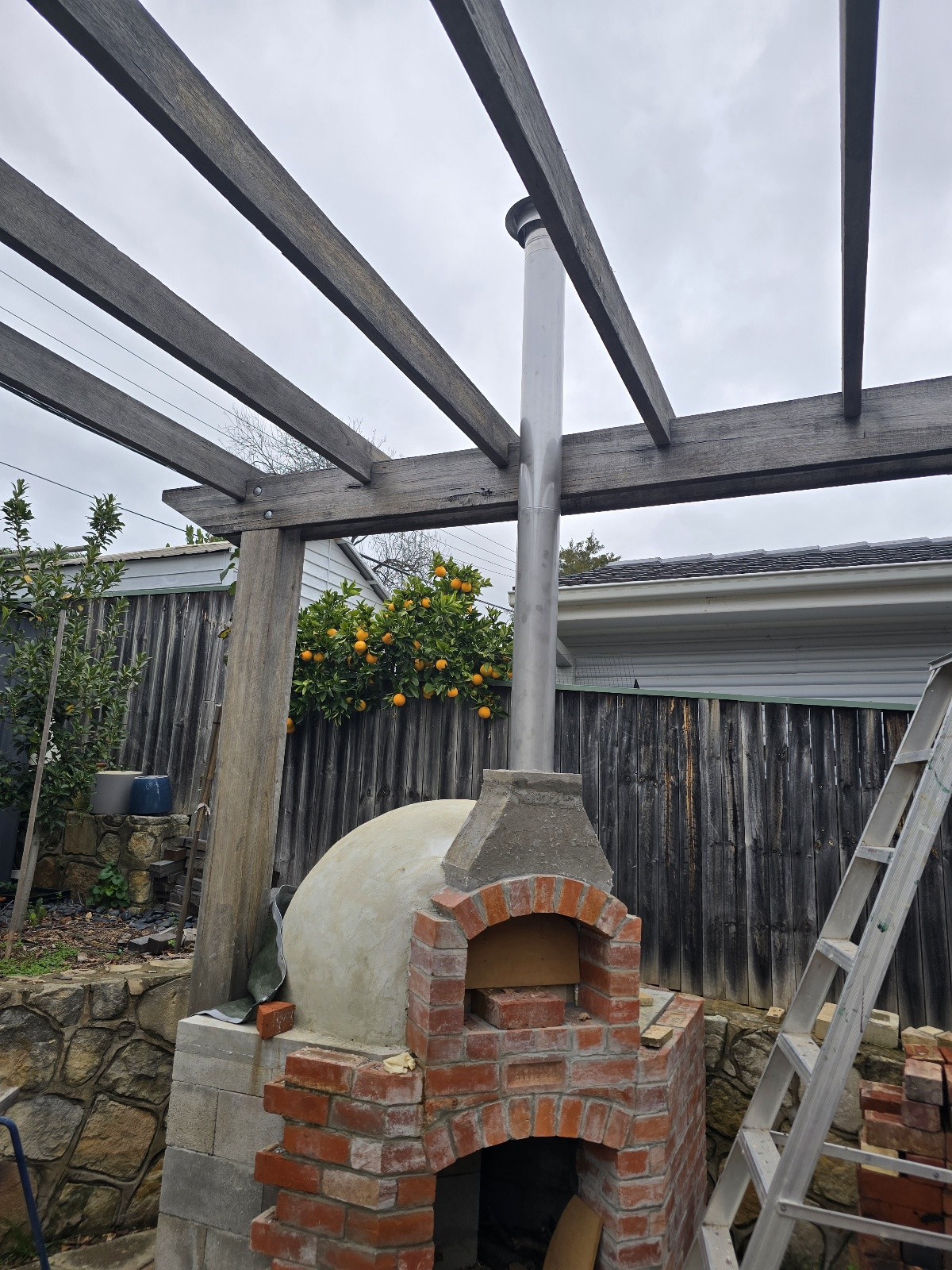

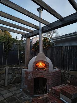

                  Cast the flue. Ended up running out of burnout fibres. I didn't know how to work with the stuff and I'm pretty sure I didn't distribute it evenly enough, buit whatever.
                  Attached the flue and the chimney. I was in two minds about whether to insulate the flue, and decided to do it anyway, as it would make it easier to finish. I wasn't sure whether render can withstand high temperatures
                  Also rendered the outside of the dome.
                  I think all but the cosmetic parts are done, and onto the curing fires!

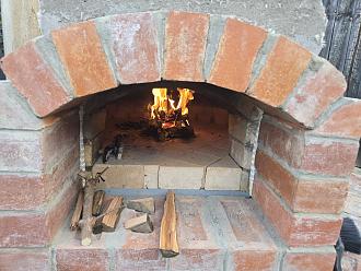

                  • #24

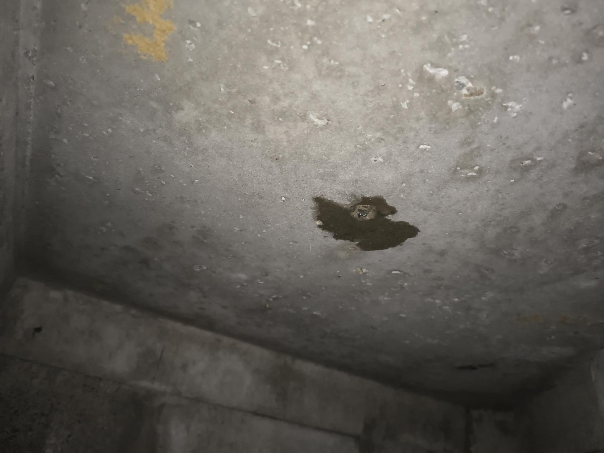

                    I'm up to the 4th set of curing fires, and I am noticing quite a bit of heat leakage through the bottom.
                    Remember that I have 3 layers of CaSi that is raised from the slab using tiles, and weep holes drilled into the slab.
                    On the 4th firing, I noticed that the underside of the slab was registering 30C, and it was a cold evening where the outside temperature was 10C. There's no heat leakage at all through the dome.
                    The top of the dome reached 400C. Yet the floor temperature was very uneven, even after a long period of firing, reaching only 250C at the hottest part.
                    I noticed that water was dripping out one of the weep holes.
                    I can't explain what's causing the water ingress. If water is leaking in from the outside somehow, that itself is not a big issue because the CaSi layer is suspended. I can't tell whether the CaSi layer itself is wet. I can't see how water could ingress and make its way up to the insulation layer, but the temperature leakage and hearth temperature suggests that moisture is a likely reason.
                    Also, it has been a few months where the oven has been air drying, so refractory materials/cement should be fairly dry.
                    Any ideas on how I can diagnose and rectify this issue?
                    Water dripping from weep hole in question:
                    Click image for larger version  Name:	shared image (1).jpg Views:	0 Size:	262.2 KB ID:	471269

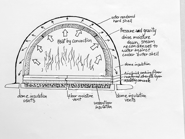

                      It will be the water added in excess to that converted during the hydration process.during the build. Eg water taken up when soaking bricks, water in the mortar, water in the vermicrete layer etc. do a rough calculation and you’ll realise there’s a lot. It may look and feel dry, but just as a pile of damp sand will dry on the surface an inch or so deeper will remain damp for many months because it's covered by the sand on top of it therefore the moisture is locked in.and as one litre of water creates over 1500 litres of steam, just as potters know, when pottery looks dry on the outside there’s still moisture in the middle of the walls of the pots and the bisque firing must proceed very slowly until the first 400C is reached.(steam spalling usually occurs at around 250C)
                      The visible water at the weep holes is proof of the presence of water exiting. The other indicator is how hot it feels to the hand because water or steam is far more conductive than air. Just take it slow. As you’ve documented there’s a huge difference in the temperature of the top of the dome and the floor (as well as the base of the dome, you’ll find), which means a huge difference in thermal expansion of those parts. This sets up huge stress. It is also far easier for the moisture to escape if the drying fires are done after insulating, but before final render, because that helps contain the moisture rather than allowing it to escape easily. Lucky you provided the weep holes.
                      PS you're local fire dept. would not like the look of your (presumably single) flue pipe siting against the timber of your roof.
                      Click image for larger version  Name:	IMG_2310.jpg Views:	0 Size:	78.1 KB ID:	471271
                      • #26
                        thanks for the illustration. helps a lot!

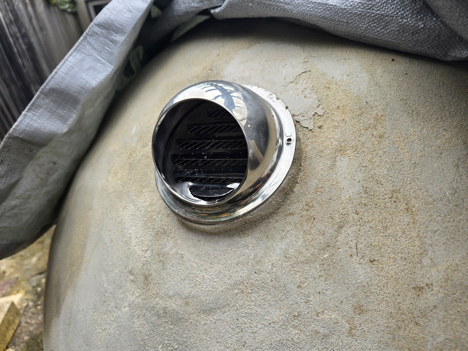

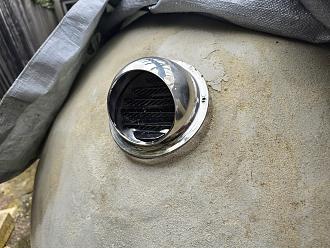

                        I did put in a vent into the dome, which will help relieve moisture build-up. By your illustration, i could also drill some weep holes directly underneath the dome walls.
                        Ah yes. I decided that this option is better than a short chimney venting onto the timber joists. I can install an elbow if necessary.
