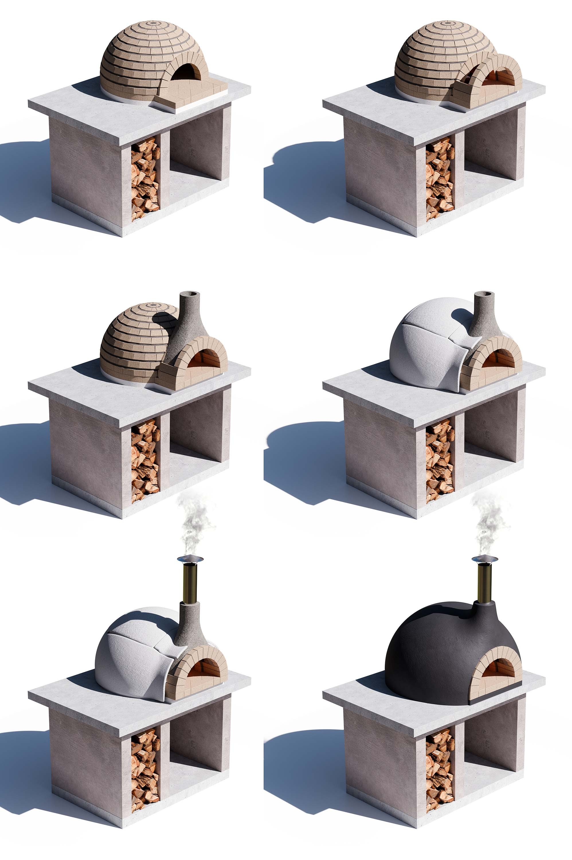

    So a 100x100cm outside size pizza oven with an internal size of 85cm x 70cm. For me the right size considering my garden plan. I would then build the plateau/stand myself, and just buy the pizza oven.
    Then circumstances changed a little bit, so I thought let's do it myself. And without research thought I would make something like the above link. Now after some research and found out, that the way this oven is constructed is not the best, with the air vent/pipe behind the door entrance. I found out especially after seeing this image on the Forno Bravo website and reading all the info:

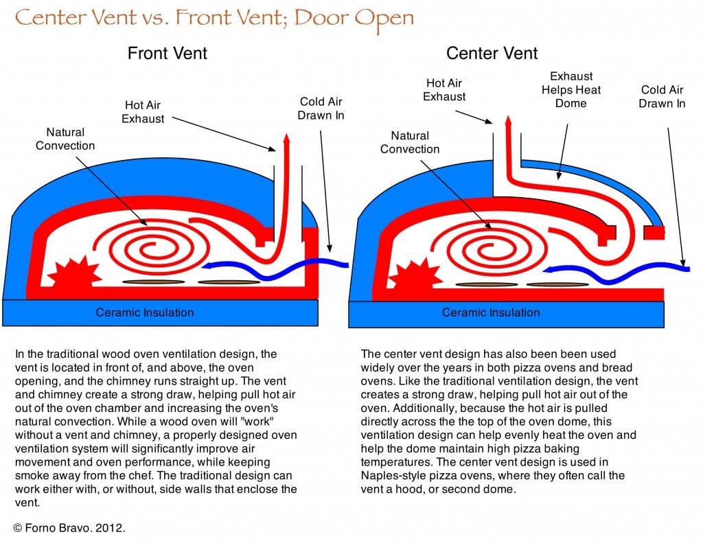

    Click image for larger version  Name:	center_vent_open1-1024x798.jpg Views:	0 Size:	182.5 KB ID:	469051
    Am I right to think the oven in the link above is not the right way to go, or maybe not worth all the time it takes to build a pizza oven to end up with something just not right?
    I am continuing my research on this site, and look at all the incredible builds. I am an industrial designer, so the design/look of the oven would be very important to me. I will first "build" it in 3d and also think very well about the outer finish of the oven. I will try to post as much of the progress here in the forum.

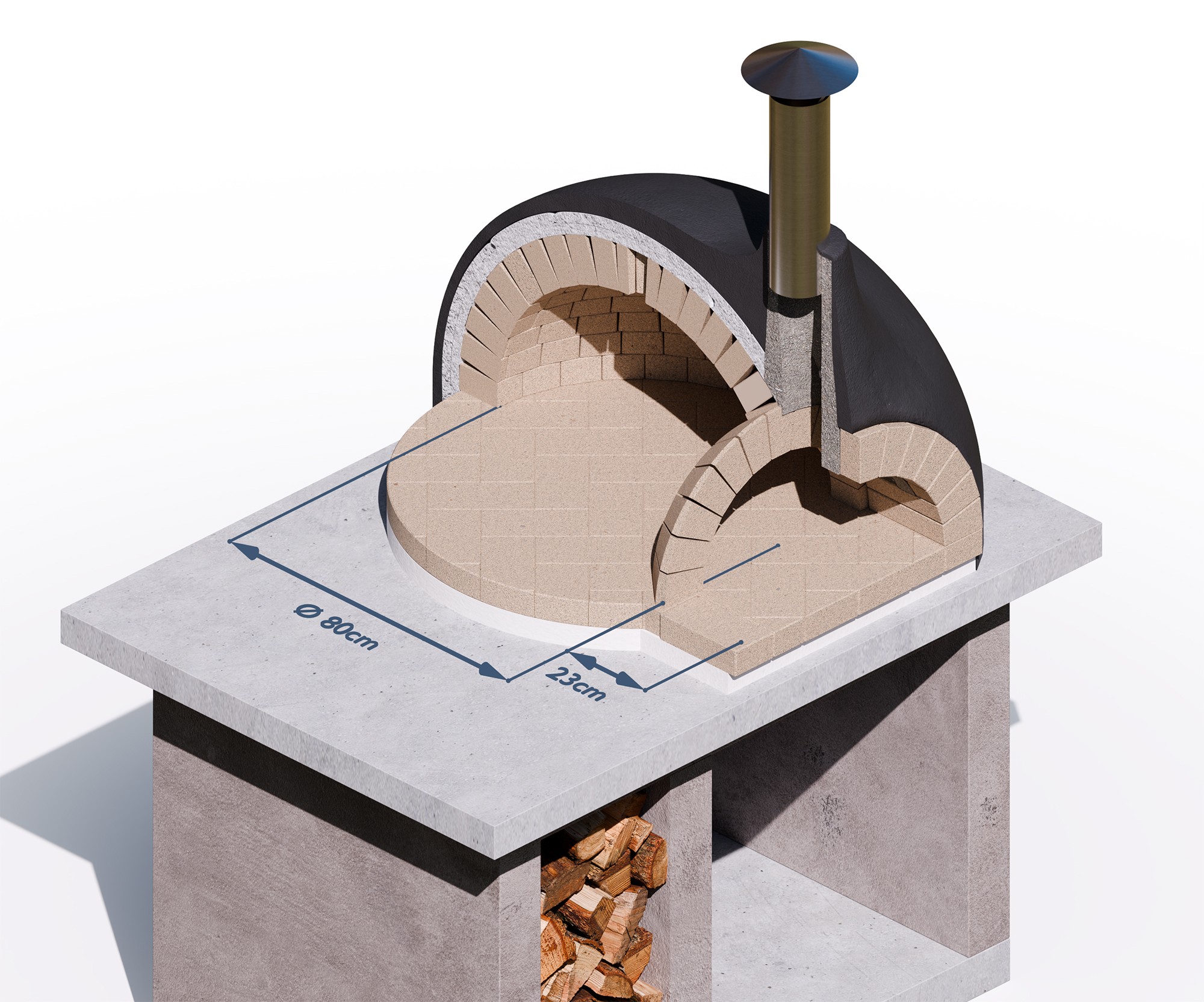

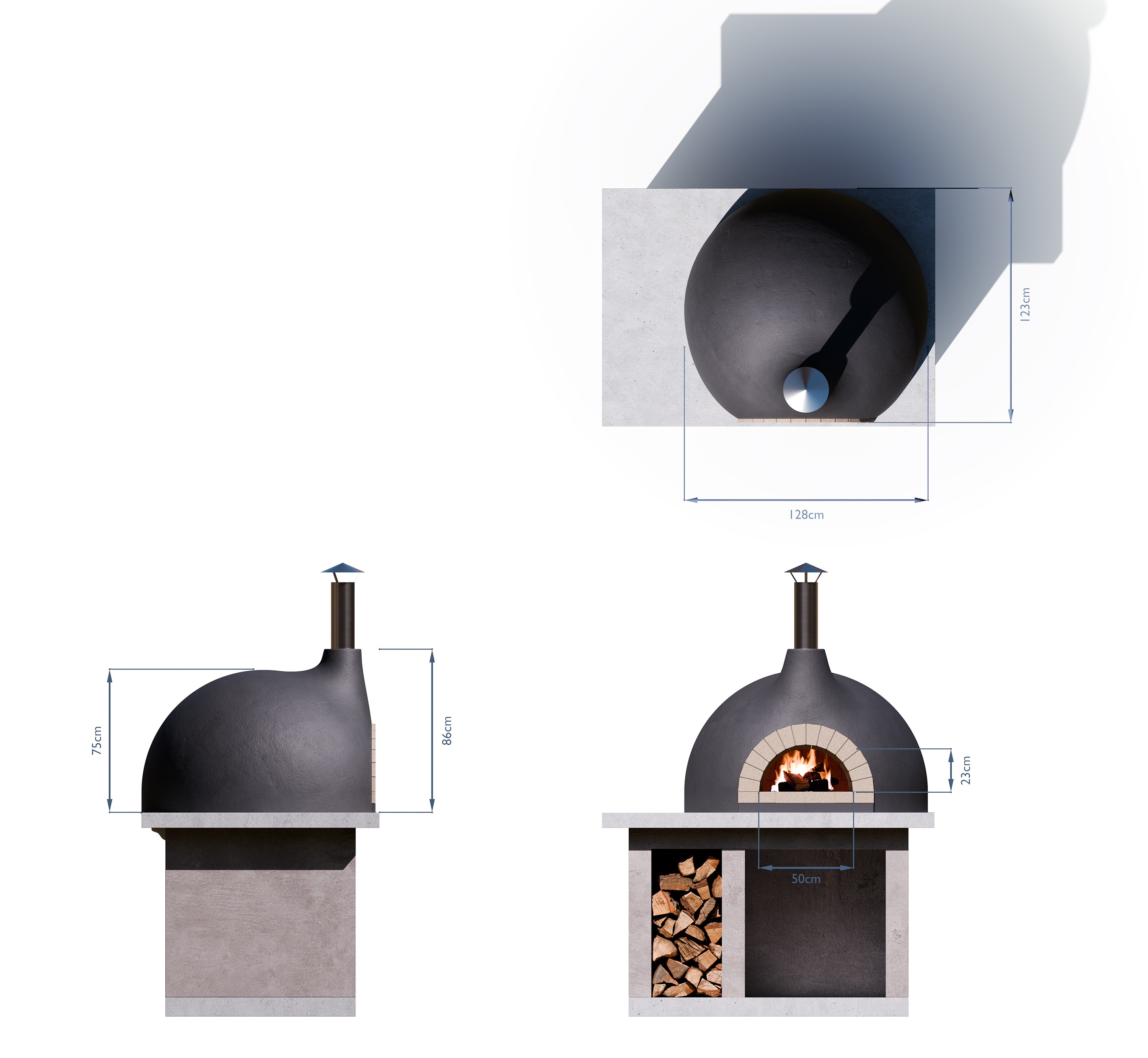

          Thanks David for your last tips. I researched all the topics involved with building my first pizza oven build, mostly researched on this forum, looked at other builds. Based on this I made the design. I used the Pompeii excel calculator to create the base setup and eventually made the whole design in 3d CAD and made some visuals to check the design. I may eventually decide on modifying the outer layer a bit, but for now I am happy with how I want it to look (let's see if I can come close to this ;-)). Eventually I decided on the following:
          - 80 cm internal diameter (so bigger then I initially planned)
          - internal Dome height roughly: 42 cm
          - Entrance width: 45cm
          - Entrance height: 26 cm
          - I will buy 22 x11 x 6 cm fire bricks, that I will cut to the desired size, 11cm brick dome thickness
          - Flue gallery depth: 23 cm
          - Flue diameter: 125mm
          - I will cast the flue transition insitu just like David did in this build: https://community.fornobravo.com/for...nic#post435723
          - I will make the outer layer (render?), so it will be a nice full hemisphere look with a soft transition to the flue pipe
          I actually already build the stand from concrete blocks and put a plastered the outside with a cement base outdoor layer. I still need to cast the top.
          I now thought I need 2 layers of isolation blankets, so that will be 50mm thickness (one layer is 25mm). Is this necessary or is this overkill?
          For the layer of vermiculite I thought it would be around 3 cm thickness, is this realistic?
          Any feedback or tips are welcome, thanks!

            You have a pretty good plan and obviously well researched. With a 6 cm thick floor and 11cm thick walls you have a lot of thermal mass for a small oven. The thickness difference also leads to some imbalance between floor and dome. Cast builds can get away quite successfully with 50mm walls (large cast ovens over 1m internal diameter often have 75mm thick domes). For brick builds which are separate unit construction, history confirms that any brick construction should be no less than 100mm thick). Eg The structural integrity of brick walls for homes or even gardens, is compromised if house bricks are laid on edge (3” or 75mm). A dome achieves enormous strength because of its form, but ovens and kilns have the additional problem of uneven thermal expansion which can compromise their structural integrity. There have been documented brick build failures on this forum that have attempted domes out of splits (2”). What this all means is that your 110 mm thick dome has quite a lot more thickness so there won’t be a structural problem, but it will take considerably longer to get to pizza temps and use correspondingly more fuel. The upside is that it can store a lot more heat and hold given temperatures longer. This will mean that you won’t be firing the oven much to cook just 3 pizzas. A lot depends on how you want to use your oven, but if it were me I’d be looking for some firebricks, for the dome, that were more like the standard house brick dimensions. Cutting 6cm thick bricks for the dome would be a lot more
            cutting and laying work than the standard half brick method.

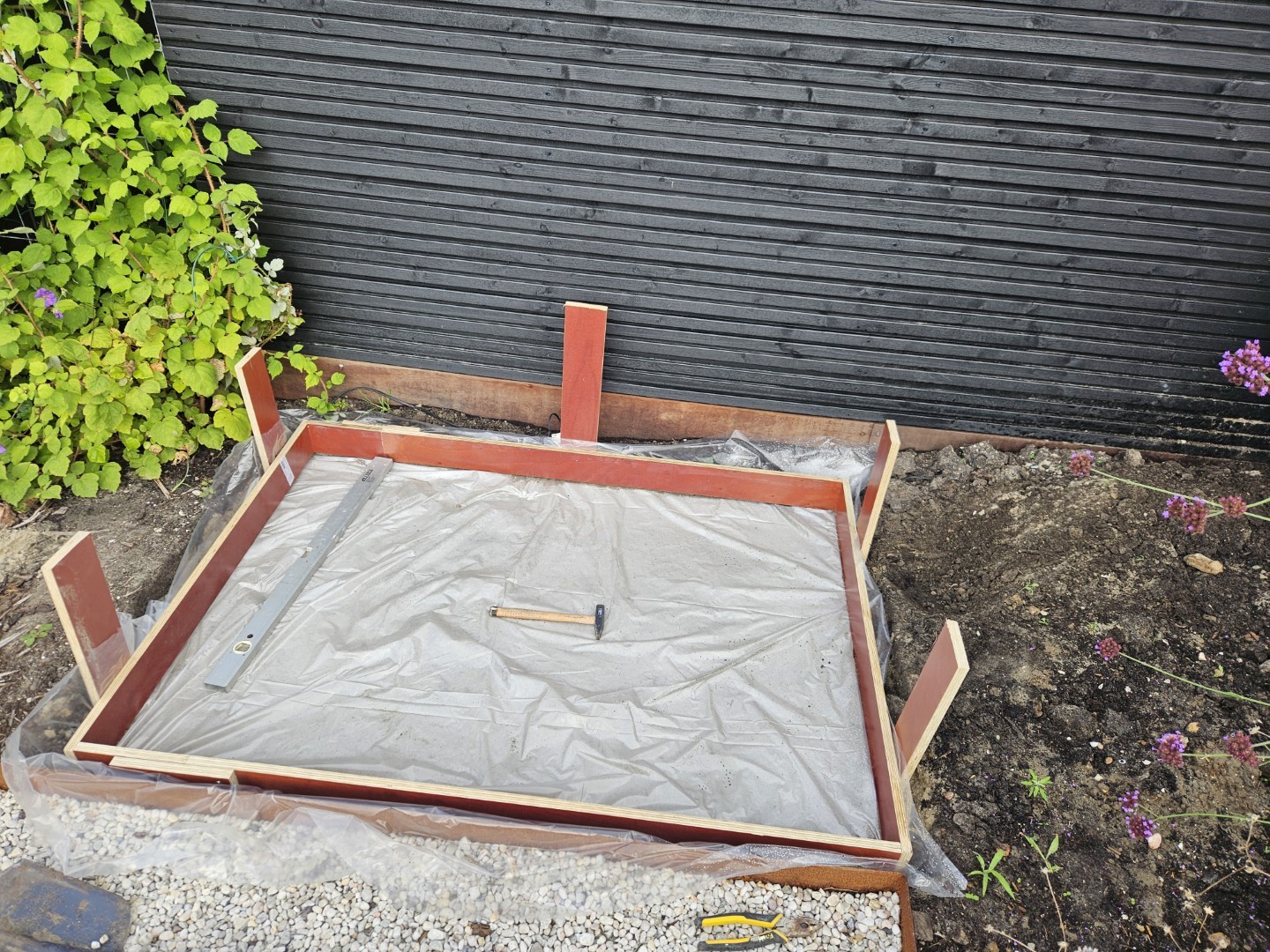

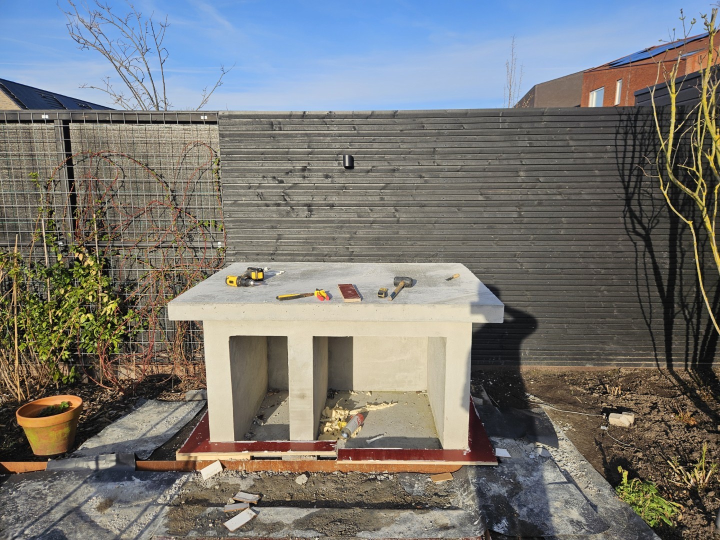

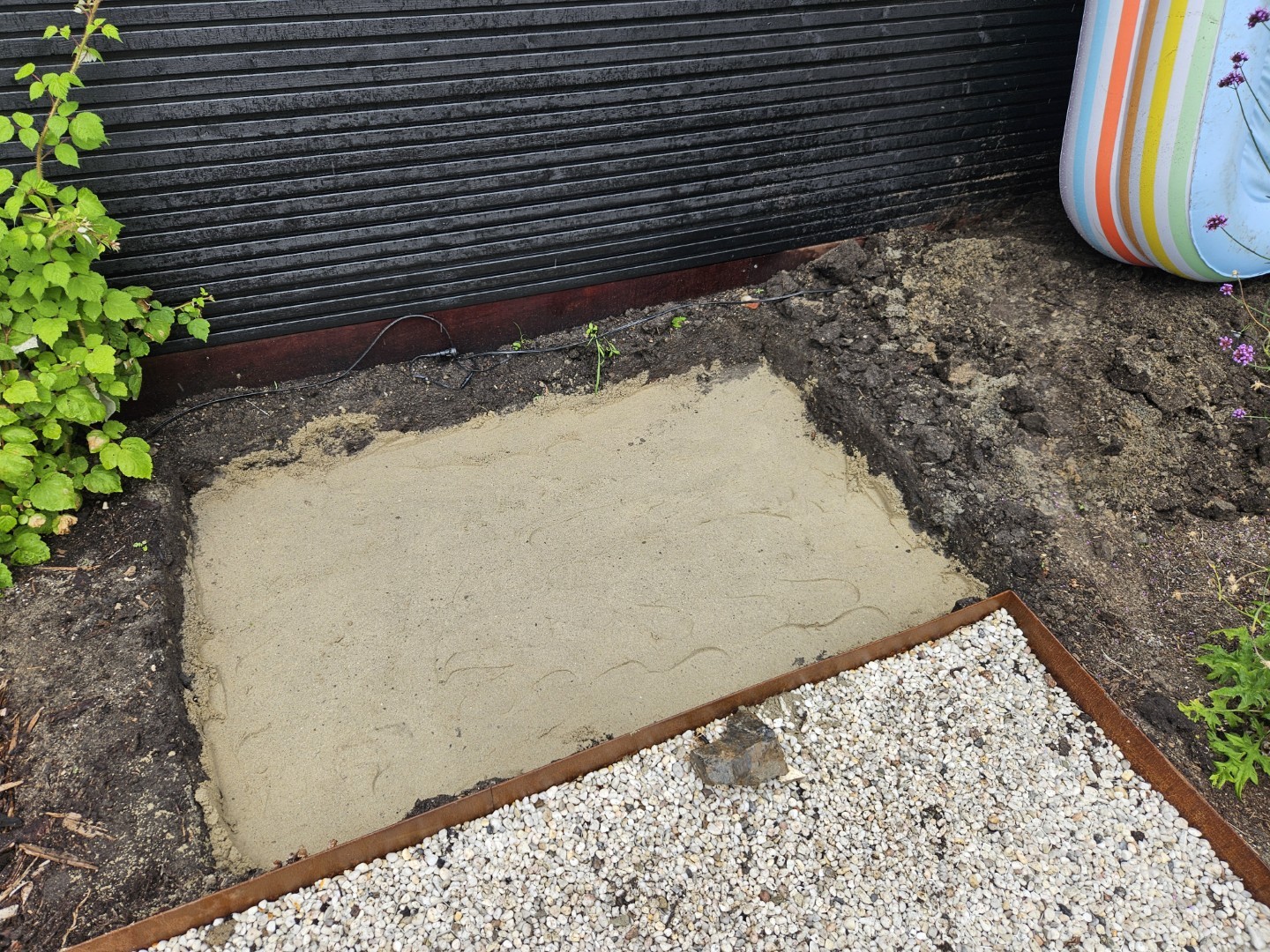

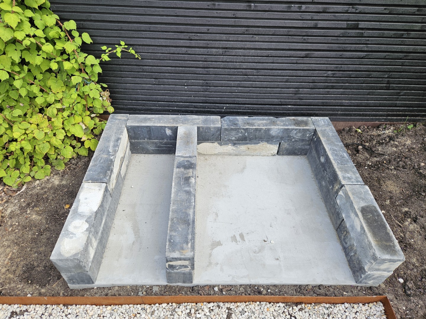

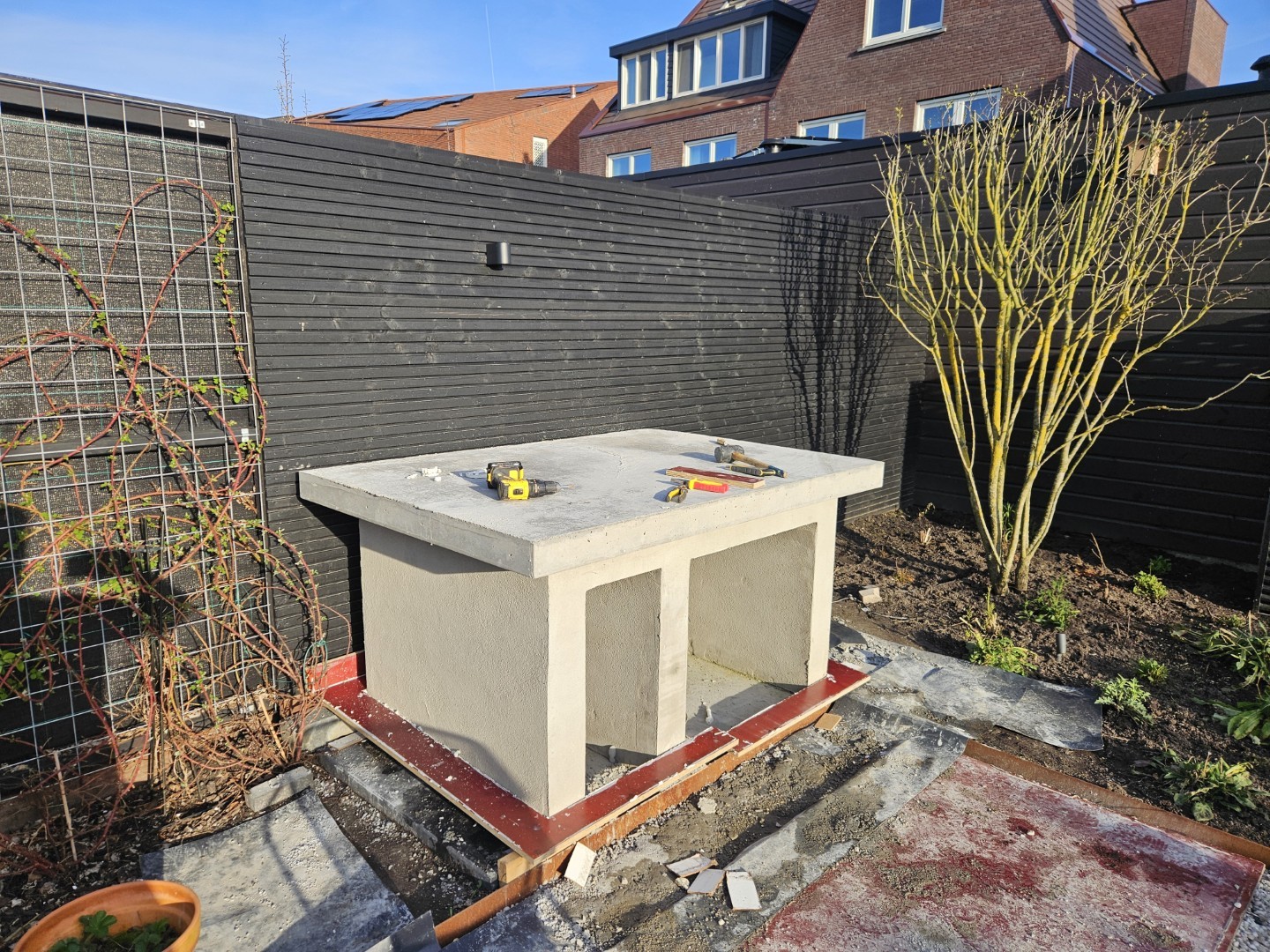

              Attached already some photos of the foundation and stand I already made this past summer, I didn't have much space, so eventually I will have the work top overhang a bit on all sides. I also already plastered the stand (no photos yet), I used a lot of second hand concrete blocks, so they don't look so nice without a nice layer of plastering/cement.

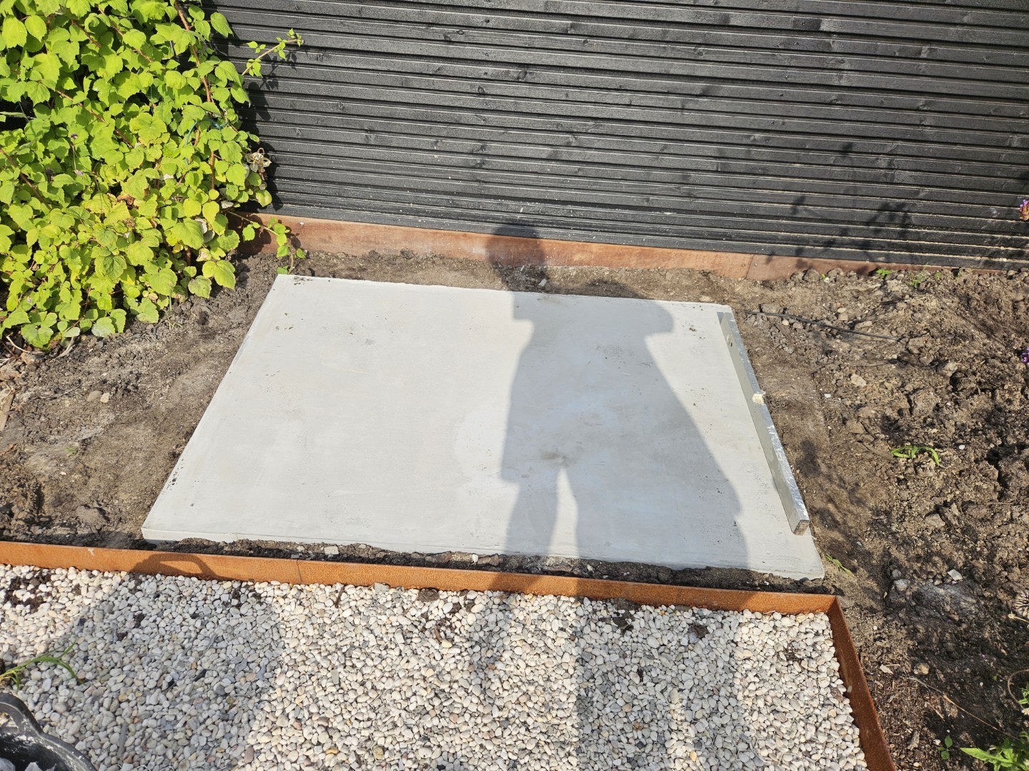

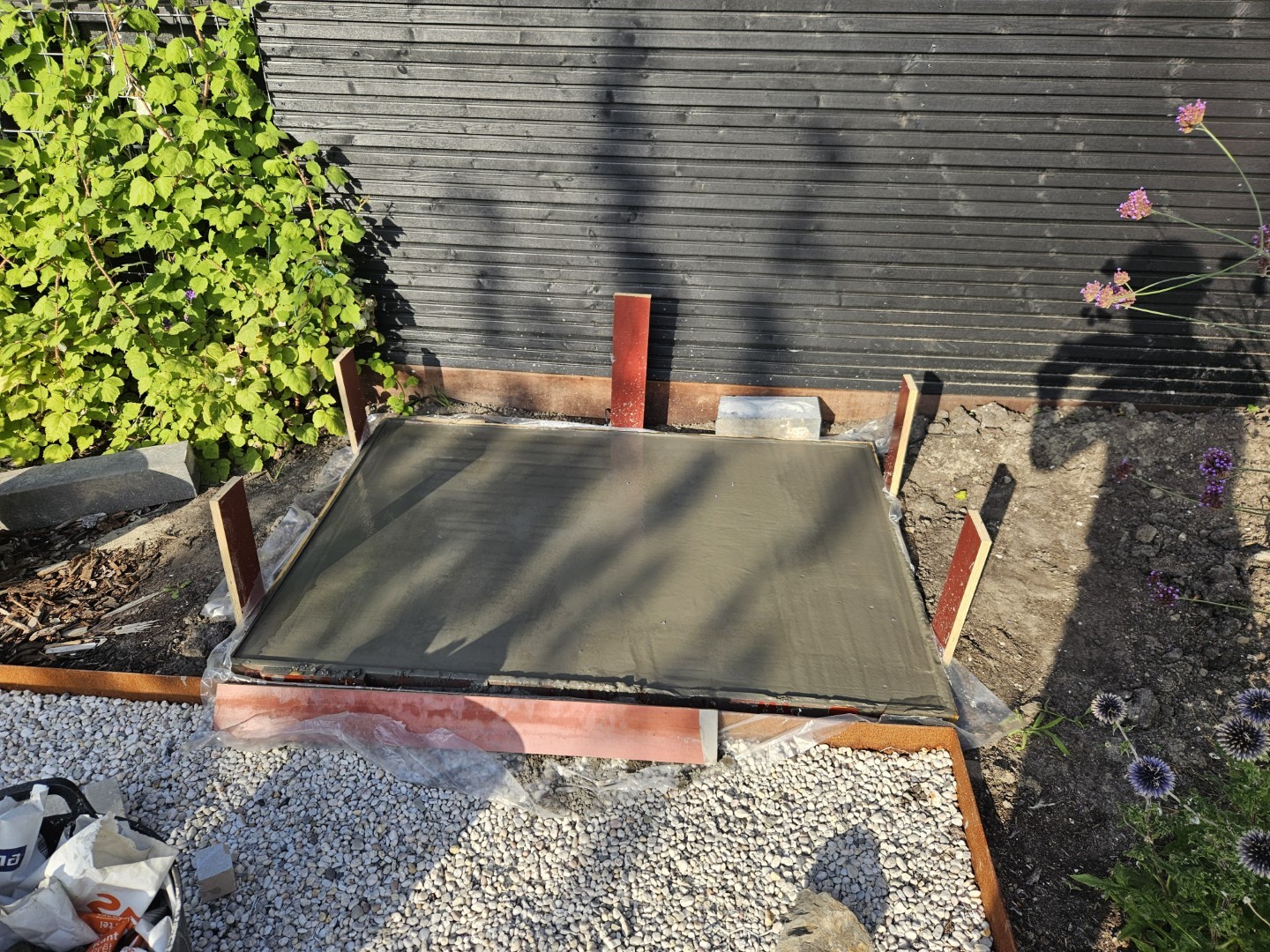

                        Eventually I decided not to integrate the Cal sil board into the concrete slab, I didn't want to make it more difficult then necessary. So last weekend I casted the concrete slab. The top is still a bit rough, so I will sand it down to a smooth finish.

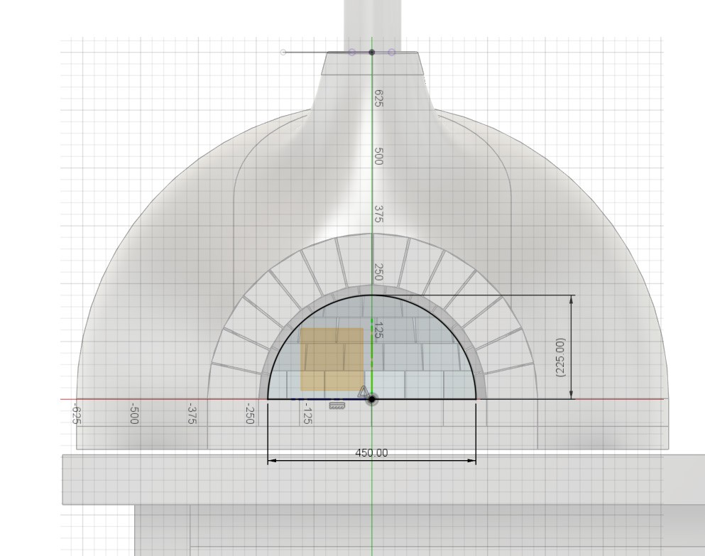

                        As the build of the pizza oven itself is getting closer, I was looking at my build plans again. Because I need to start buying materials and eventually cutting the Cal sil board, I want everything to be correct.
                        I was thinking my Arch entry/opening was not the correct size. My current plan has:
                        Internal diameter of: 80 cm (roughly 32 inch)
                        Dome internal height of: 42.2 cm (16.6 inch)
                        The Pompeii_dome_calculator excel states I should have an opening of 26,6 cm. Now I noticed in my plan I have:
                        - a door opening width of 45 cm
                        - a door opening height of 22,5 cm
                        So I was wondering 2 things. Is my door width not a bit too large? Because I have a hemispherical door opening, if I want to get the right door height, I would need to lift the hemispherical opening on some flat bricks, am I right?
                        Any feedback would be great! thanks

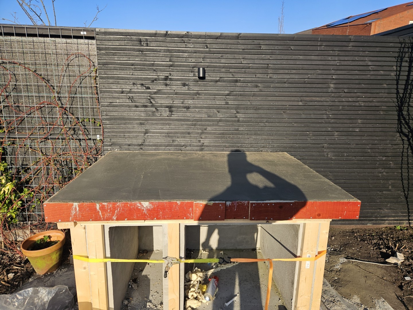

                          I started on the next task. I drilled weaping holes in the concrete slab (I didn't prepare before the cast, because I was worried it would be difficult to get the slab nice and even). I started with a layer of mosaic tiles for a water path and put on there the first layer of Cal-sil board (50mm). I need to add one more layer of Cal-sil (as adviced by David) to even out the layer difference between the 11 cm thick walls and the 6cm thick cooking floor.
                          Unfortunately I made the stand too high, so the cooking floor will be on a height of 117.5 cm (46.25 inch).
                          I also put up a "tent" around the build side, to protect it from rain, and I set up the stone saw. Can't wait to continue!

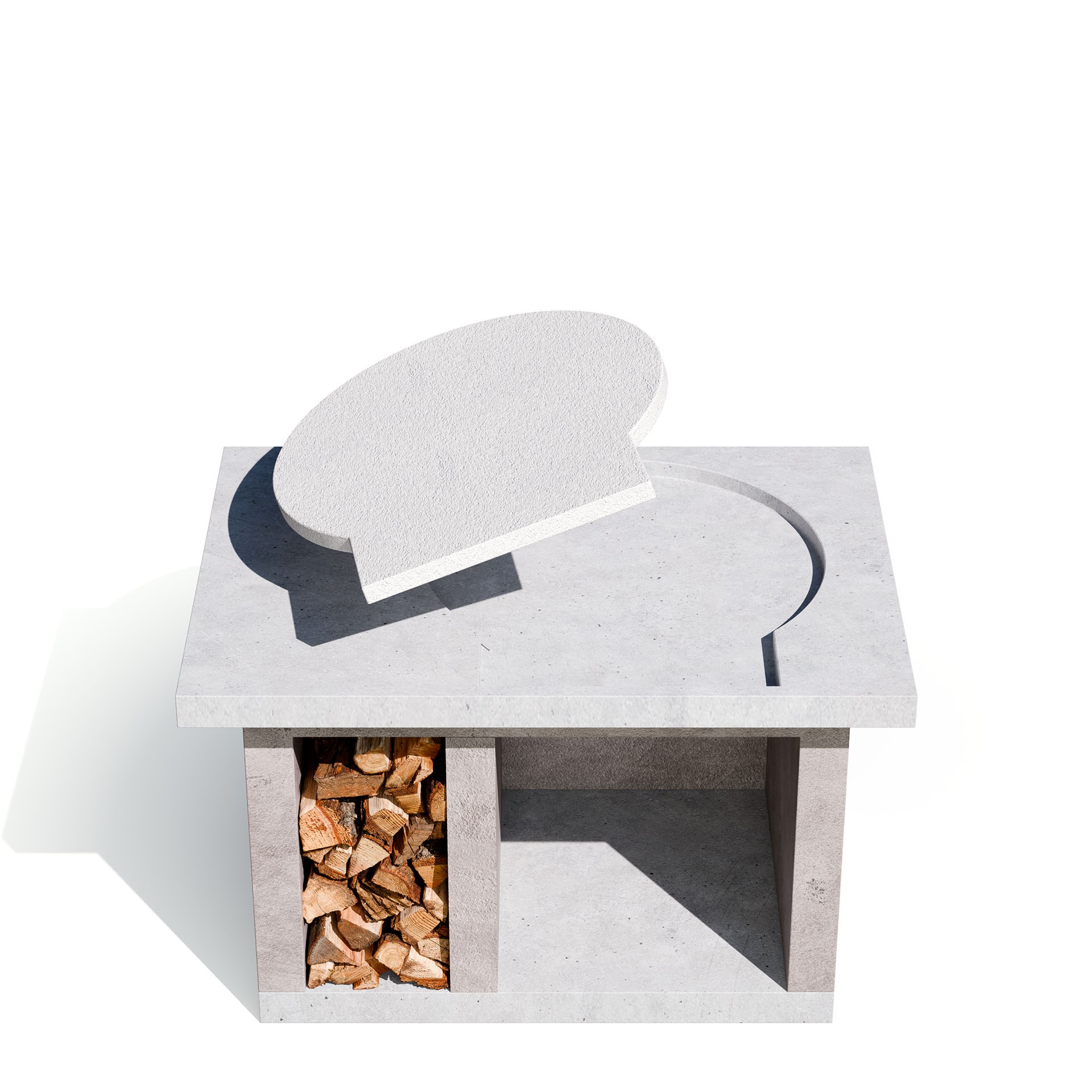

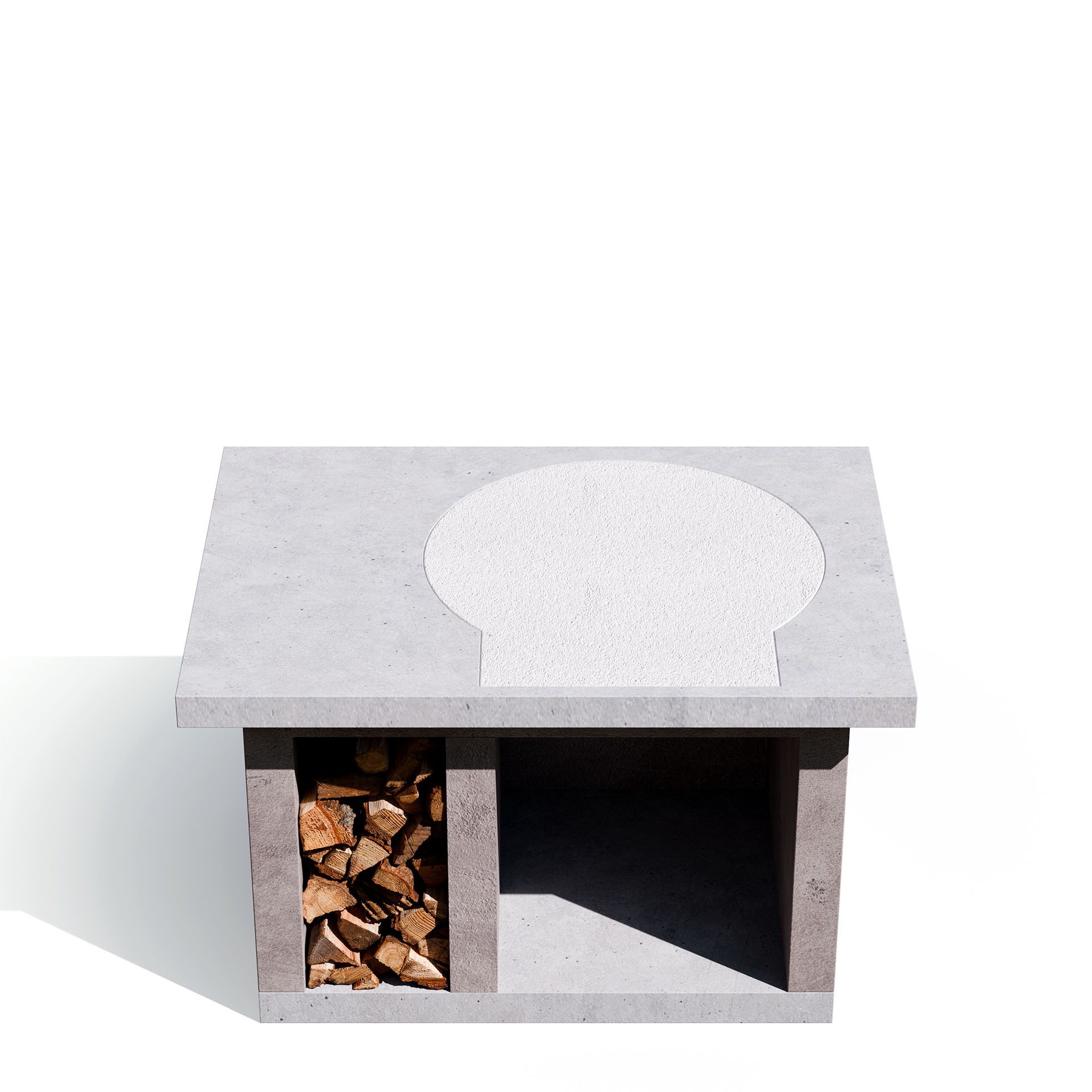

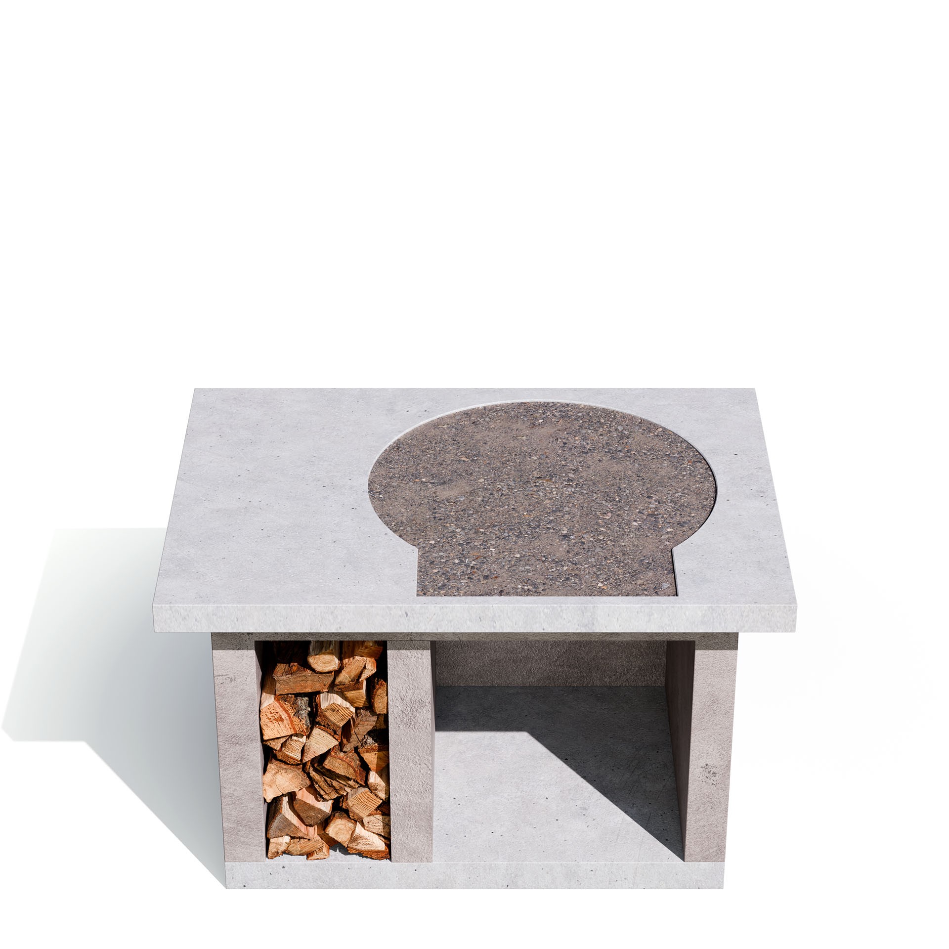

                            I made some progress the past 2 months. I choose to do 2 layers of Cal-sil board (50mm each), so the cooking floor is a bit heigher then I wanted, but I rather have a good insulation. I worked my way through the cooking floor, leveled it a bit with some sand/fireclay mixture.

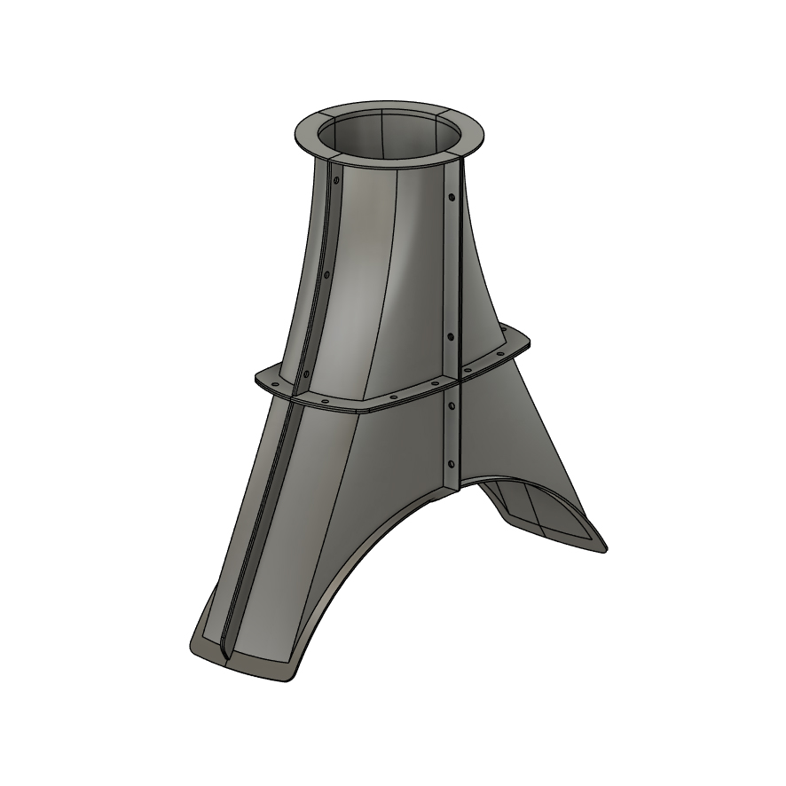

                            Also I want to prepare the flue gallery transition, I want to create a 3d printed mold/template to cast the plug. I want to create some kind of weak plaster that is so brittle I can just cut it out easily when I casted the refractory concrete over it. I know you can do it with a mixture of plaster and perlite, but I know you get a very rough mixture then. I found you can also get a brittle plaster when mixing it with too much water or by adding calcium. So I will do some tests with this.

                              david s I have a question regarding the flue pipe, as I used your flue gallery as inspiration for my wfo, I thought to ask you. I am going for the 125mm pipe as you suggested before. Now I was wondering if I should go for a double walled pipe (would this have advantages) or just go with a single wall pipe. Also I was wondering what would be the ideal height for the flue pipe?
                              Attached also a photo of the 3d printed mold I made for the plug (flue gallery to pipe transition).
