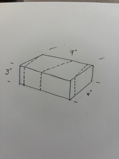

          Fire bricks are expensive and cutting them is time consuming so minimising waste and number of cuts can save a lot of expense and time. Firebricks come in all sorts of shapes and sizes, but if they are close to the dimensions of standard house bricks, here's a method that can save bricks and time. You can get two half bricks from three cuts with minimal wastage. the off cut wedges can be used to poke in the voids from the outside either as you lay or after. this results in the required 4" dome thickness. Don't cut too many in one go because the angle required changes as the chains go higher towards the dome apex.

            That's a nice approach to the issue, and this way you also manage to keep a pretty face in all your inside facing bricks. It's a definite improvement to cutting every brick square and then having to fill massive gaps, haven't thought about it, so it's gonna help if I go that way. Thanks again!
