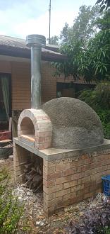

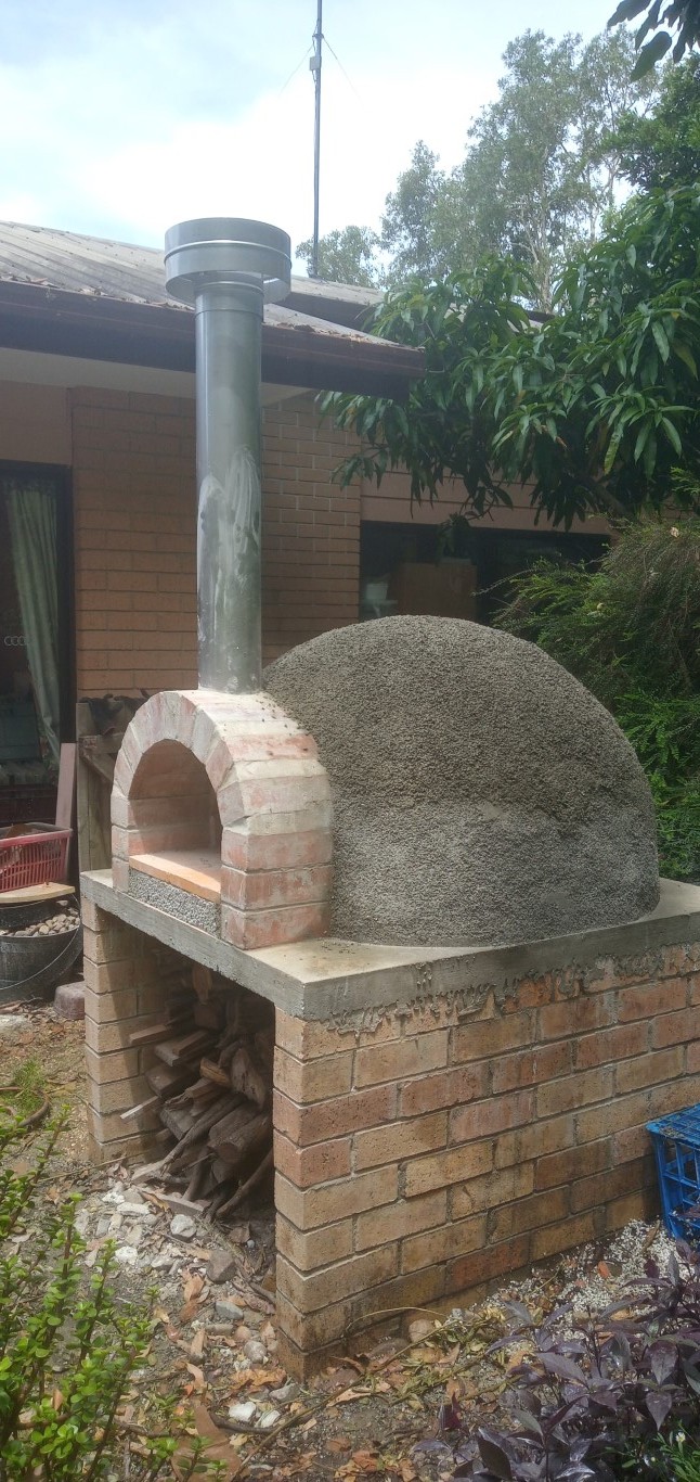

                          So, during firing #2 a crack opened up in my 10:1 perlcrete insulating layer (75mm) over the house-brick dome, yet to be rendered. It closed up again when the oven cooled so I am not particularly worried about it,
                          I had an idea and would appreciate feedback.
                          I plan to fire 3 more times before rendering (looking forward to guests tonight) to give everything a chance to really dry out.
                          Would it work to cover the dome in glass fibre insulation, then chicken wire and render onto that.
                          My thinking is that the glass fibre will create a bit of expansion space, saving the final rendering shell from cracking.
                          Thoughts?
                          Thanks in advance
