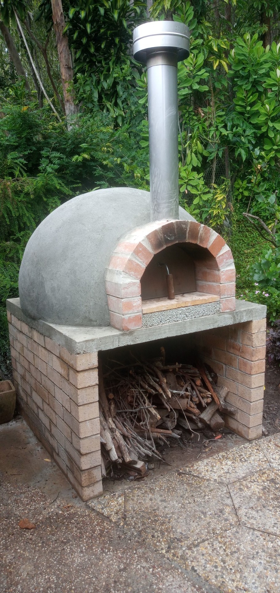

        A year on from my build I have decided that worrying about cracks is over-rated.
        Mine has a fairly long crack along about 50% of the length from front to back. When I finished the build I was really concerned about the crack and kept patching it. Each time I used the oven, the next day I would fill the crack with mortar and then next time it would open up again.
        Nowadays I am not worried about it at all.
        It opens up when the oven is hot and closes when it cools down. For sure some rain gets in, then when the oven is fired, some steam comes out for a while No doubt the insulation is compromised, but big deal...we make 15 or so pizzas and are not counting on retaining the heat.
        It makes outstanding pizzas.
