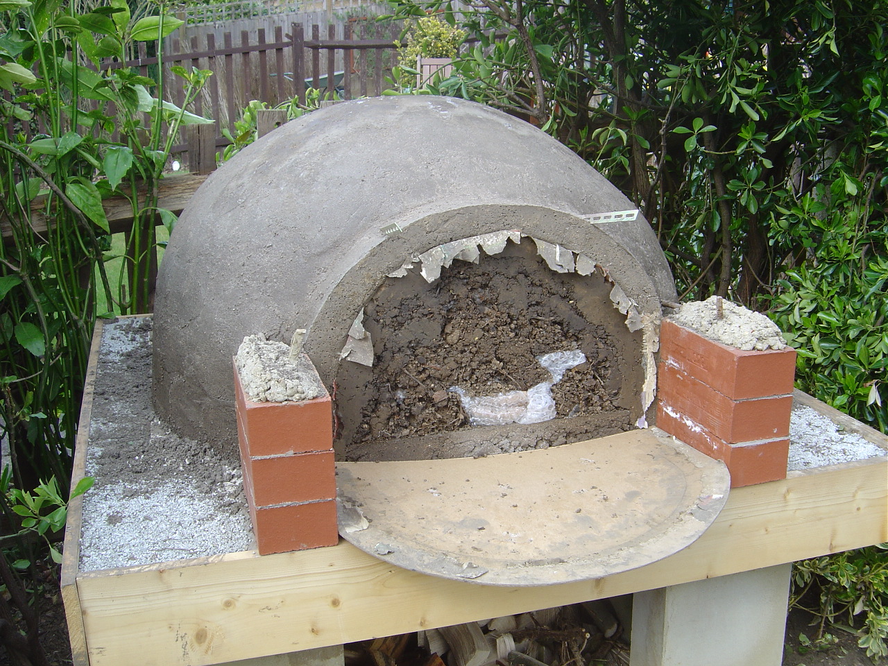

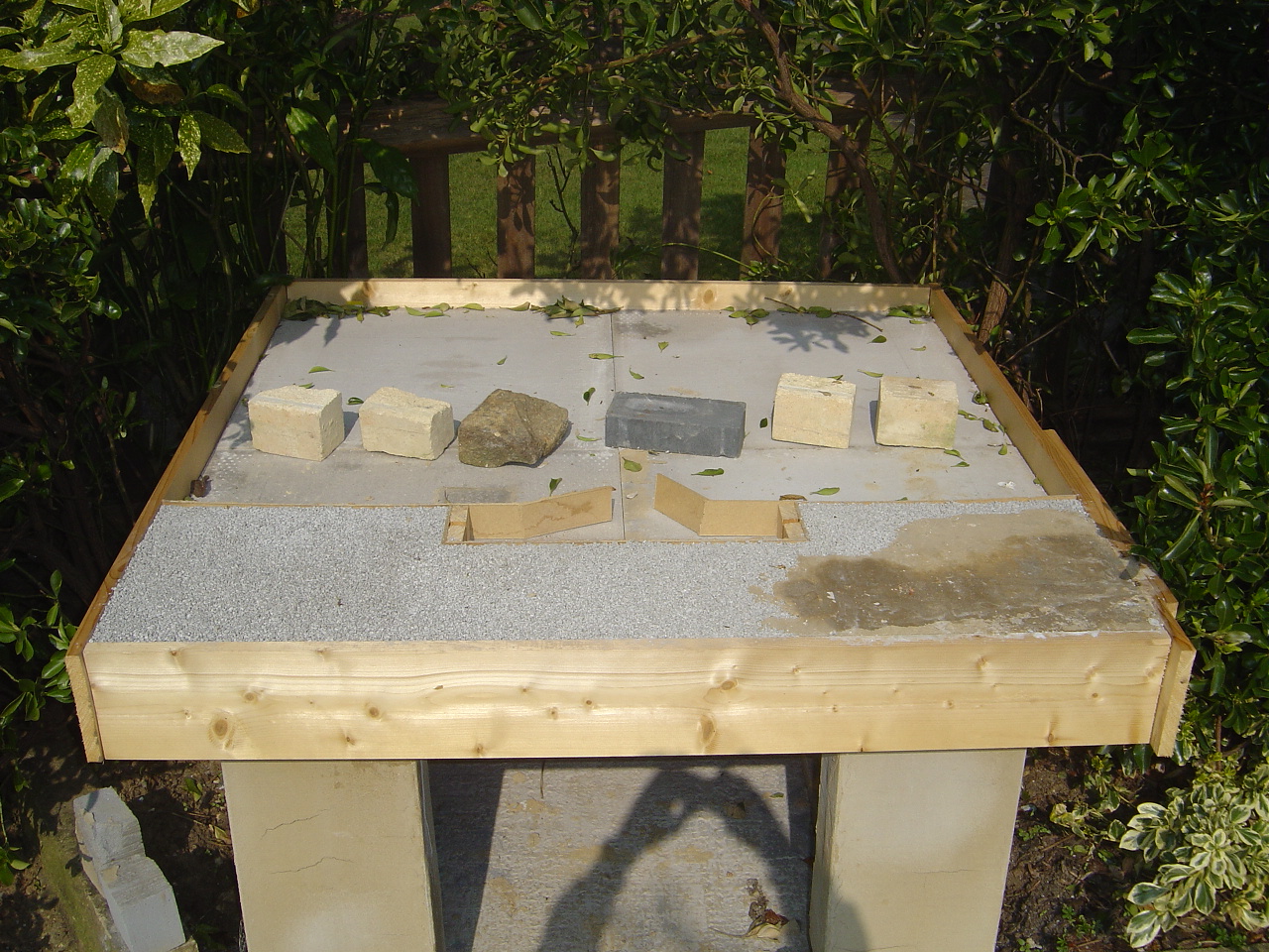

          Stand done, time for the dome. A 50mm layer of insulating board went on first, with perlcrete cast round it up to the edge of the slab.
          I had a few firebricks - a very generous gift by aureloe - thanks aureole! There were just enough for the cooking floor - but I also had some refractory concrete courtesy of aureole too. Since I was going to be making the dome 50 mm thick, and general experience from reading on this forum is that the floor is slower to heat than the dome, I decided not to use the bricks. I decided to experiment and try the refractory concrete for the floor too. I used a 50mm wide strip of hardboard to form he shape: bent into a circle, with a sticky out bit for under the entry arch. Casting the floor was dead easy. So far it's seeming ok - a single crack but that's it.
          Then use some of the clay soil I'd dug out for the foundations to make a former, cover it with newspaper to make it easy to remove, and plaster on the concrete for the dome. Much easier than I thought - I was dreading this bit. I bought some extra concrete and it turned out to contain a few stainless needles, which I was very pleased to see.

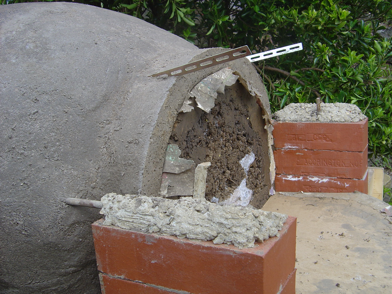

          You can see I'd made a start on the vent / chimney arch by now. Two reasons - impatience but also cos I wanted to be able to tie the dome to the chimney. With the chimney arch only 1 brick deep I was slightly worried about stability - so you can see I've got metal bars tying it into the dome. These needed to be in place as the dome was cast, and it was easier to locate them after starting the chimney arch.
          The following pic shows them even better - the lower ones already tied in to the bricks, upper ones waiting for the bricks to meet them.
          You can also see reinforcing in the bricks. They were standard 3-hole engineering bricks: to give the arch strength I filled all the holes with concrete as I was building, and added reinforcing steel in the centre hole.

            Digging out the clay was a bit slow but very satisfying - seeing the dome where all the action would take place fully revealed. And not collapsing !
            Onwards with the chimney arch / vent. More engineering bricks. Lot of trimming of the bricks with an angle grinder, before mortaring them in place, to create a vent and hole for the bottom of the chimney.
