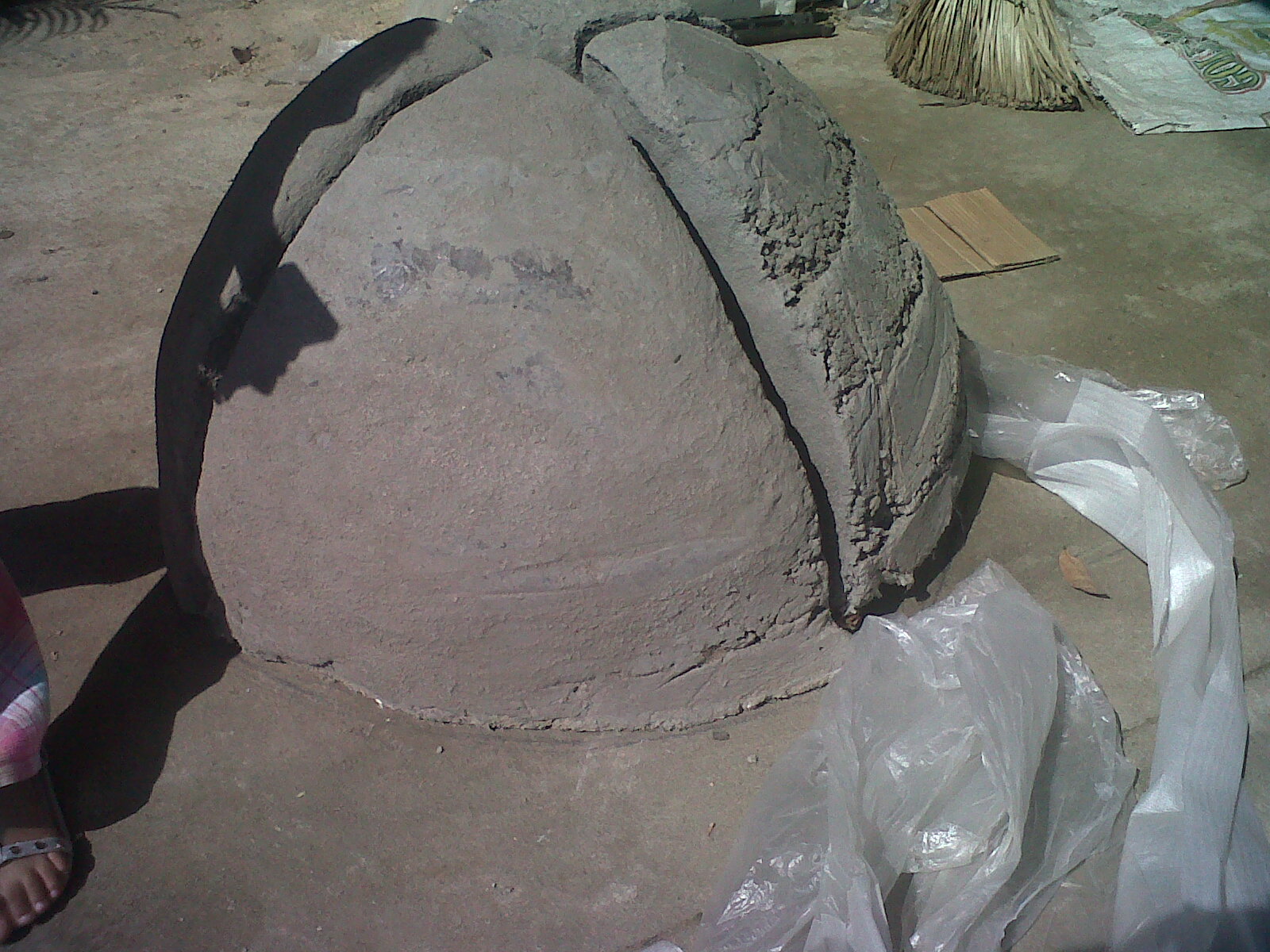

            Hi Guys
            My progress has been really slow as I?ve been waiting for my table to be modified further and hopefully I would have it back any day now. In the interim I?ve been thinking about the next part and how to approach it.
            I?ve decided to do the following and need some advice on whether I?m heading in the right direction or do I need to rethink this.
            Never the less, on the table (Picture attached in previous post) will be laid a Metal Sheet. The oven will sit dead center on the table and have a gap of approx 3? to 4? on all 4 sides of the table. I have the following plan. I will place just on top of the metal sheet a 50mm ceramic board. The board will cover the exact same area as the oven which means it will also leave the same 3? to 4? gap on all sides of the table. On top of the Ceramic Board will be laid 3? fire brick. The fire brick will not cover the entire area of the Ceramic Board, it will only cover the same area as the inner diameter of the oven which is 26?. Never the less, around the Fire Brick but still keeping in line with the Ceramic Board, I would like to fill an insulating material to the height of the firebrick, maybe 3mm less than the very top of the brick so the brick will now only protrude by 3mm. Around the ceramic board/insulating material; I would like to fill the 3? to 4? gap with maybe Portland cement for structural strength of the table as a whole.
            A few questions on what I?ve mentioned above.
            1) Can just an insulating material like Vermiculite be filled on top of the Ceramic Board and is it strong enough to hold the weight of the oven.
            2) Will Portland cement be fine to fill in the gaps surrounding the oven and how will it fair to the little heat that comes from the oven indirectly?

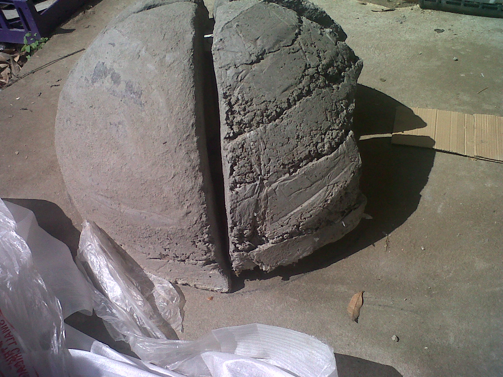

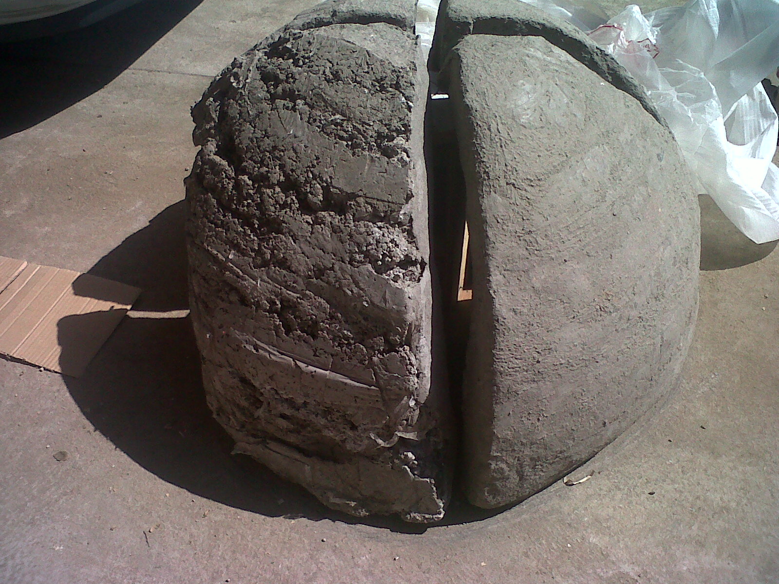

            The next part is to put the dome pieces on top of the Vermiculite and then join them. I plan to join them in the following way. First, plaster the bottom of the dome pieces with mortar and then fix it to the vermiculite. Next, once all the pieces are in place, I am already anticipating big gaps in between each piece as I?ve already placed each piece next to each other to see how it looks and I?ve also attached pictures to make it more visual.
            Questions
            1) I?m already dreading the thought of hoisting these dome pieces onto the table. Any tips from you guys to avoid health problems ?
            2) As can be seen in the pictures, the gap in between each piece is quite large so would mortar suffice to fill these gaps and at the same time create a bond with all the pieces?
            Lastly, I?m not too sure how my material is going but I may just run out of Refractory Cement for my vent. I may end up with extra vermiculite and mortar and I also have quite a lot of stone pieces from sieving refractory cement earlier in my project to get my cement more smooth so i could fill in the voids on my dome pieces. Anyways, if I were to mix all of this and top up with a little bit of Portland, would it be sufficient to build a vent or do I just go and grab a few bags of cement for the vent?
            Looking forward to hearing from you guys.

              Re: FINALLY!!! - Start Of Building My Oven
              1) Can just an insulating material like Vermiculite be filled on top of the Ceramic Board and is it strong enough to hold the weight of the oven. Yes, but 50 mm calcium silicate board is enough insulation on its own. you can place the floor directly on it.
              2) Will Portland cement be fine to fill in the gaps surrounding the oven and how will it fair to the little heat that comes from the oven indirectly? yes providing it does not contact the floor or the dome directly. that is there should be insulation separating them.
              1) I’m already dreading the thought of hoisting these dome pieces onto the table. Any tips from you guys to avoid health problems  two or three people should be able to lift them ok as it is only a 24" oven
              2) As can be seen in the pictures, the gap in between each piece is quite large so would mortar suffice to fill these gaps and at the same time create a bond with all the pieces? yes, use the homebrew mortar. If you can't get fireclay then use crushed sifted anthills
              would it be sufficient to build a vent or do I just go and grab a few bags of cement for the vent? Use some more castable a Portland based castable will probably crack. You might get away with using homebrew to make a castable and add your leftover aggregate in place of (or as well as) sand in the mixture.
              Good luck and get this thing fired up,
              Dave
