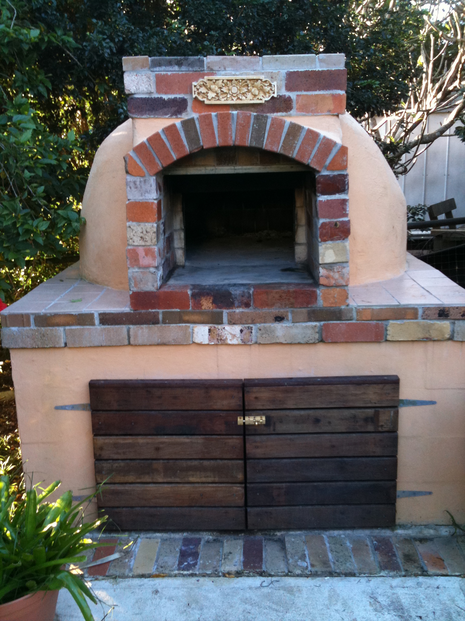

                    Hi all
                    Wouldn;t change much
                    Pompei brick oven to Forno plans everything is tried and proven ....right down to the herringbone patern of laying the hearth so the peel don't catch.
                    42 inch yes.... 3 pizza at once....Good size entrance great for big pans could not see anything under 32 in being usefull
                    Fire brick and ceramic insulation yes.....Firebrick store a goodly amount of heat and ceramic keeps it in for longer usable slow cooking time.
                    Deep entrance yep.... love having a area for an "ambient" fire in the front. 42 in has big opening so it makes no difference to operating the oven.
                    Igloo dome Yes....just like the look
                    Dome built on a plywwod guide....Na would use the indespensable tool if theres a next time.
                    Stand with one entrance for stowage....No would have a entrance on either side for easy of access theres some wood down the back of mine thats been there since its been built!
                    Cut all the brick angles with a saw...No... did it with bulster and diamond blade on grinder....works well enough and didn't take to much time and still produces a dome which is a strong structure itself.
                    Use the forum more.. Big yes...Not a big computer user and never been in a forum theres heaps of information and some truely awsome builds in here.

                        Gudday
                        Check out " First time oven build " by megapulse in the Australian section.
                        Ive just seem this oven in the flesh so to speak and the stowage is awsome!
                        Regards Dave
