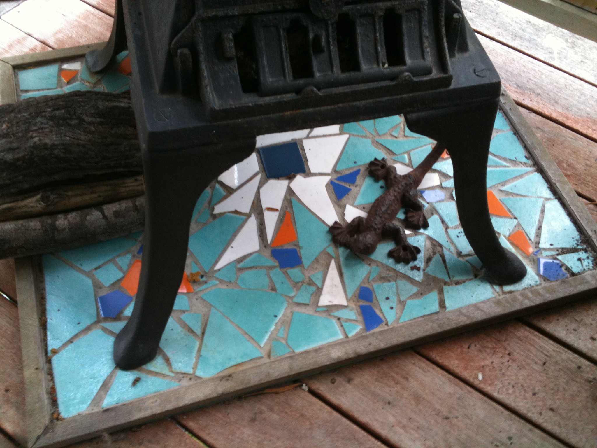

      Its pretty easy to do...basically tiling really. Break up you tiles and glue them on with tile glue which I might add is cement based ( yes you can get rubber types you don't want them). when the items covered you fill the gapes in the tiles with tile grout. you don't have to use the white grout either there coloured types as well. grout sealer is also avaliable which will mean you can make your ovens pretty waterproof.
      I have attached a pic of a mosic under the little pot belly stove on the back deck at home
