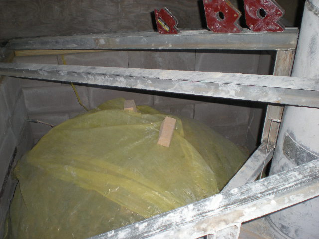

          As we have approaching winter here in Minnesota, I am concerned about possible freezing of my bricks before getting a full cure on the oven.
          I will be leaving the oven covered with plastic and a blanket and on cold nights putting a 100 W light bulb in the oven to keep it from freezing.

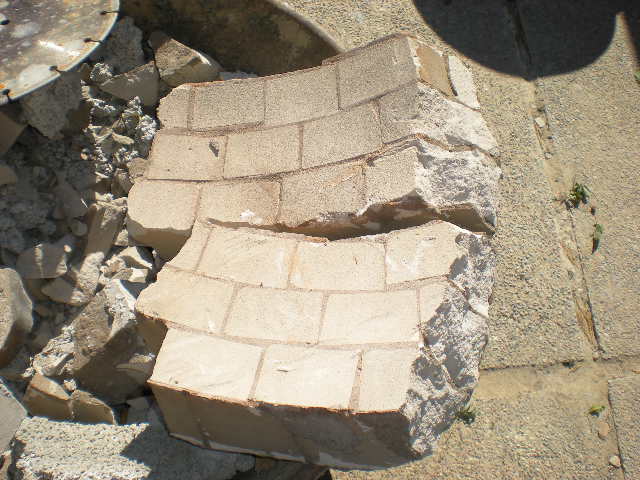

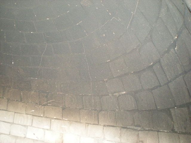

              I have been reading up on the topic of freezing of refractory brick and it seems that freezing the wet bricks is just as hard on them as expanding steam. The reason I looked into this was my recent Very difficult experience with my oven. I built it from some bricks that I had acquired on craigslist a few years back.
              The bricks had been left outside uncovered for several years and had experienced many wet freeze thaw cycles. I completed my oven Dome brickwork about 5 weeks ago and had started my curing fires 2 weeks ago. When the temperature reached about 400? after the 5th day of firing I experienced a fairly significant crack vertically from the base up to the 9th chain directly through the bricks not on my mortar joints.
              I was not experiencing any steam coming off the bricks so I believe that they were fairly dry at the time this crack appeared. My outside temperatures were in the 170? range on that day.
              I believed that this single crack would not be significant if that's all I received but 3 days later after keeping the oven at under 200? for up to 6 hours each day I decided to push the temperature back up to 400 again. 2 more cracks developed one along the mortar joint above the 9th chain. And another vertically through the bricks about a foot from the original crack this one from the base up to the 9th chain again.

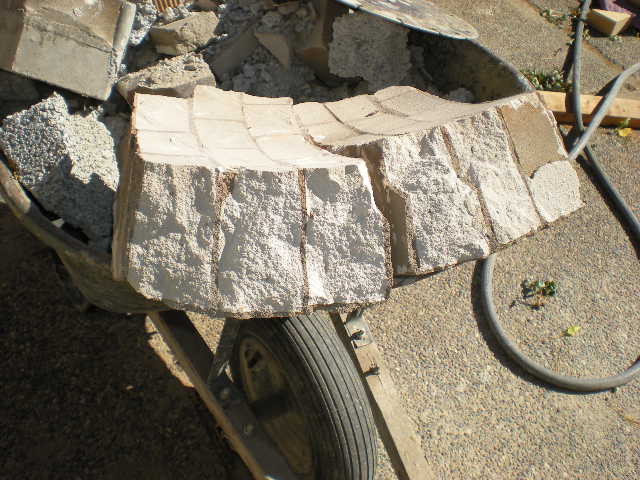

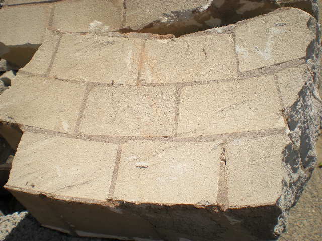

              At this point I became very concerned about the cracks going through the bricks and not along joint lines. I filled the cracks with fire clay slurry in an attempt to patch them. Unfortunately subsequent firings produced even more cracks all with the disastrous through the brick not on the joint line cracking.
              Last Saturday I tore the oven down because there were over 20 cracks going through the bricks vertically and I believed the oven to be unstable.

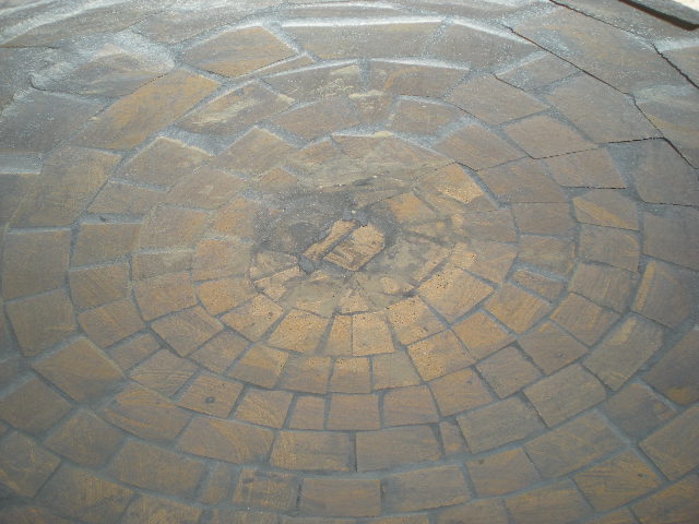

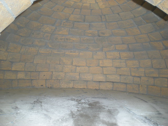

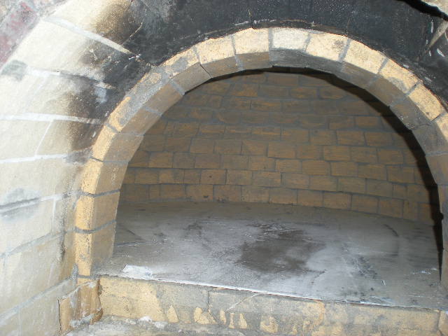

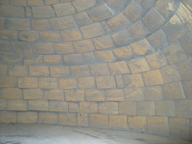

              Last night I put a keystone in my new Dome built with brand-new bricks.
              As you can see from the photos the bricks broke and the joint lines remained very solid. With the exception of the horizontal crack at chain 9.
              The last photo is of the oven with 2 of the vertical and the 9th chain cracks; These expanded to over 3/8 inch width at 400 degrees F.

                  Yes, 6 days and I am sure glad I used a thermal break methodology. and the flue arch was made of larger new bricks and did not not get touched.
                  It is amazing how much you struggle with on the first build that just seems easy on the second. Also take a look at the new cutting jig I developed for this new build. "Possible - New idea for brick cutting table" posted today.
                  The new jig saved me huge time in both setup and accuracy.

                        It was in so many pieces it was real easy. I stuck a screw driver into one of the larger cracks and it came apart like a jigsaw puzzle.
                        I only used a hammer (very carefully) when I took apart the inner arch. interestingly the inner arch had no cracks at all and there was no cracking within 6 inches of it. I used the inward reaching arch technique developed by GianniFocaccia (John) and others it seems to be very stable so I used the same technique in the rebuild. I am also glad I used a thermal break at the transition to the flue arch.

                              I am happy with the choice I made to rebuild it.
                              I still have some cleanup to do but the dome is sound.
                              More photos in next post.
