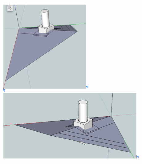

    The roof design is a type of offset delta wing over the oven and the prep table; the left wing of the roof is slightly longer to cover most of the prep table.
    The structure is welded 2X1.5 wide flange I beam steel. The front peak extends beyond the entrance to the oven by about 3 feet.

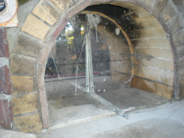

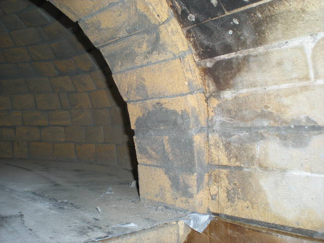

    I made a temporary door out of a piece of stainless that will end up being the inner surface of my insulated door.

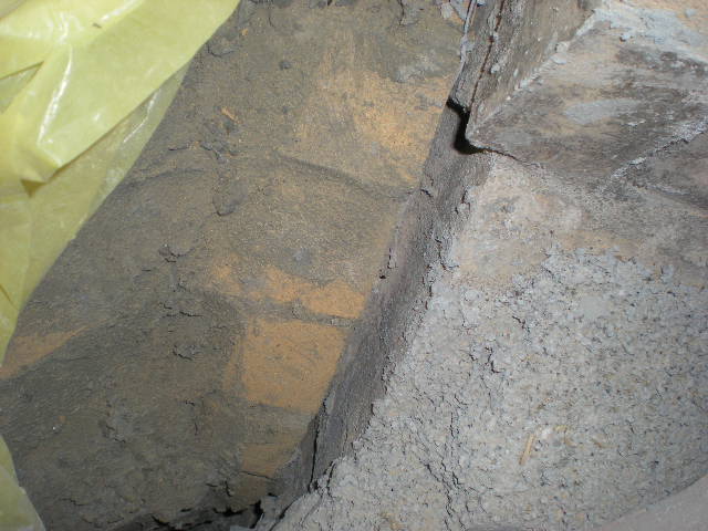

    My original dome (now a pile of rubble) had a piece of stainless between the inner and outer arch to protect the leading edge and create a nice smooth surface for the door seal but I could not figure out how to guarantee a perfect fit building it in reverse so I left it off the second build.
    Last photo is of original stainless piece at the thermal break.
    The thermal break is still intact as you can see in photo 3, this gap will be filled with perlite; The outer flue arch still has the carbon build up intact; very strange to look at...
    I will remove the floor protector after my final internal cleanup.
