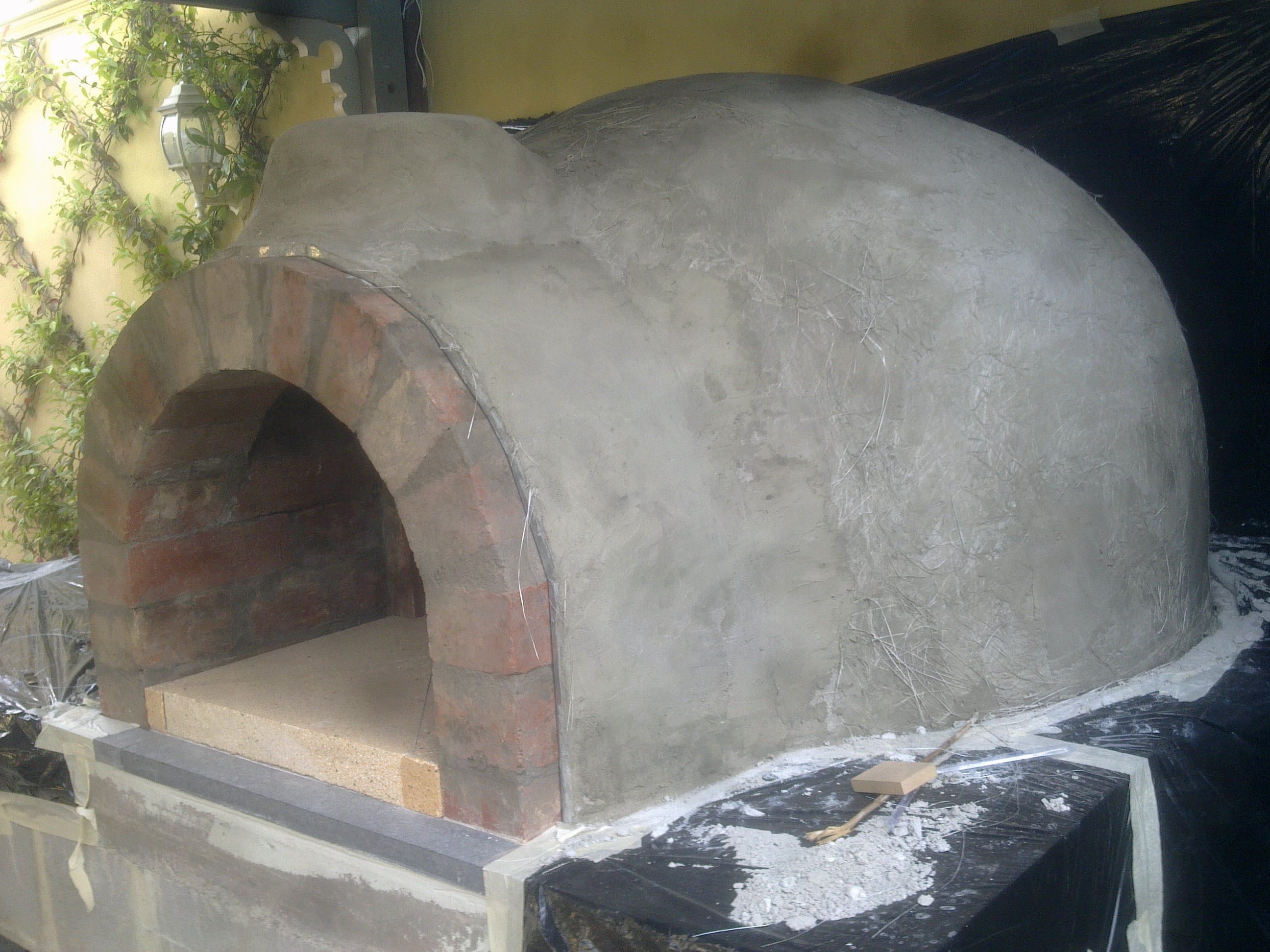

    hi all, i am at the final stages of my wfo, in that, the base and dome just need finishing touches to them. i would like to finish my dome (which will be exposed to the elements)with marble pieces glued to the outer skin of oven. I put on a single coat of render so far (about 1/2 to 3/4 inch thick) which was made up of 6:1:1 white washed sand : cement: lime and a little bond crete with fibreglass strands spread through over dome. I was going to put another render layer over but i have read it is mainly for getting the desired shape , which i already have, and then glue on marble pieces. My question is do i need another render layer,how do i get the oven waterproof and will that be ok when i go to stick on my marble pieces with tile adhesive?
    cheers,
    Tony

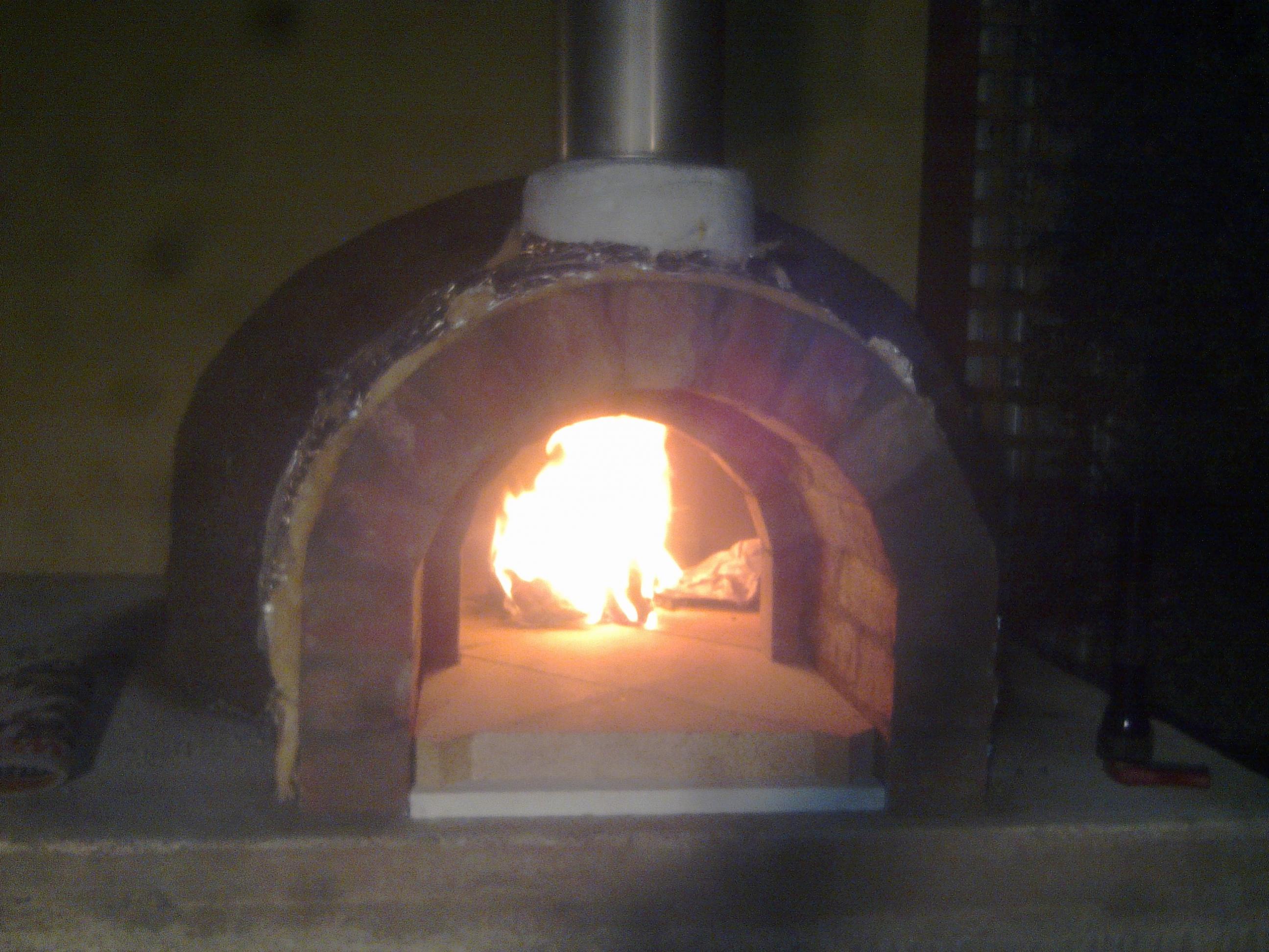

    Is that fibreglass insulation in pic two?
    It hardly works as an insulator compared to ceramic fibre.

      I used it for my first oven and found it worked ok but it is way less dense than ceramic fibre blanket and tends to compress which reduces it's efficiency.

      I would try making the outer shell waterproof before glueing on the marble.

        Hi brickie , and David, thanks for replies, the silver blanket is only over front arch as a skin between bricks and render to try to stop any cracking.I used solid reds for dome and covered it with 30 mm ceramic blanket, chicken wire and then, about 30-40 mm 10:1, vermiculite: cement. Once it was completely dry I applied the render with fiberglass Strands troweled in at the end. I'm tempted to leave the render as is if anyone reckons it'll stop the rain seeping in. I rang around today, to see if I could use a sealer over render, but they couldn't guarantee my marble would be ok to glue over the top. Has anyone used a sealer and then glued over?

          If you use an acrylic waterproofer then use an outdoor acrylic tile adhesive the two should bond ok.I prefer an acrylic adhesive because I think it has more elasticity than a cement based adhesive. The temp for the acrylic is not an issue because the outer shell never gets too hot.

            Thanks David , sounds like you may have saved me from another coat of render!
