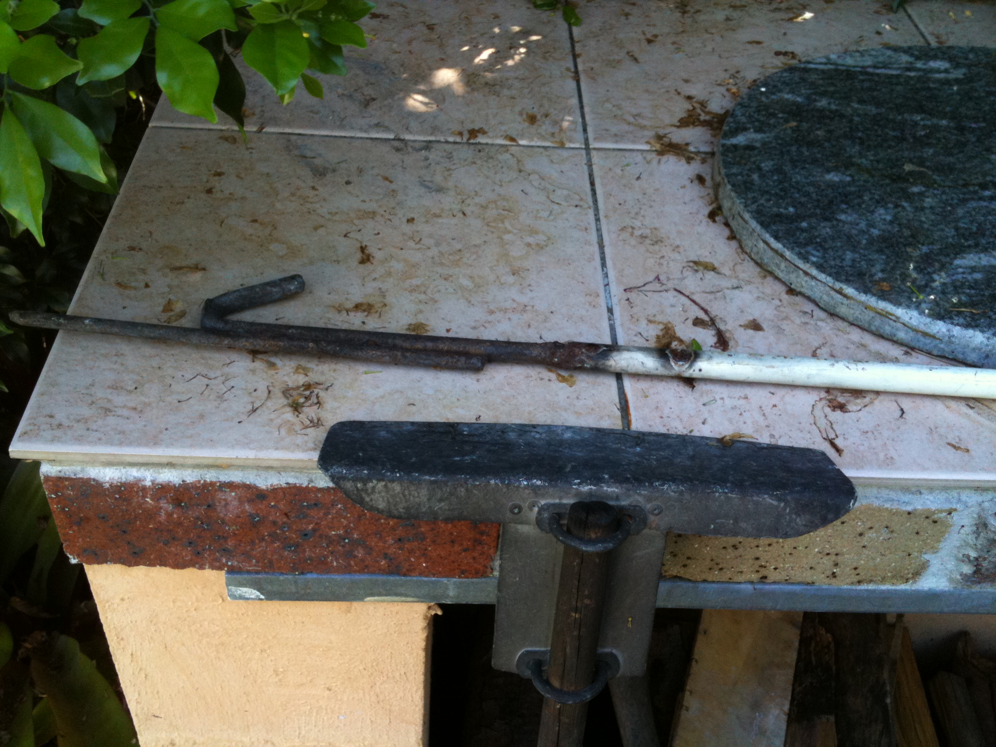

                              Gudday
                              find attach photo of poker and rake battered and tattered but unburnt
Name:	poker and pusher.jpg
                              Have to admit now that I think about it that I burn't mk 1 oven brush to a cinder by leaving it in the entrance for to long
                              Try the poker its easy to make just a tent peg attached to the end of a metal curtain rod ( not my idea got it off the forum)
                              Regards Dave
