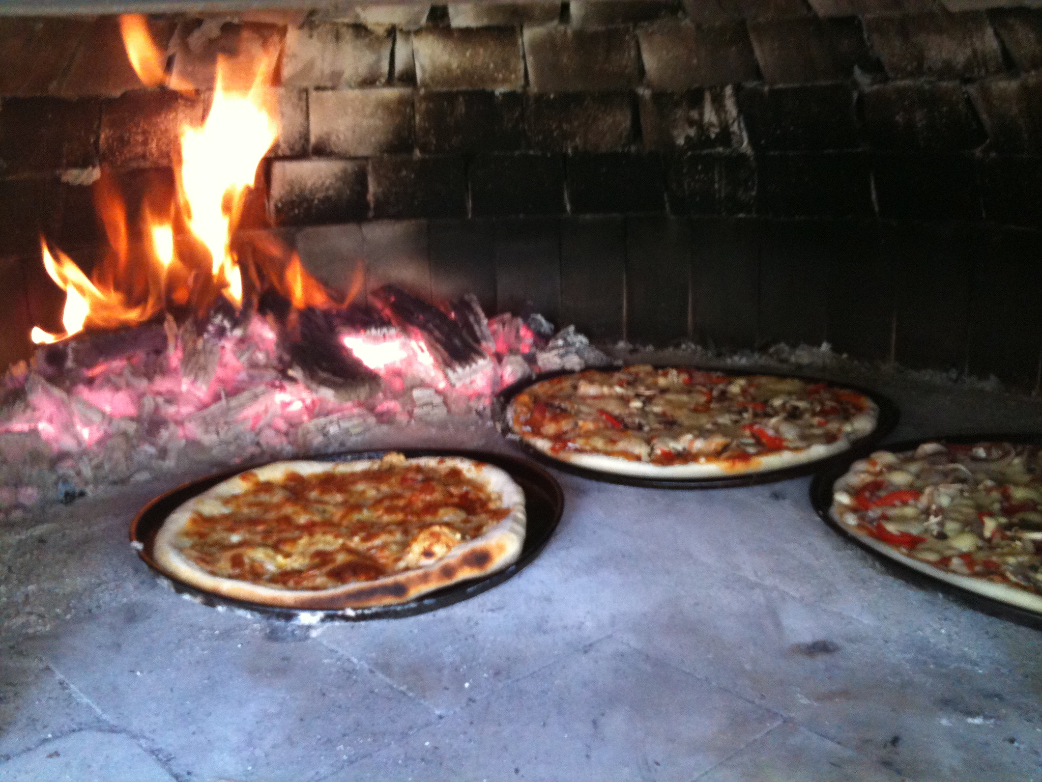

    I built with brick bulster and angle grinder and I have heaps of gaps. I was worried about it once and crawled in the oven and tried to fill in a small section. The mortar fell out and I stopped worrying about it. That was 2 years and heaps of pizza and roasts later.
Name:	3 pizza.jpg
    Old pic but shows the gaps also wet wood, soaked oven, and pizza on trays brought down from the kichen due to rain

      Thanks CobblerDave. Your pictures and input are very much appreciated. I plan to continue without filling the inner dome gaps.
