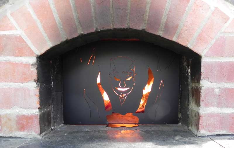

                  I think I was in with the first group on the forum to try a blast door so you are preaching to the converted.
                  Here is a pic of my second blast door.

                    Re: Protection on finished oven
                    Just be aware that the use of either forced air induction, like a hair dryer, or a "blast door" bring the combustion chamber to ideal atmosphere, so if there is plenty of fuel there the temperature climbs extremely fast. A rate of around 400C/ hr places enormous strain on the refractory because of the uneven expansion. If you want to be kind to your refractory allow a slower rise.
