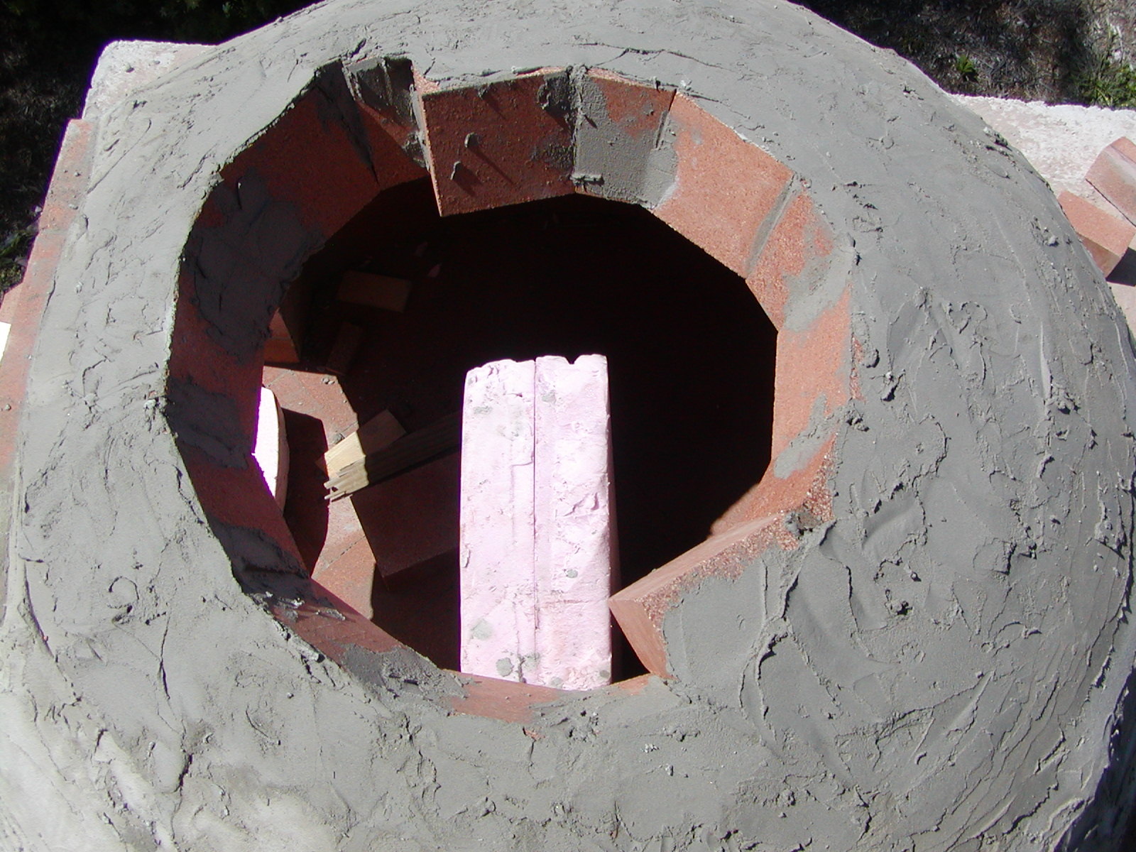

            This is what I used a while back. Two pieces of 2" rigid foam insulation board, screwed together. It took about 10 minutes to make.
Name:	top course form(8).jpg
