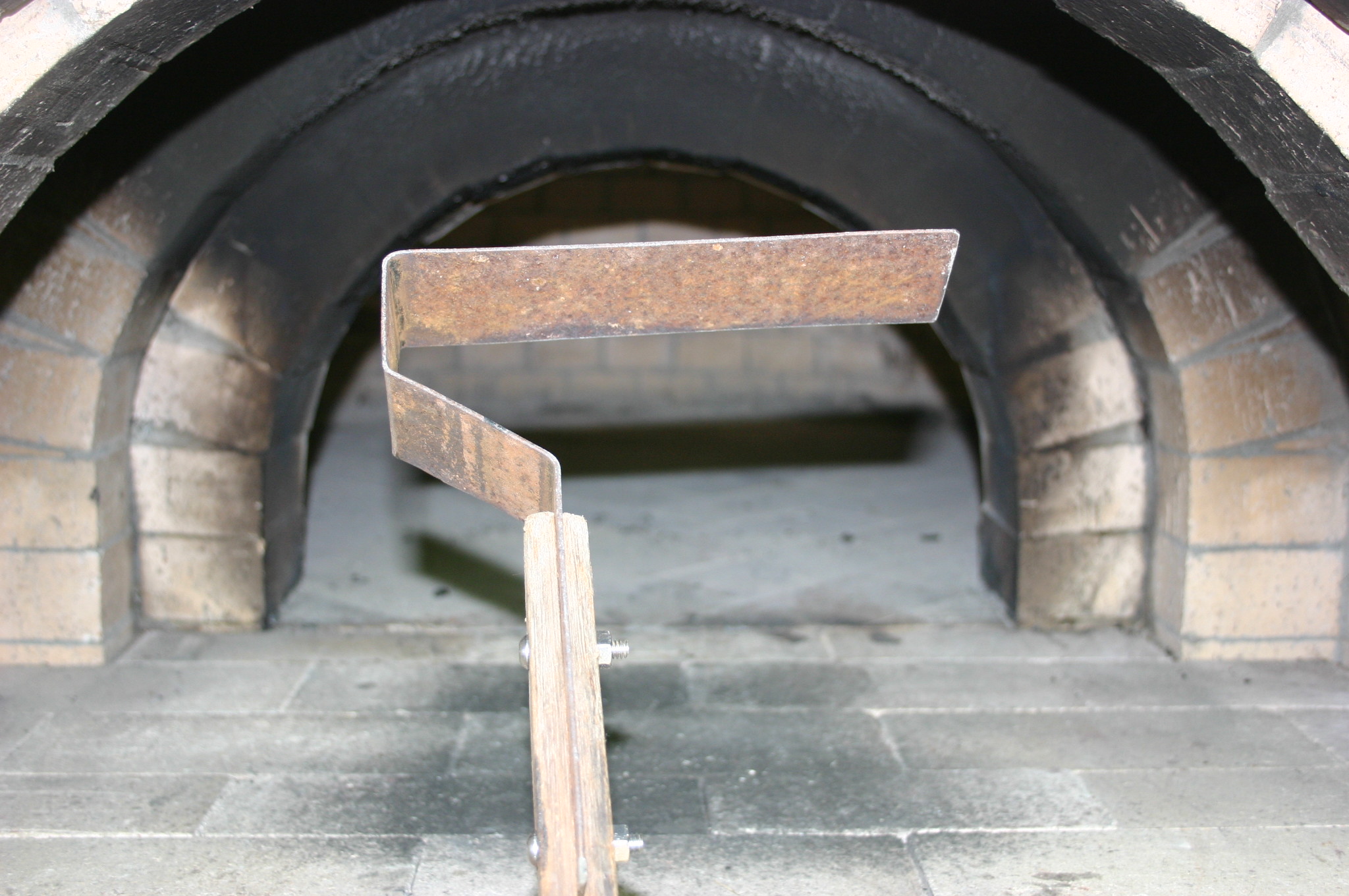

                      Re: Rooker - what was old is now new
                      Navyintel,
                      I finally got around to throwing one together this morning.
                      It is a little wider bladed than usual. I went out to my cold and presumably "clean" oven to try it out. I easily raked out another 5 or 6 tablespoons of ash hiding in the corners. The shape of these things make it much easier to rake the very back. The hoe I was using did not get to that area real well. It is also much easier to rake the blind spots just the sides of the arch. The rooker is a great little tool and, very easy to build.
                      Thanks for the idea .
