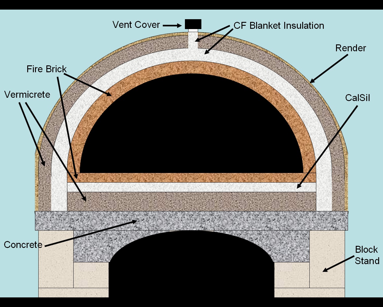

    Maybe a picture will help . This is a cross section of my oven.

        The chicken wire goes over the ceramic fibre blanket and helps hold the vermicrete/perlcrete. That material is 'different' to manage but there is plenty about that on here. I used the 'smear and leave' method and returned to add more as required.
        The insulation board is usually calsil or equivalent or 4 inches of vermicrete.
        Cheers ......... Steve

          Yes, perlite and vermiculite are both acceptable. In my case "Vermicrete", was made on site using vermiculite and portland cement. I am not sure by your meaning of "board"? There are factory made "boards" for each that use different binders, than portland cement.

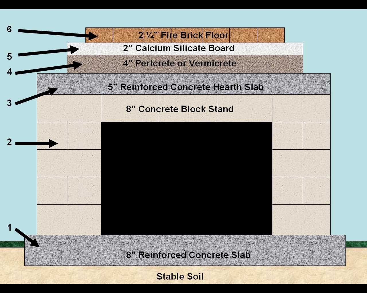

                  Here are the first steps. It is a very basic drawing. It is not drawn to scale and I have tried to simplify my origional plans.

                  You asked "what the levels" were. I hope that this can get you started. I will add more basic steps later.
                  You asked what is the best insulation. My answer to that is the best that is easily obtainable, and affordable for you.
                  My oven holds the heat very well.
                  At this point, you need to let us know what is the primary purpose for your oven? If it is for multiple batches of bread, you may want a thicker brick floor than I have shown.
