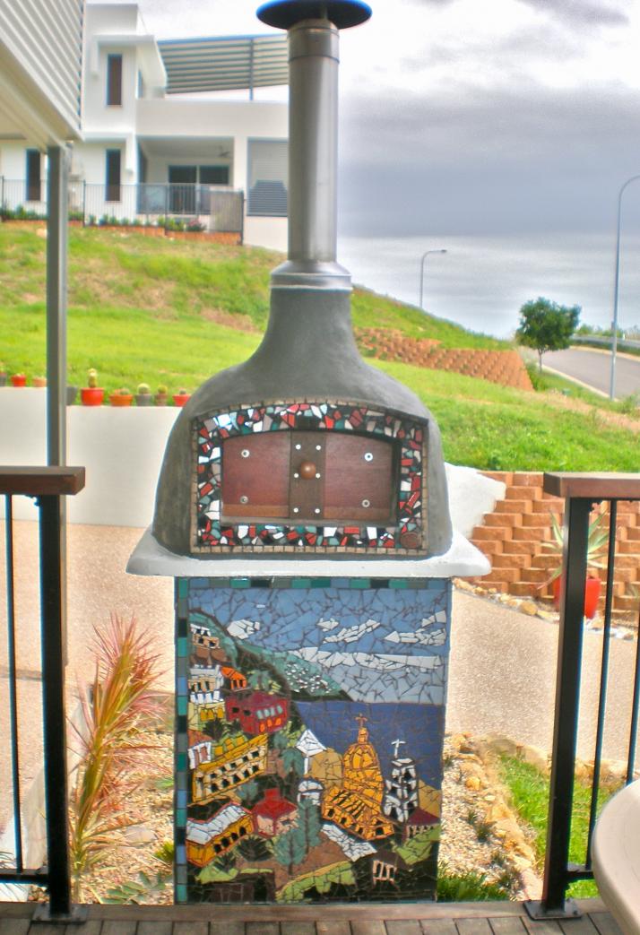

            After 50 years as a licensed builder, I am of the firm opinion that there is no timber deck suitable to support a WFO constructed of brick or cast. If you want a WFO located within your deck you will have to trim out the area and install footings into the ground below. If you want a pizza oven on the deck buy a small BBQ type that is fully portable.
              My 21" cast ovens weigh 250 kgs incl supporting slab, (but not the steel stand). which is equivalent to a couple of really fat blokes standing together having a drink on the deck. Provided the stand spans two bearers the safety factor should be plenty, but anything much bigger will be a lot heavier as the maths increases the volume/weight really fast as you get bigger.

                most timber decks are designed for a live load of 1.5 Kpa or about 150 Kg per sq mtr. that said a permanent fixed load of 250kg will result in long term excessive deflection in the floor, locating the load directly over a bearer that is at the support to the joists will reduce the problem, a point load cause up to twice the deflection of a distributed load., regardless 250 Kg should be considered the maximum
