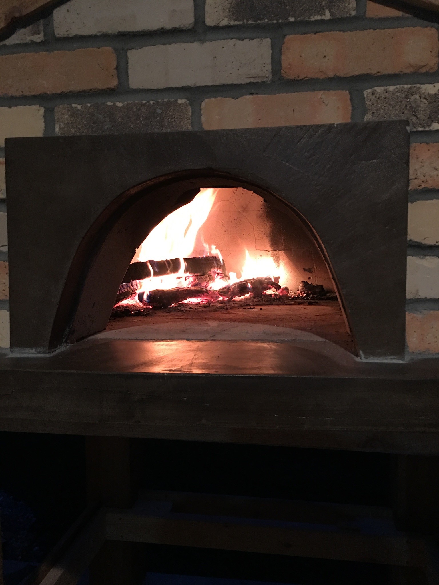

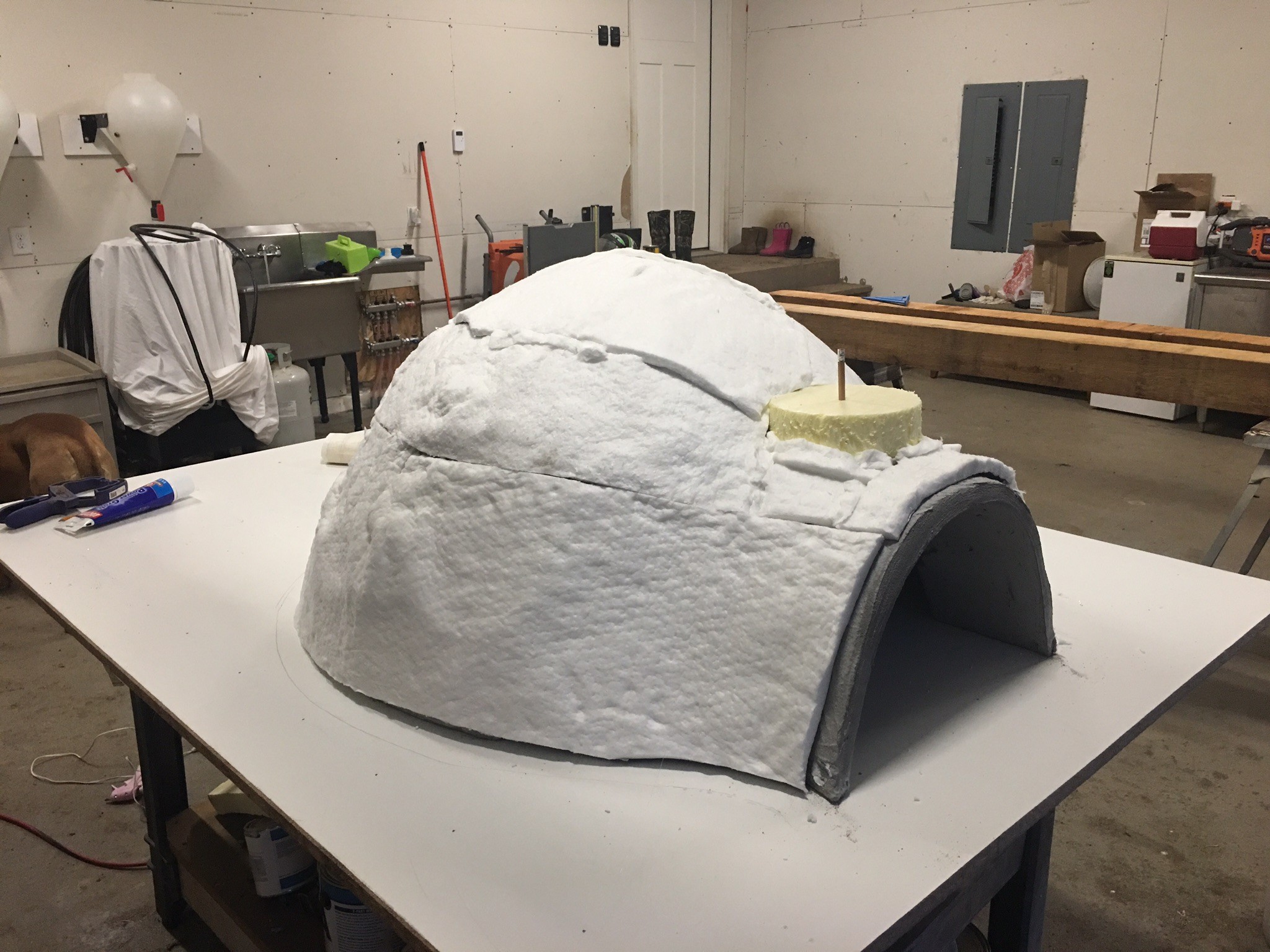

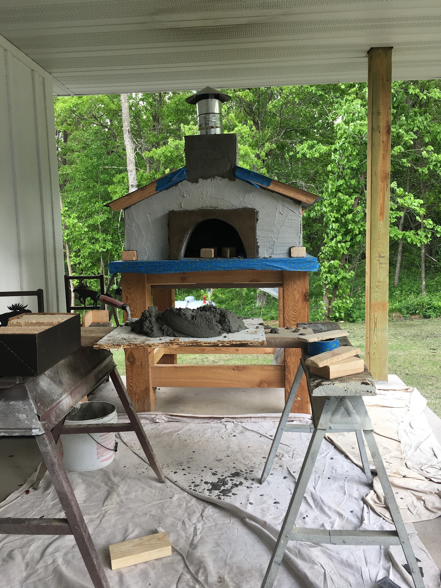

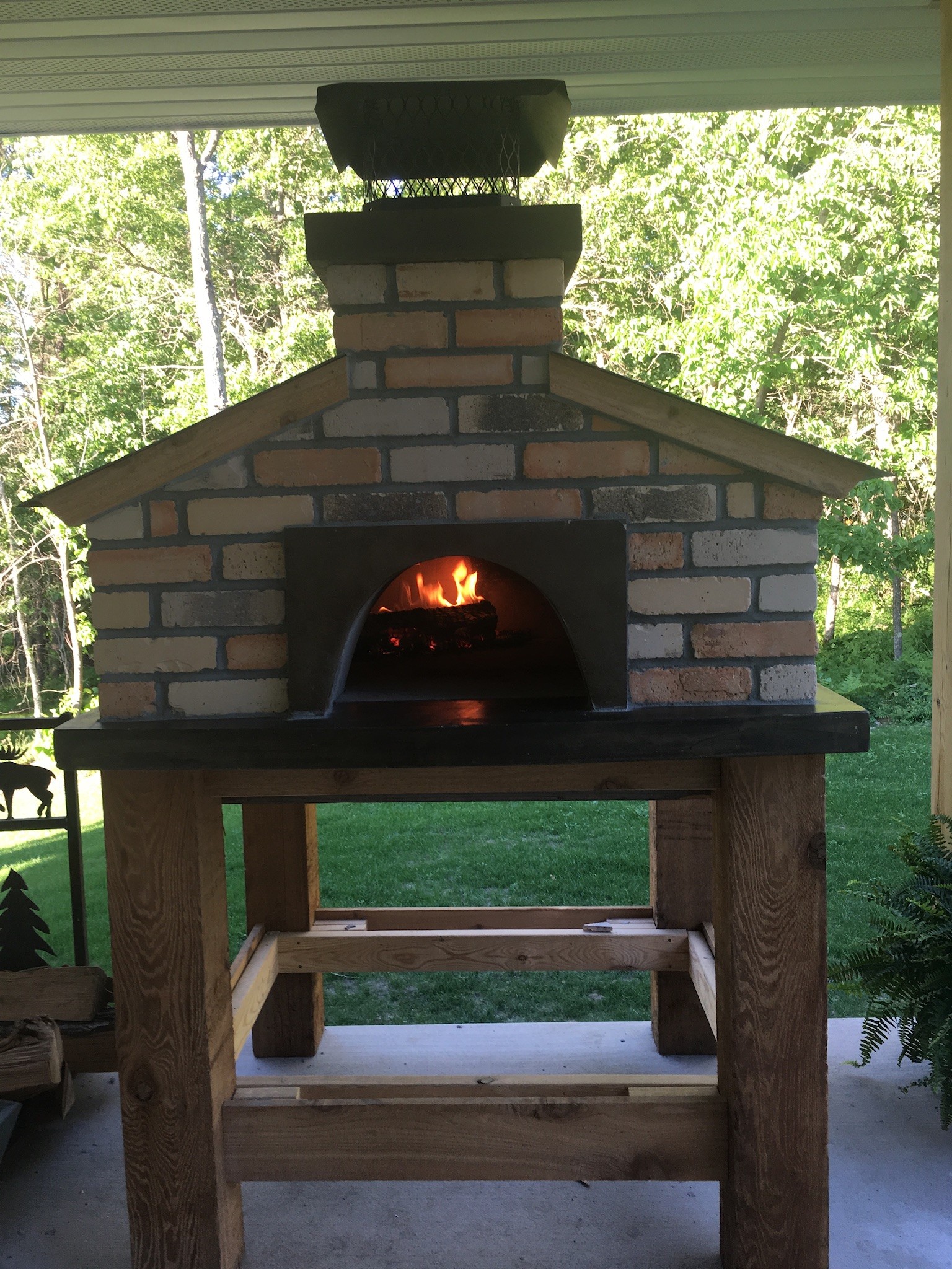

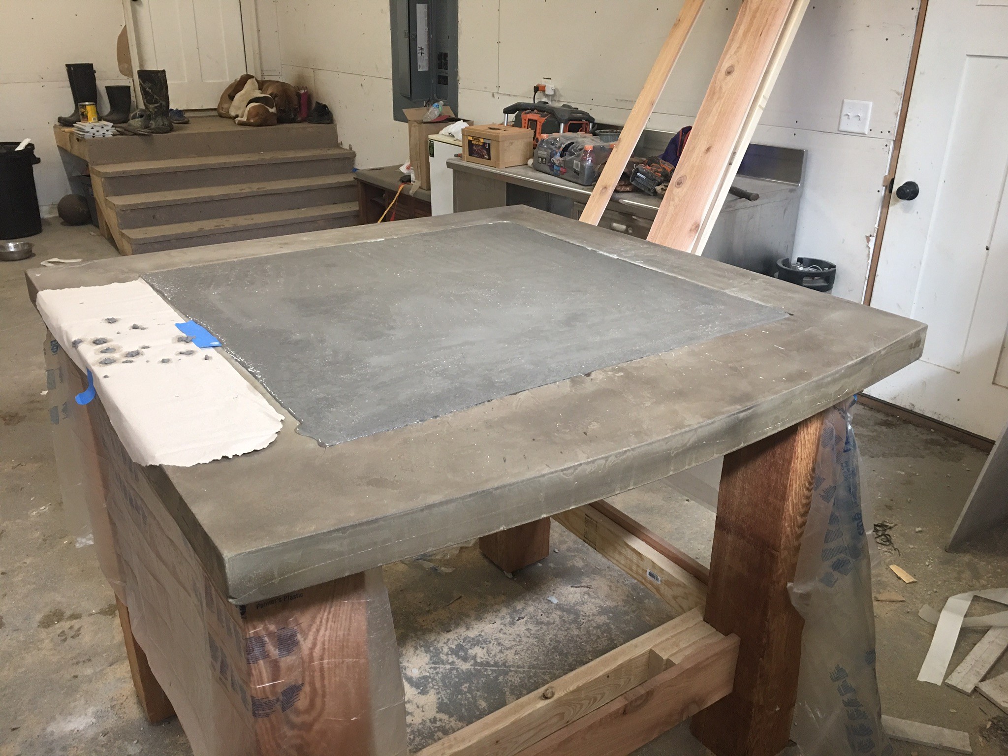

    I am embarking on my 2nd cast oven build. I will include some pics of my first oven that stayed with our house we sold. This will be my first try at a home brew mix. My main question is, is there a link to a mix recipe in Lb’s anywhere? As far as the 3:1:1:1 goes is that weight or volume? I definitely wish I would have found this site before I built my first oven. That being said I did get to use it for 6 years and enjoyed every minute of it. I’m looking forward to this new build and will be posting pics along the way.
