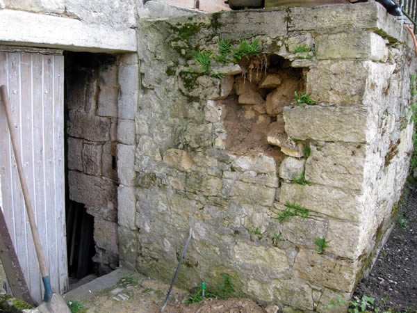

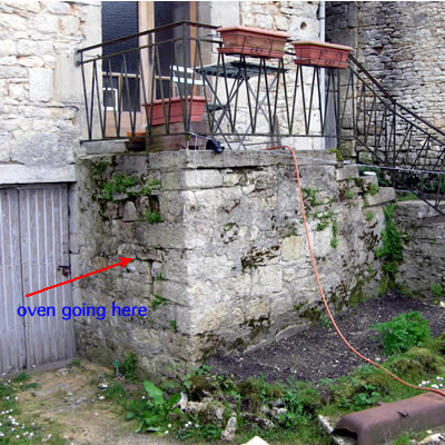

    I'm going to install my oven within some outside stone steps of my old stone house, but I'm concerned about the oven being damp.
    I don't really want to encapsulate the whole thing in a sort of waterproof bubble as I'm worried about condensation, though I may be wrong - any ideas on this?

      Yes, I'm worried about dampness after the construction as the oven is going to be built inside a large block of basically (and ironically!) dry stone walling (see attachments above)... I've never found these to be dry within!

          see if these work Click image for larger version
