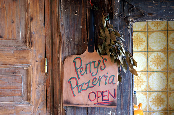

                            Here's my pizza peel made from thin marine plywood with an ebony/ purnambuco handle - it's short because I only use it with my domestic wood fired oven/ pizza stone. It doubles as a sign which I hang on my front door whenever friends come over for pizza!
