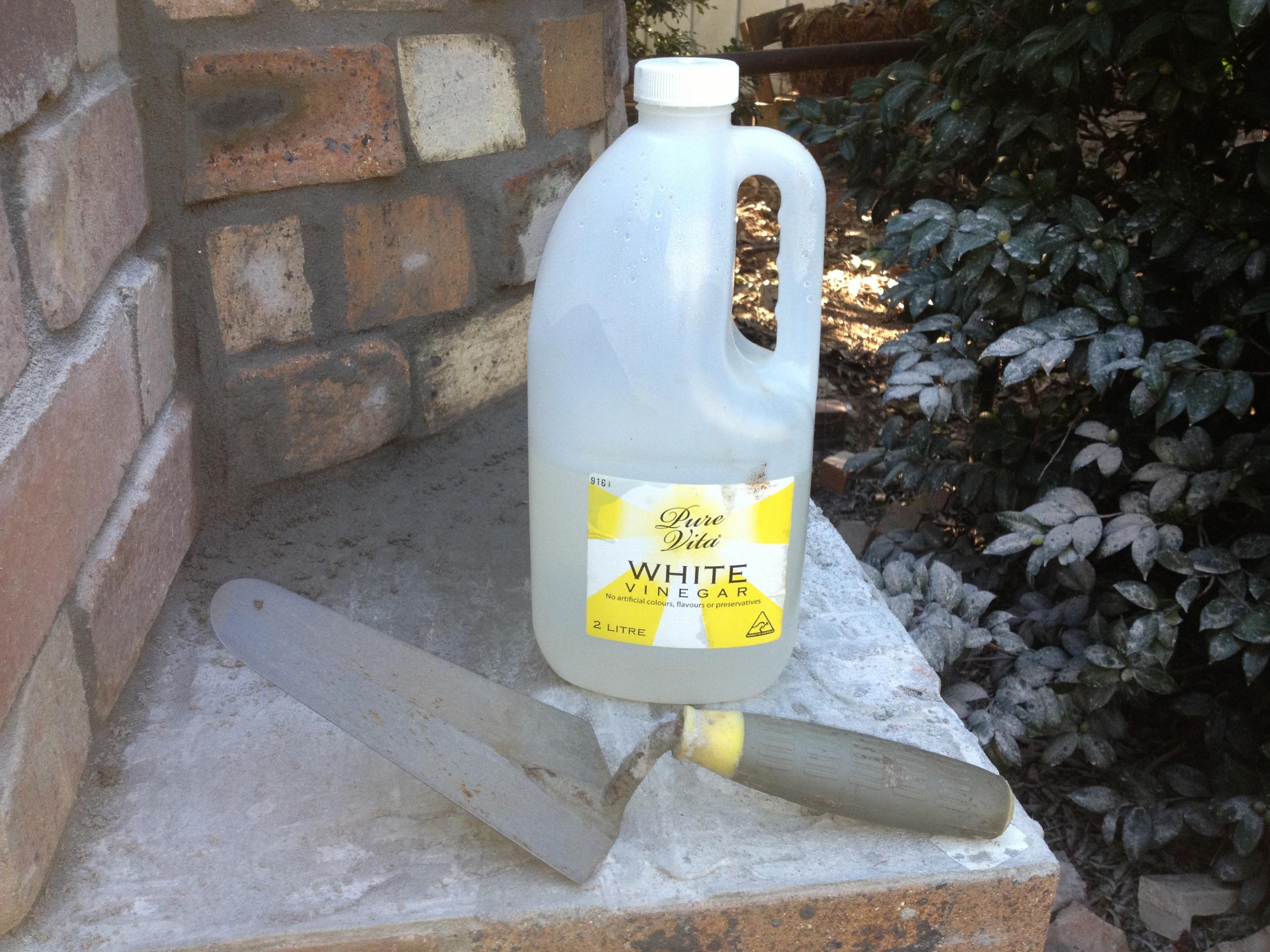

    CB, I am not saying this with the intent to correct you, but that trowel you have is called a gauging trowel....normally used for plaster. I'm sure you will find the rounded tip helpful when working out a bucket.
    No problems.....I learned something ......that's always a good thing

    2 great ideas. I wish I new about the vinegar. Didn't seem to matter whether wearing rubber gloves, leather or no gloves, your skin still seems to get affected by the mortar. The number of times my skin peeled during the build - and I still don't have soft and supple skin To think women pay a fortune for having layers of skin removed!!!
    Cheers
    Craig
    Let me introduce to you 2 things that have helped me in building my oven. I have to explain I am actually "masonry impaired".
    The first is a pointing trowel it's 1/2 the size of a proper trowel. We're only laying 1/2 bricks so its perfect. The other good thing is the round end is just made for picking up a small piece of mortar to poke into the gape you have missed.
    The secound is ordinary vinegar ... Yep the stuff you can steal out of the wife's pantry. An old Italian bricklayer use to say "fingers are for picking noses not playing with the mortar". You and I both know that doesn't happen. I don't pick my nose! But I have been known to get mortar on my hands. And it stings... Pour the vinegar over your lime stung hands and it takes that sting away( sorry still as rough as sandpaper)
