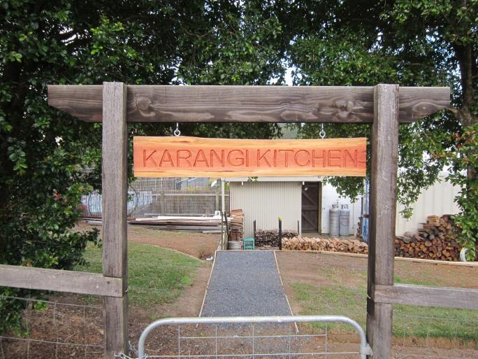

        I had the opportunity to visit a friend last weekend he has a mill and apart from getting plenty of wood for the WFO I was in the hunt for a slab of timber that I could use for a sign to hang up at our side entrance carpark.
        When we have lots of guests or when I run my cooking class / workshops people park at our side entrance so I wanted a sign to say that they are at the right place.
        I was lucky and found a great piece of Grey Gum a beautiful and multi coloured timber.
        So after some planing, sanding, routing, varnishing, drilling and hanging we now have a great new sign.

          The end result
          Click image for larger version  Name:	IMG_0511.jpeg Views:	2 Size:	87.1 KB ID:	397943

            That is really cool. Your spread downunder must be the equivalent of the US SouthFork for the old TV show Dallas.......Nice touch to a welcome to the Karangi Gourmet Kitchen!
