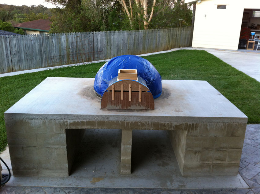

          Hi fellow Pizzaioli, here is an update to my build, I have formed the dome and started on the entrance formwork. next will be the dome cast, any suggestions as to what i can add to the ciment fondue and crusher dust mix to make it less prone to cracking?
          Cobbler dave suggested stainless steel needles????
            Re: First time oven build
            Stainless steel fibres add 2% by weight. Try Antec Engineering. The real name is melt extract fibres.
              hi Guys these are the latest images of the progress[ATTACH][ATTACH][ATTACH][ATTACH][ATTACH]Click image for larger version
                  I have not cast the dome yet. what you see is the sand and plasterboard mould.
                  I will make the dome 4 inch thick then 3 inch of insulation then 3 inch of perlite then 1 inch of render then tiles

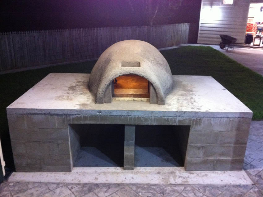

                              Ok friends we have an oven, next the fire blanket andy chimneyClick image for larger version
