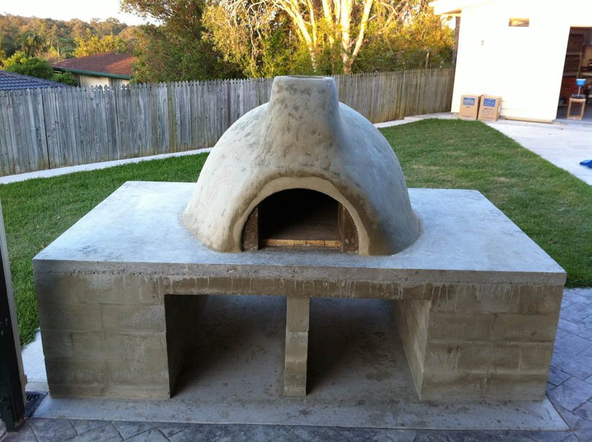

            • #21
              Re: First time oven build
              Hi Fellow Pizzaioli of the world, viva la pizza
              The dome and insulating fire blanket and perlite layer is sitting partly on the fire board and partly on the concrete slab ski i think I have enough insulation not to loose too much heat through .
              It is now finished rendered and has been drying in 30+ heat for 2 days.
              I will leave it for a full 2 weeks to dry.
              I am pretty happy with the result, the total wall thickness is a full 12 inches from inside to outside and i can't wait to cook in it.
              here is the finished image, there is still the finishing touches of the bench tops and block rendering to go, but we can do that between pizzas.Click image for larger version

                • #23
                  Megapulse,
                  As it has been less than a week since you finished your inner 110 mm thick casting and you've also added a perlcrete layer then rendered it over without waiting for the sun and wind to help dry it, you have locked in a lot of moisture. Remember that for every 100 L of perlite used you have probably added around 35 L water. This now has to find its way out your outer shell in addition to the water locked in the centre of the inner dome casting. It is difficult to wait but you must take it slow to prevent cracks and blowing. If I were in your position I'd be drilling a number of small holes in the outer shell to release steam,you can always easily plug them up once your oven is properly dry.
                  • #24
                    Hope the render wasnt waterproof. You cant push steam through it. You must always dry a WFO out before you render.

                          • #28
                            Finally the finished product and it works great
