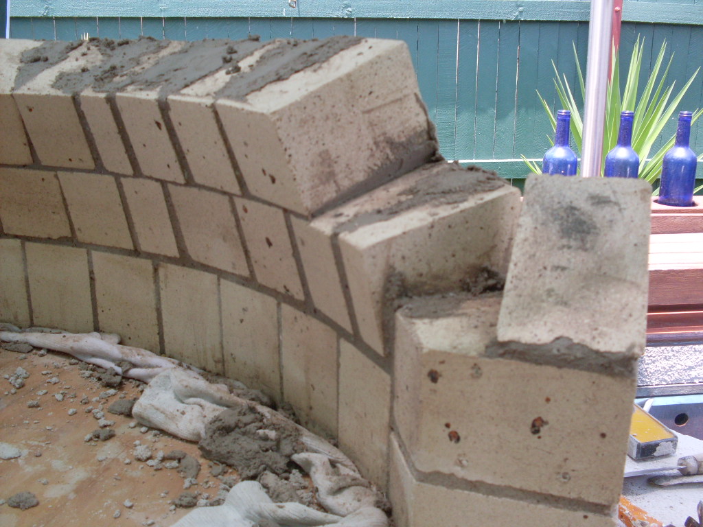

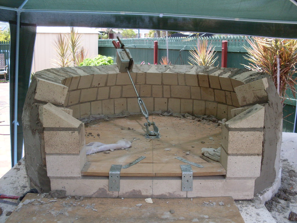

                    Just completed the third course. Everything is going along smoothly. Made a couple of mistakes lining up the bricks but just have to put that down to the heat and humidity. In fact I had to go and get a small gazebo to put over the top when I'm working Click image for larger version

                      Re: Camo's new 36" build Brisbane
                      Started on the arch as well - made a template out of ply which should do the job nicely.
                        It looks like from the pics that you will end up with a teardrop oven rather than a dome as your arch is too far forward.
                            Yes Brickie, bit of a f*** up there. I actually changed the way I was going to cut the bricks for the arch on a whim without thinking from a width of 115 to 75 so I am out 40mm on the dome. So I had to use the old eyeometer to hook it into the arch. Anyway after a bit of a holiday over Christmas I have got back into it and here are some pics. It didn't work out that bad and I will slowly bring the front brinks in the dome a little forward as I go up.
                              I actually finished the dome and transition today so here is the finished product. Brickwork is a bit crappy but ...
                                Too late I suppose, but all them great globs of mortar in the oven will fall off as the oven is heated, hopefully not in your food.
