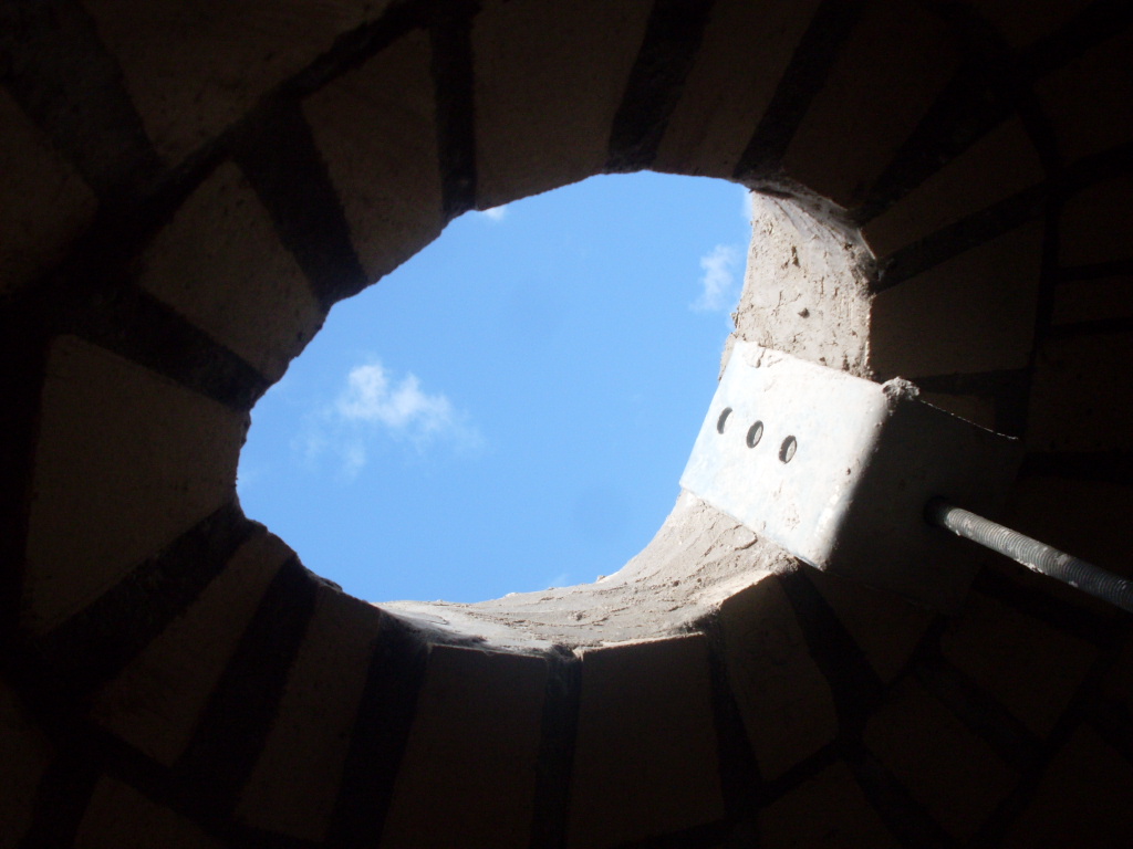

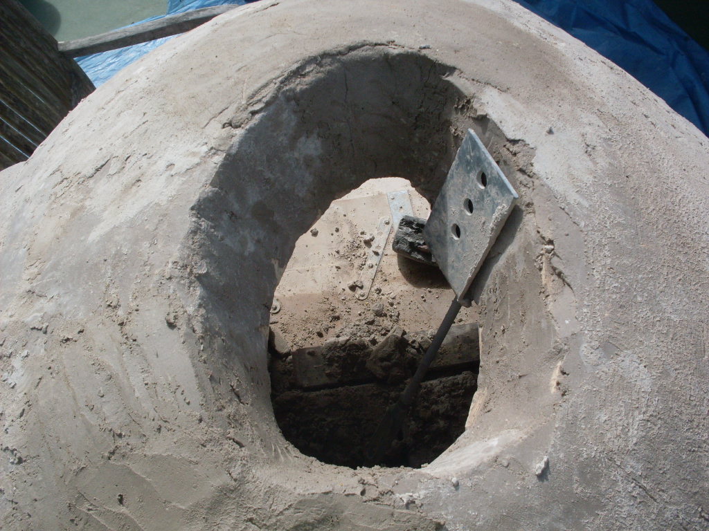

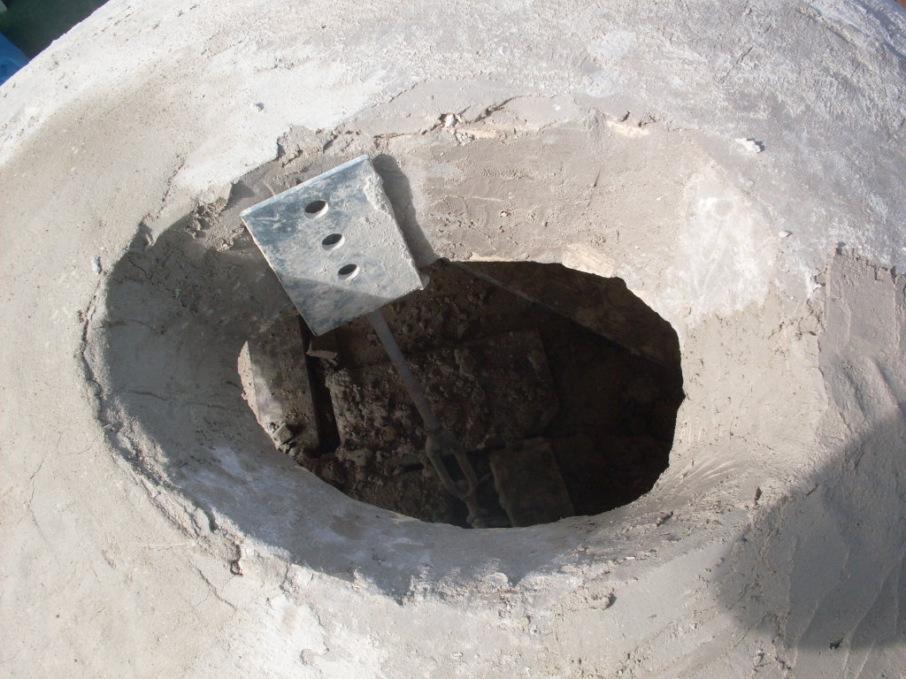

                    8th course done. As you can see by the photos below and the stuff up I made by turning the bricks on the door arch I now have a "teardrop" hole to close. The dimensions are 160mm wide by 250 long. So now what are my options ??
                    Really the only thing I can do is shape a couple of bricks putting them at the pointy end and make a 160 dia circle to close or ............
                    Any other suggestions ????

                      I Would Cut Brick Narrow End To Reform The Circle As You Have Said Or You could Use A Castable Plug If You Aren't Phased By How It Looks From Outside Of The OVen Not That IWould Stick My Head In.

                        I also had a bit of "asymmetry" when I completed my bridge over the arch. My teardrop was not quite as elongated as yours but with a few "fancy cuts" I was able to bring it pretty close to round before closing it off.
                        Unfortunately I didn't take any pictures of this, but if I remember correctly, I cut a cardboard template to provide the shape I needed to bring me back to round. By carefully trimming some bricks I created a crescent moon shaped "semi course" that fit my template and got me pretty close.
                        I made my "adjustment" on the 8th or 9th course of a 42" build, so I think my "semi course" was made in 2 or 3 pieces. Looks like you could do it with one.
                        Or you could go with the semi circular/egg shaped closure. There is nothing wrong with that and there is no rule that says all your courses have to be the same thickness. That is, you can cut your bricks to 1/2 thickness if that gives you a little more flexibility to size your keystone or final slug. You could even size it to fit a whole brick (rounded on the edges of course), but that takes some work. Believe me I know, I used a 10" diameter slug to close off my dome and it took almost 3 hours of shaping and trimming to get it right.
                        I'm sure you'll figure it out. It's pretty hard to get your head inside to look at it once your build is done anyway so I wouldn't worry about the aesthetics too much. "Out of sight out of mind" as they say. Make sure you post some pictures of your solution...you know we all love the pictures...especially closing the dome...it's a great feeling when it's done.

                          How do you get a teardrop shape using a jig that is fixed in the middle of the oven is what Id like to know?

                            Well I decided to bring back the opening to a circle and here are the results. Looks way out of place but as the missus says "who the hell is going to know if they don't put their head inside." I suppose the thing more important is the food we are going to pull out of it. Anyway I can see the finish of the dome which is a huge relief . Will close this afternoon and celebrate with a bottle of bubbly or something
