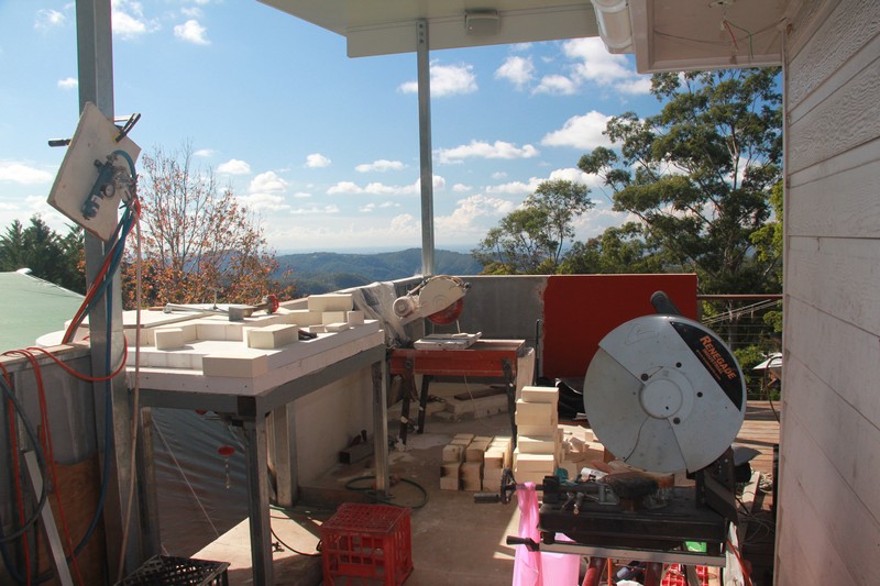

              Decided in the end to pull the old deck down and build a new bigger deck and also to put a roof over the whole thing. Got @ 42m2 of deck now with @ 65m2 of roof which is good as we are on tank water. The deck is L shaped and will be putting an outdoor kitchen along the 8.5m side with an open fireplace in the corner.
              Bought myself a welder and started to melt holes in metal and sometimes actually weld bits together. After a practice run welding up a new chook house and a few other odd jobs about the place decided to start on the deck. Tig welding the SS balustrade was a bit nicer than Mig welding the WFO support, especially the upside down bits .

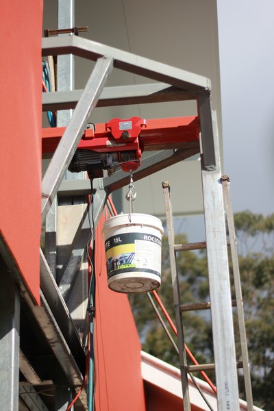

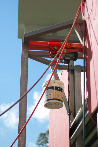

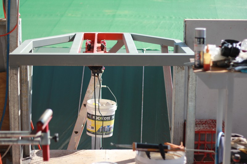

              As the deck is on the first level of the house , and we have an inside fireplace too, I decided to put an electric gantry in to bring up the firewood. Have used it already bringing the firebricks up, heaps easier.

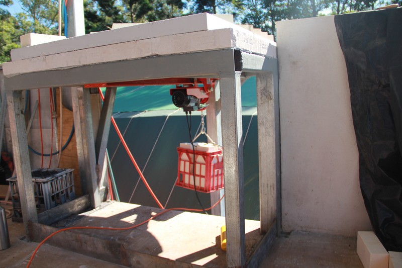

              The base is Hebel 75mm panel . I used hebel adhesive to set down 65mm thick ceramic board and cut out the bricks ( 75mm thick) for the oven floor today.
              The oven will be 1000mm and be finished as a rendered igloo type. To maximize deck space I've built the oven out the side of the deck ( also allowing space for the gantry ) The roof overhangs the deck all the way around and the kitchen side is opposite the normal prevailing weather side as well. )
              Going to Brissy for the weekend with friends to watch the wobblies take on the frogs tomorrow night so no building this weekend.
              Some piccies :

              Frame from in front

              Outside looking from front
              Outside looking from back

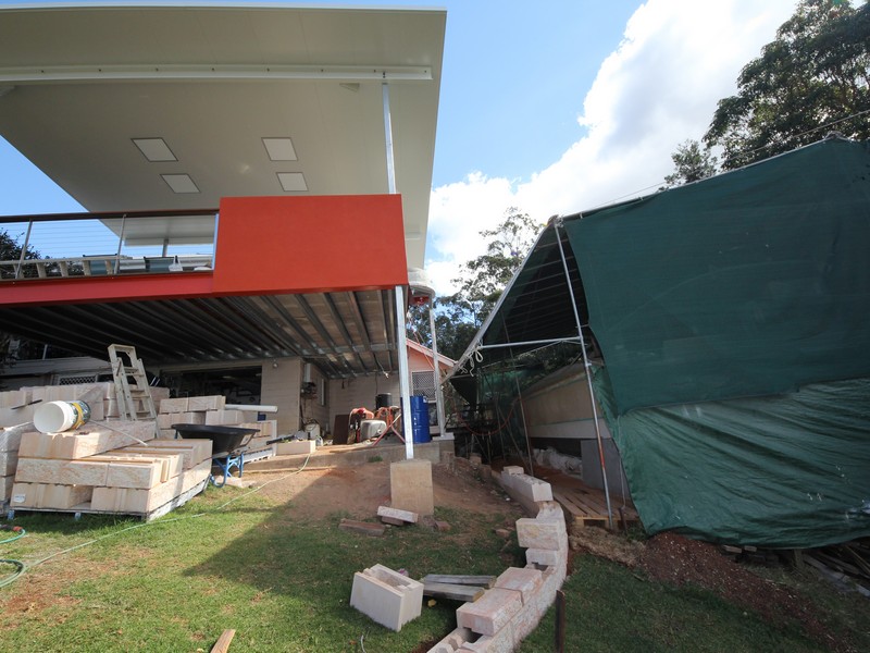

                        As usual have a few projects on the go at once. Building a retaining wall and the big one is the boat (12.5m sailing cat).

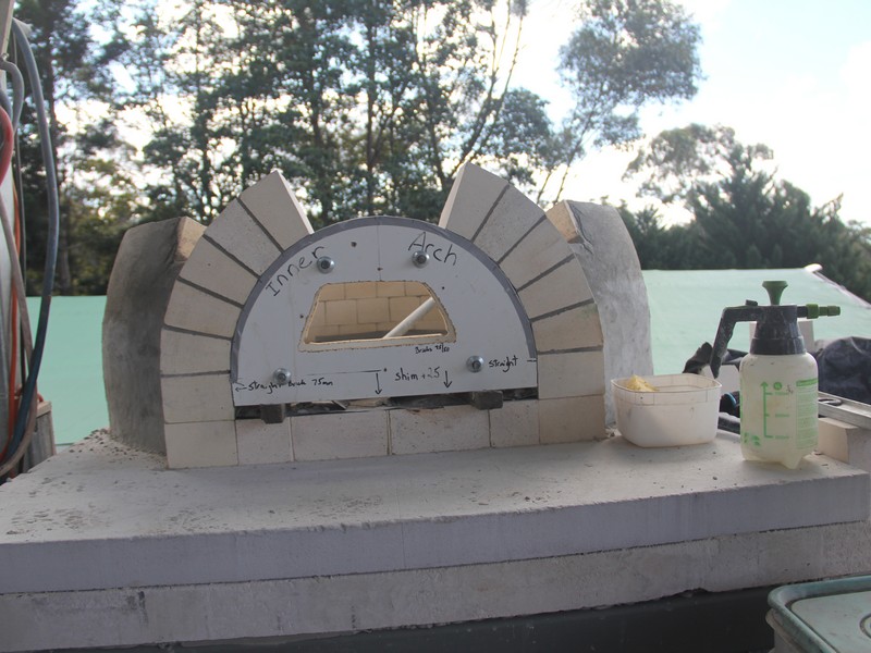

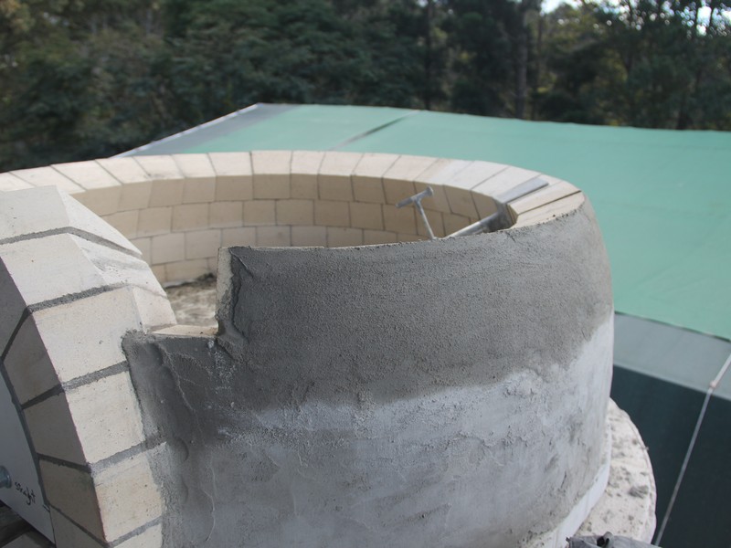

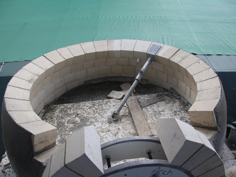

                        Keeping arch just ahead of dome

                        Adding mortar to outside

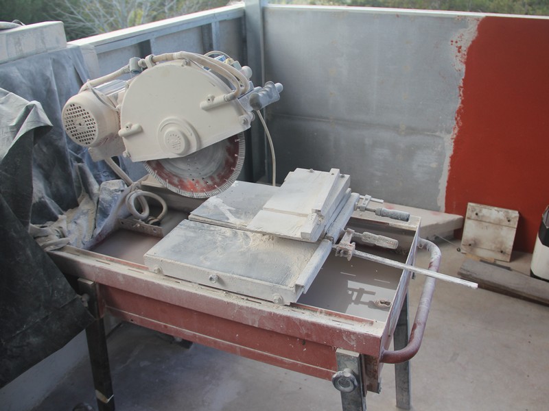

                        Bricksaw with jig

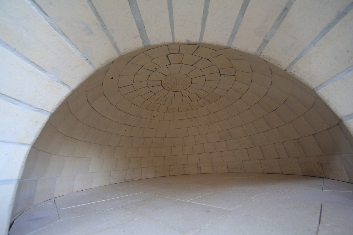

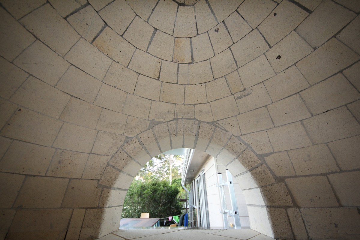

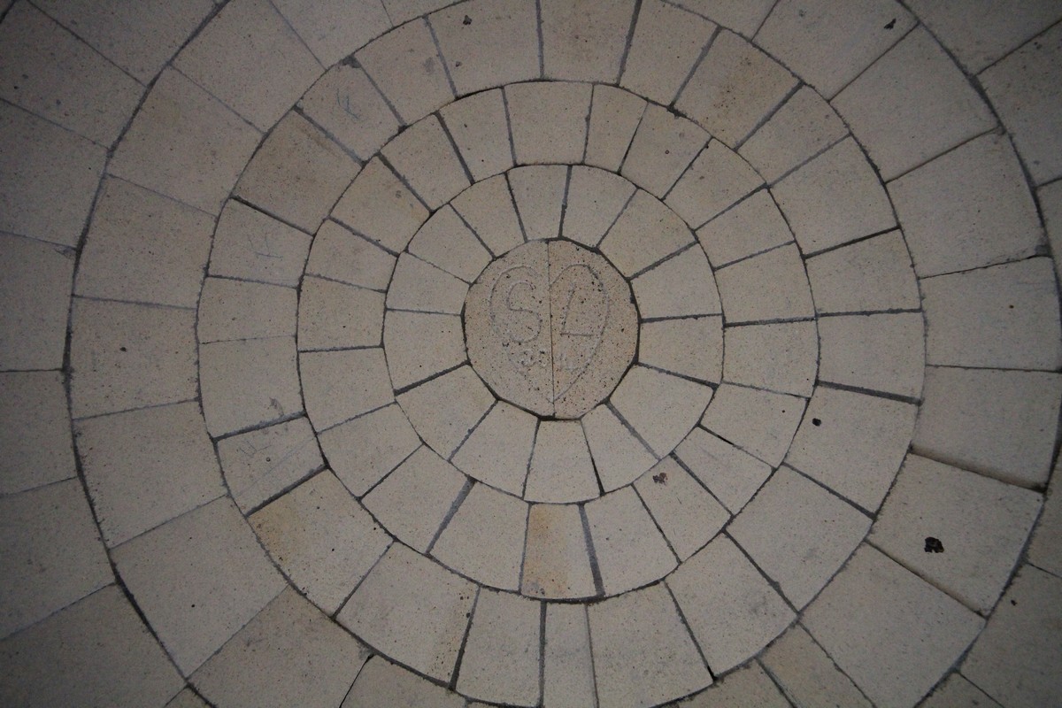

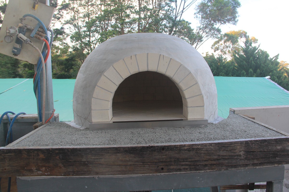

                            Retaining wall done, 30m3 of gravel and crackerdust backfill, still have to concrete yet, but that will have to wait. Herniated disk in my back giving me grief, had a couple of CAT scan guided cortisone injections to help get my leg working.
                            Anyway, dome closed, had wanted minimal mortar joins but as I can't move that well I went the pragmatic approach, I'm sure it will cook just as well.
                            Boxed up and poured some VPcrete ( ain't that weird stuff)so the landing and sides will be level with the floor. Bit of SS SHS as a heat break, cut most of the bottom out of it and filled it with Calsil board. Put a bead of permatex ultracopper along the bottom inside edge of it and set @ 3mm out from oven floor. Remaining gap above will fill with ash. Put the SS in just higher than the floor to help prevent chipping bricks
