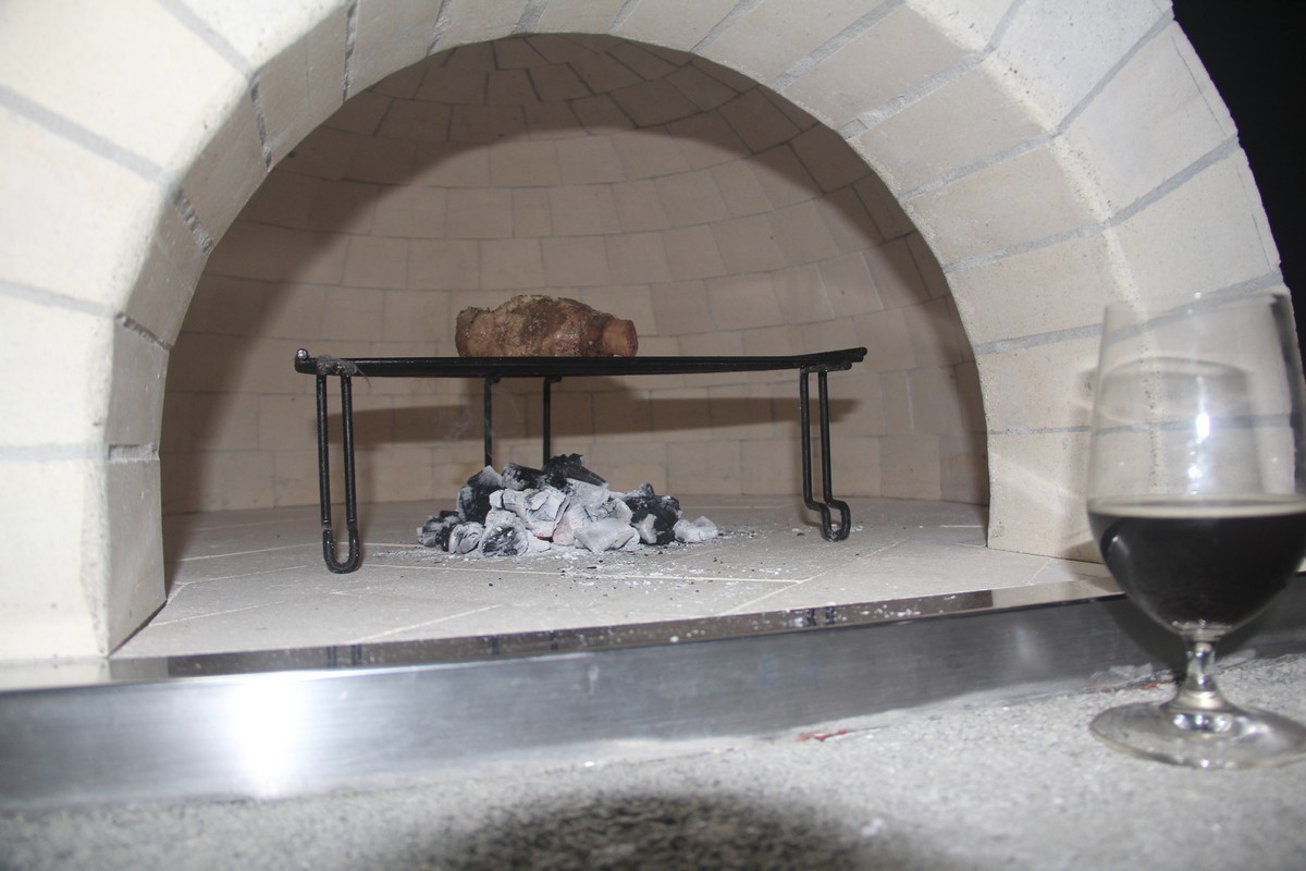

        As the missus went out for lunch yesterday and wasn't that hungry I decided to get the last rib on the bone out of the freezer that I had previously sous-vided and finish it off over some coals in the oven.

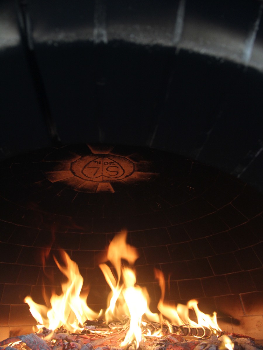

              Got 75mm of blanket over most of oven ( 50mm @ bottom 1/4 ) and started curing with heat beads 3 days ago. Started adding some sticks, then a few more as you do, then a few more. Stuck a temp probe through blanket about 25mm right on top of the dome and temp was 42C which is not far from ambient today ( it's a stinker ) so thought lets add even more sticks. After quite a few sticks the dome started to clear for the first time, which was pretty exciting .
              Hope to get some VPcrete over blanket this week if I get time. Flue should be ready to pick up next week hopefully too. Might try and cook something for dinner tonight in the oven.

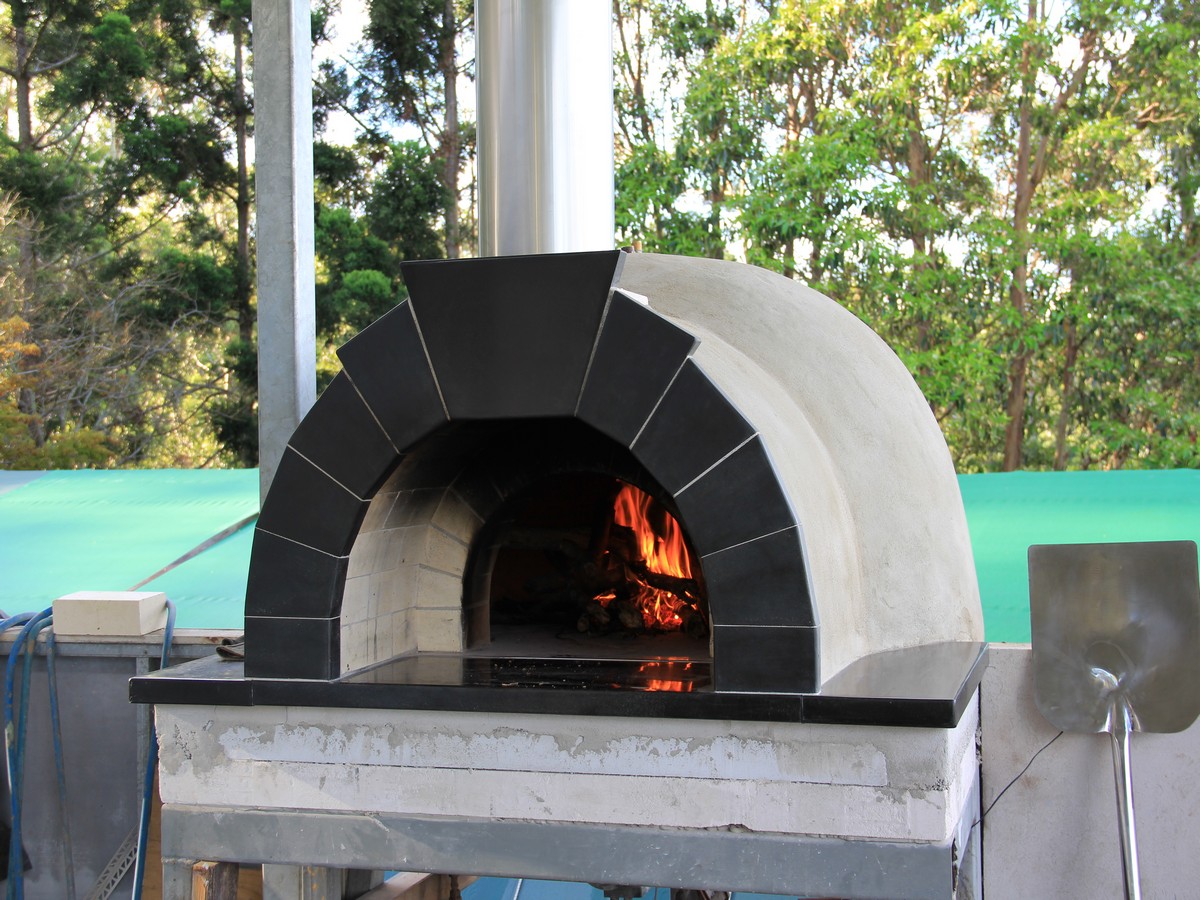

                Got a bit more work on the oven completed, still need to finish rendering the dome and cladding under the oven yet but have had 4 pizza nights so far. Clearing times getting shorter ( one hour on last cook ) and holding temps well.
                Polished up the basalt slabs for hearth and arch facade and pretty happy with how they turned out. Flue works well, tiny bit of smoke escapes with strong wind gusts.

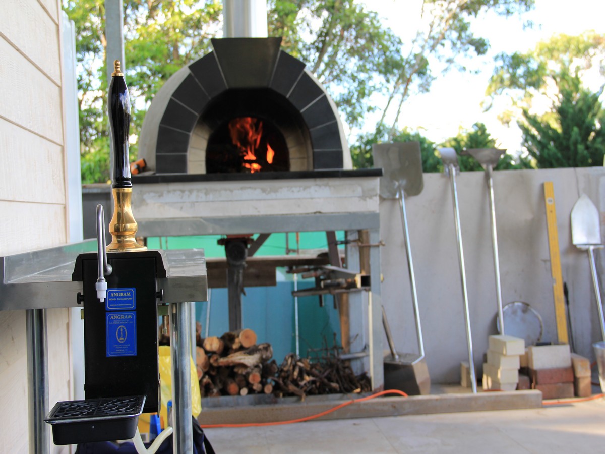

                Setup the beer engine on Xmas day on the end of the pizza prep bench, think it's found a permanent home ! Made some SS tools, a bit rough but bent them with an old wooden mallet so can't expect much, work well though.

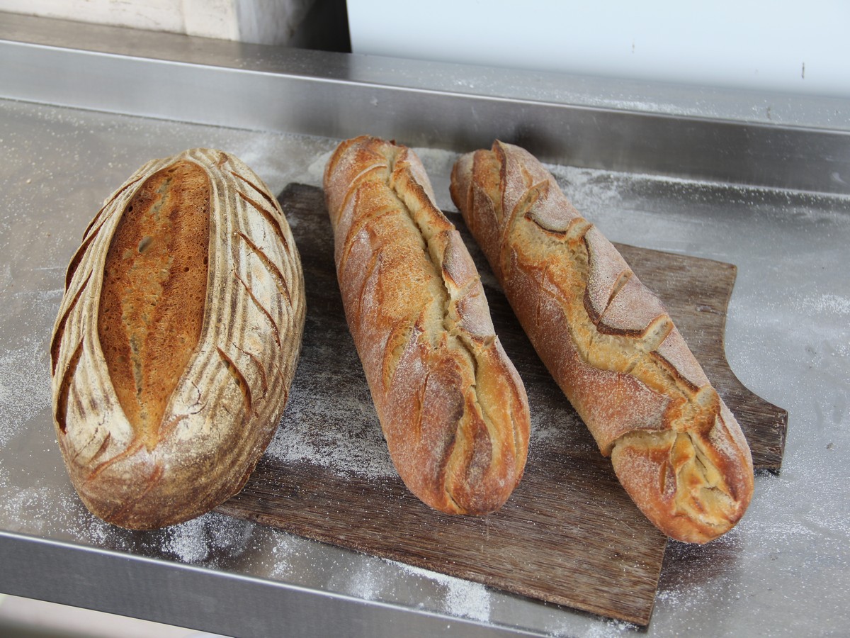

                        Oven is holding temps well, getting a good 3 days cook post pizza.
                        Bake bread most mornings after pizza. Today was 2 sticks from leftover pizza dough and a sourdough loaf.
