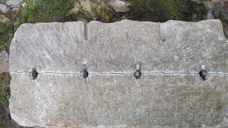

Lancer, I don't know if you can get Feathers and Wedges where you are, but you can make your own if need be....3/4" ( 19 mm?) re-bar or round steel stock for the wedges and steel shims (or round stock cut in half ) for the feathers will work. Here is a sequence using F/W splitting some granite I used for chimney cap supports....
F/W work on the same principle as the method Brickie described, but the shear forces are much,much greater. I split stone with them regularly and describe how on my blog...pm me if you want the link. It is still employed by stone quarries around the world..and it's a blast to do too.
