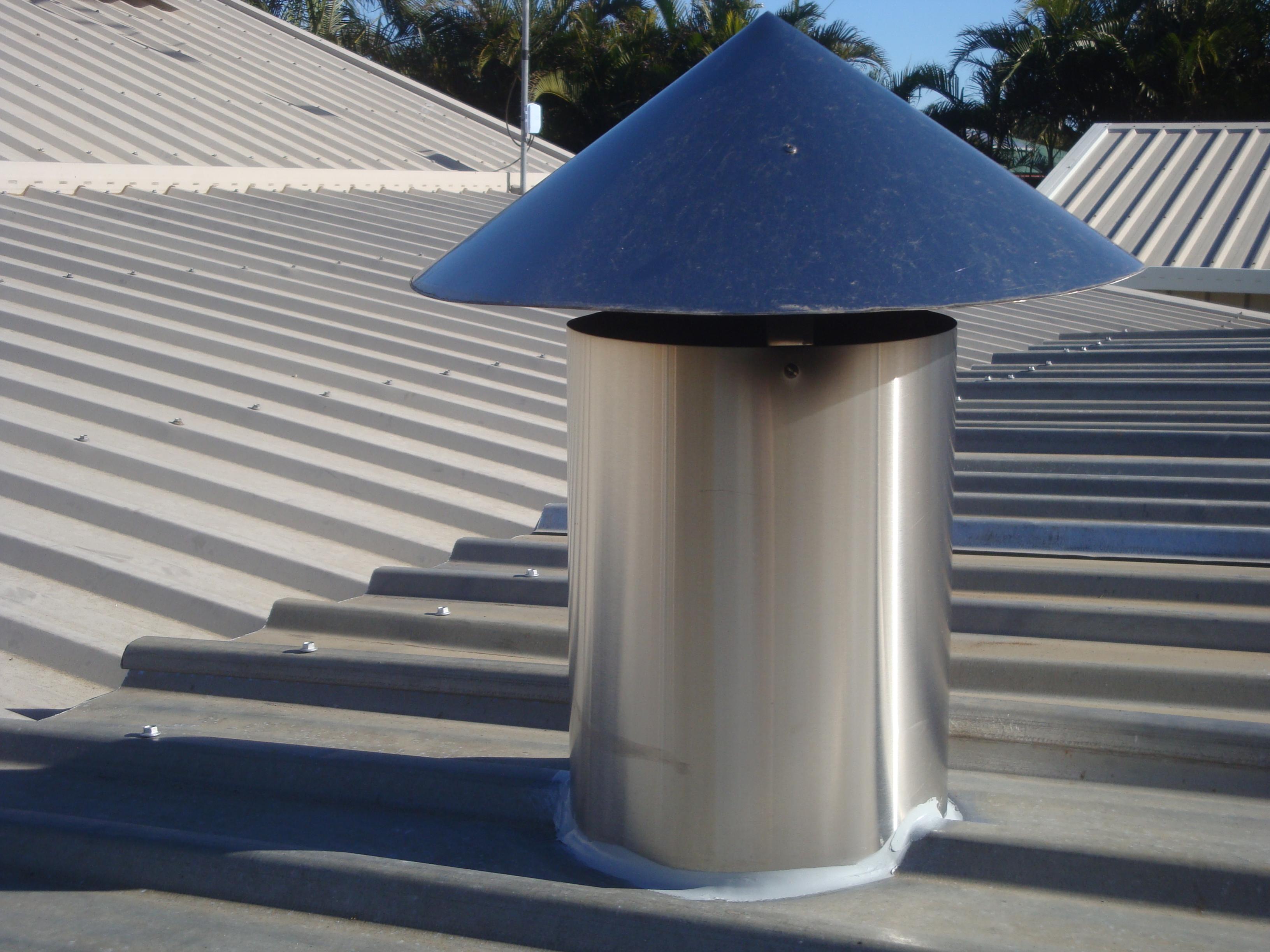

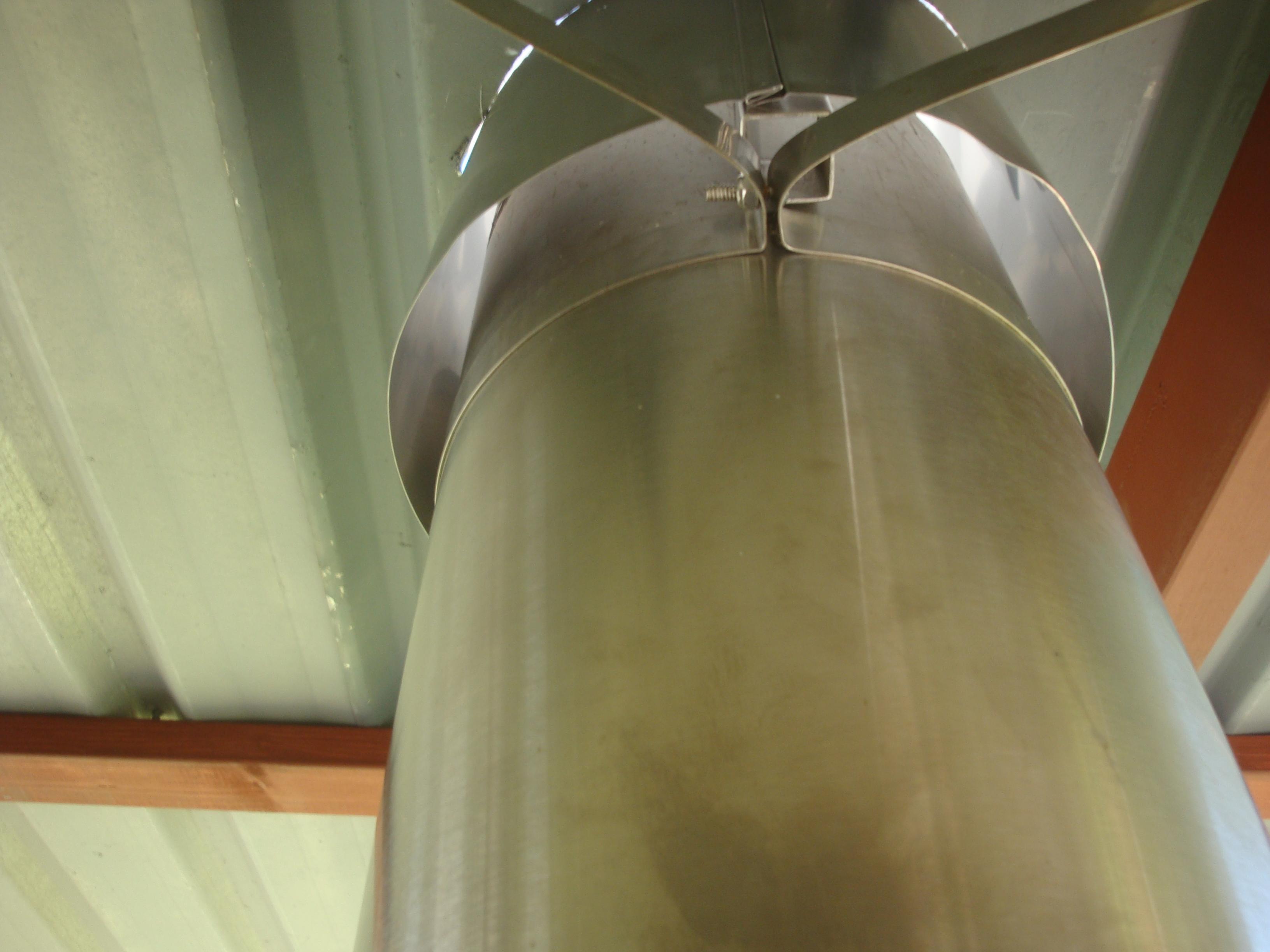

                  I have an 8" flue and had a 10" outer pipe and cowl made for that. I made the hole in the colorbond roof neat and tight and used silicone to seal it. The stainless doesn't get so hot and this set-up has been operating for some time and is holding up fine. The flue pipe exhausts above the seal at roof level and the temp of the roof at the sealing point doesn't get much above ambient.
                  A local sheet metal workshop charged me $90 for the outer chimney pipe and cowl.
                  The silicone had the same heat rating as the red dektite and was considerably cheaper. I think there is always a temptation to over engineer these things.

                    I like what you done that, I was looking in your thread on the photos but don't recall seeing the one from above.
                    that is the finish on top that i'm aiming for but Is there any reason why i couldn't/shouldn't just go single flue? tube of silicon i got from Ben is rated to ~500C

                        Hey Croc - I missed your post and question. I am not sure what temp the flue would get to if you only had a single pipe. I suspect that it would push the limit of your silicone but that would depend on how intense the fire was and how much flame was going up the flue. I also suspect that there would be a margin built into the rating of the sealant. For me, I would give it a crack and keep an eye on how it was handling the heat.
                        Just my thoughts. Your build is looking good, you should be happy with that.
