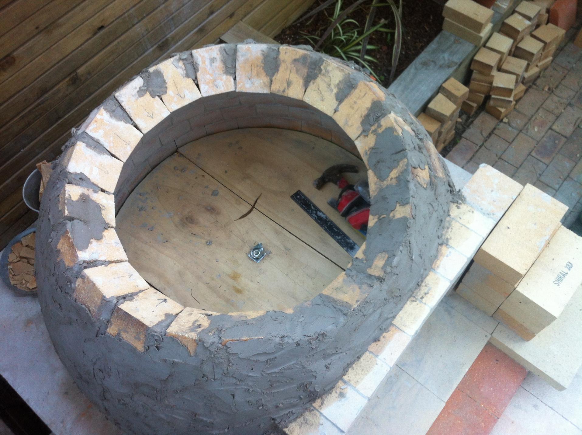

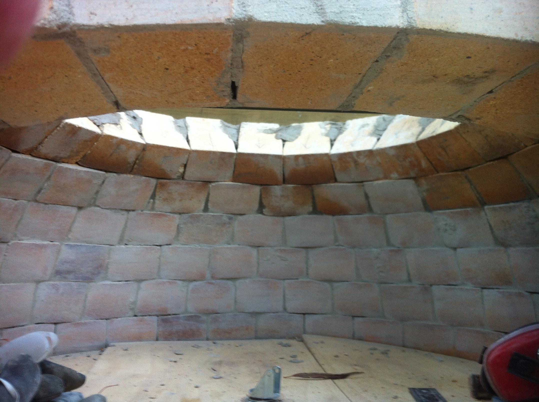

ID:	356385 Click image for larger version
ID:	356387 Another couple of courses today to take it past the arch. Bit trickier than I thought it was going to be, but all good. I was going to start another but it's now too steep for the bricks to stick. I tried the angle clip and string trick but that didn't work and it was way too much trouble to cut individual support sticks so...it's the sand mould to finish.
                          I had some thick ply lying around, so 10 minutes later I had circle cut out and did a test fit. Trimmed it a couple of times and it fits well. I'll grout some of the gaps before I build the sand mould next week and with a bit of luck I might be able to finish the dome.
                          I could have got a bit further this weekend but the next door neighbours had a kids party and that angle grinder makes a hell of a lot of noise so I had to pass on cutting any bricks.

                            #103
                            Just me talking out loud while I'm having a beer and waiting for the meatballs to cook...
                            Just read a post from a couple of years back. By Dave as it turned out. Suggesting that when making a sand dome for the last 3 courses or so to throw in a few empty PET bottles to bulk out the area so you don't need so much sand. I would have probably thought of that myself. But after I had finished. Great idea, Dave. Can't wait to tell the Italian guy in work who has a couple of tonnes of sand delievered to make the mould for his barrel shaped oven. Maybe Ll he needed was a a couple of bags.
                            I'll grout any gaps before I form the mould, but the brick cutting seems to be working ok and there's no too many and those are pretty skinny. May use the last of my super-duty mortar mixed with some crushed brick to bulk it out.
                            Not sure how long to leave the mould in place, although I've read one post where the guy did the last two courses, fitted the keystone and dig out the sand immediately. Jeez, not sure I have the confidence for that, although the physics says it'll be fine. I can see I'll have to do Brendan's reverse breech birth thing and get in there at some point to finish off. I don't mind pointing a few gaps but I'm not looking forward to removing a lot of excess, rock solid mortar.
                            Sourced my Vermiculite for the render over the top of the insulation. Place on Anzac Parade that does a lot of hydroponics. Get a 100 kg bag on Saturday and I think, from what I've worked out, that a 5:1 mix with cement will require 30kg of cement. So another couple of bags and I'm good. Oh, and chicken mesh to hold the insulation in place. And lots of wire to hold the chicken mesh.
                              #104
                              G'day wazza
                              Your Italian mate can save himself a bit more shoveling without getting himself a cola habit with a couple of upturned foam broccoli boxes. If they don't fit cut the ends off and cut down with a serrated knife and tape back together.
                              For your top dome. Cut yourself 2 profile pieces out of thin ply. Cut some slots in them and fit them together as a cross. Makes it easy to keep the hieght and shape right as you form you sand mold.
                              Drop the sand ASAP it will allow you to clean the excess mortar off the brick face. Repoint later.
                              Everything comes in tubes these days except mortar it seems. Take a tube of gape filler, it's both cheap and water based. Cut the end off as normal, use a piece of dowel pushed up the tip to push the end out. Clean out the contents, wash clean, fill full of mortar, replace the end.
                              Fit your mortar tube into a $5 burnings gun and you have one of the easiest ways to repoint I've come across.
                              Not my ideas I'm only smart enough to recognize a good idea when I see one....
                                #105
                                The form can be removed immediately. If not, there is something terribly wrong with the design. I used a car jack and a plywood disc for my last 4 rows and the plug. What I liked about it was that I was able to drop the jack on a finished row to clean and point where needed. It can the be easily set back into place. And, there is no sand to drag out. But, the disc needs to be small enough to removed through the door .
