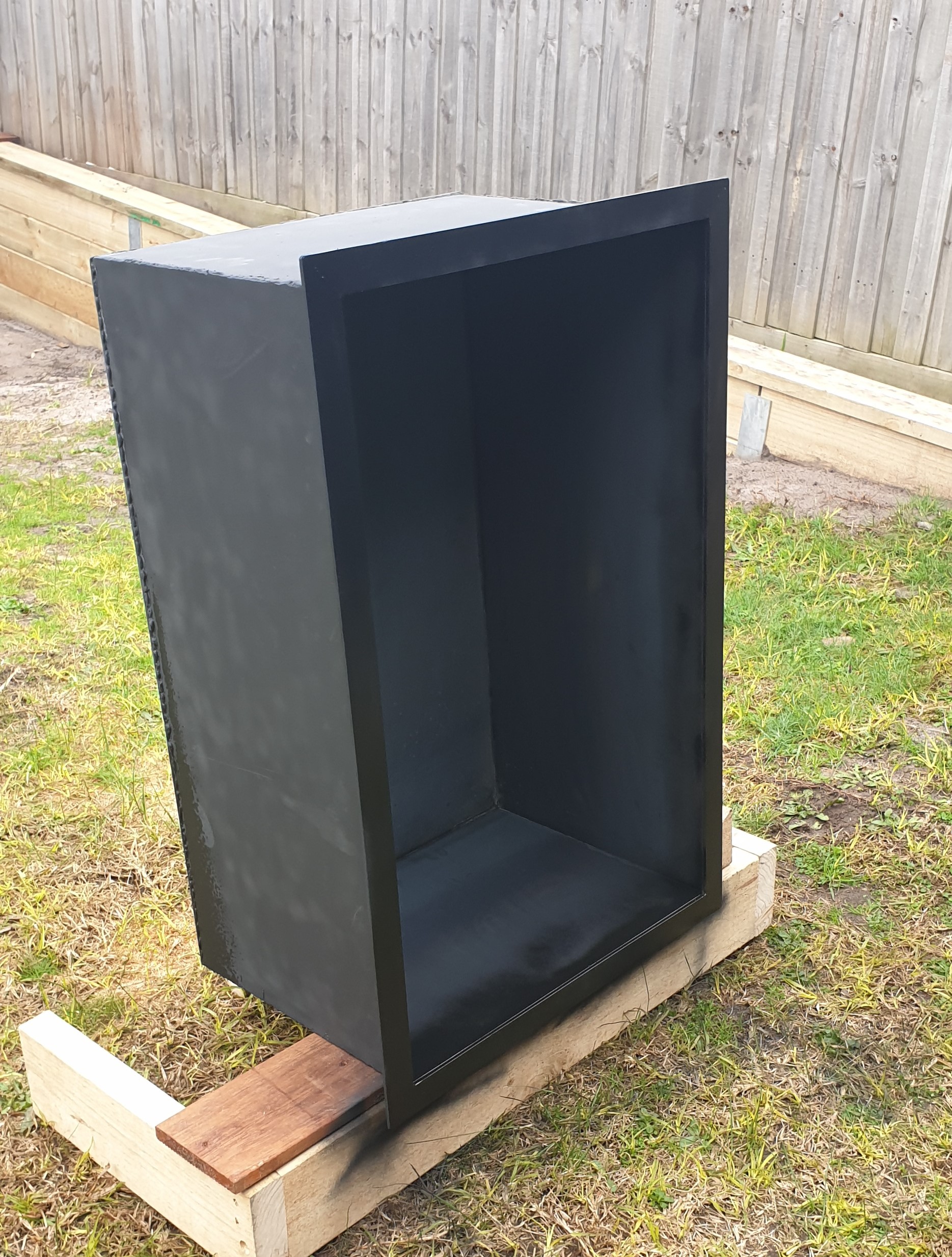

    I'm currently locked down in Vic thanks to Covid and wan't to build my own brick pizza oven, I found this website after researching ovens online, I have decided that I will build the 36" pompeii as there are plans for it and I need plans , not sure if there are metric ones anywhere though, I'm in Carrum Downs Victoria and haven't bought anything for it yet, I have made a start though, I have bought some plate steel and welded a fire wood box together and cut a hole in my retaining wall for it to be recessed into, then in the next week or two a slab will be getting put down above it.

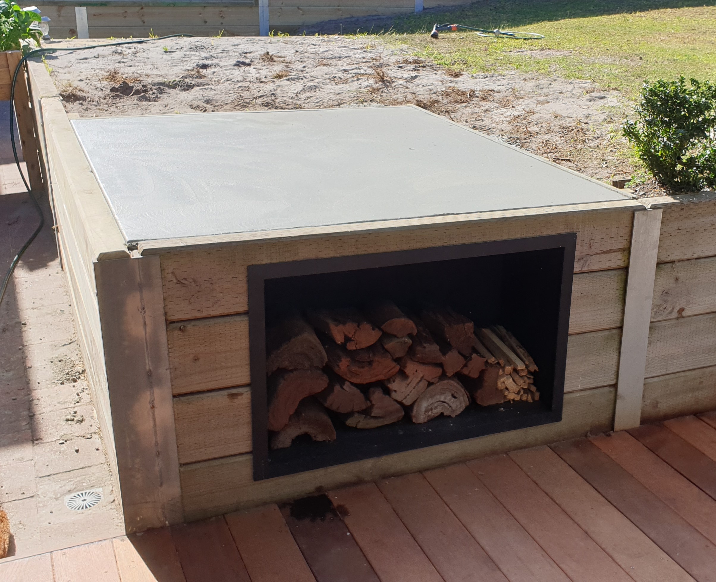

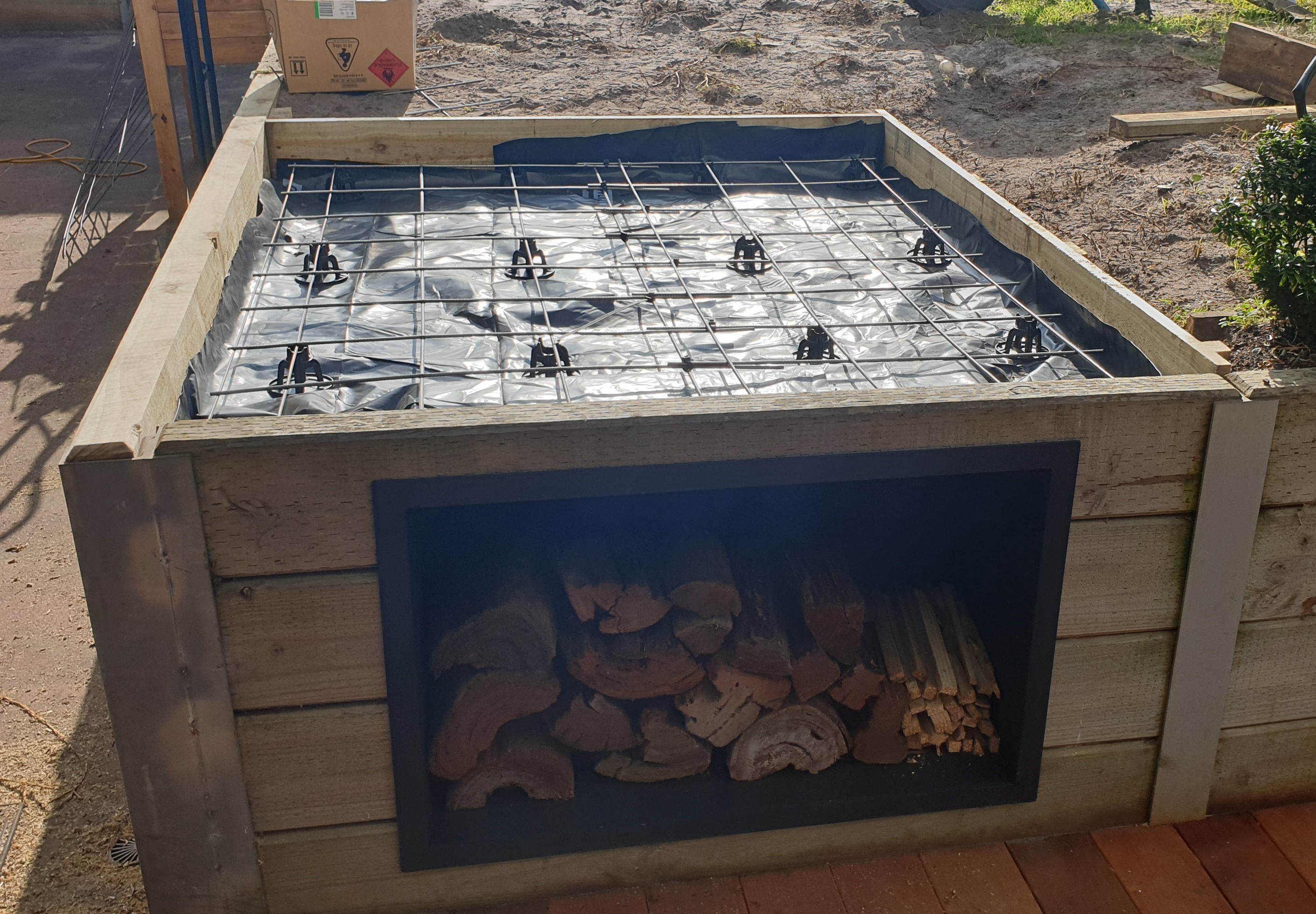

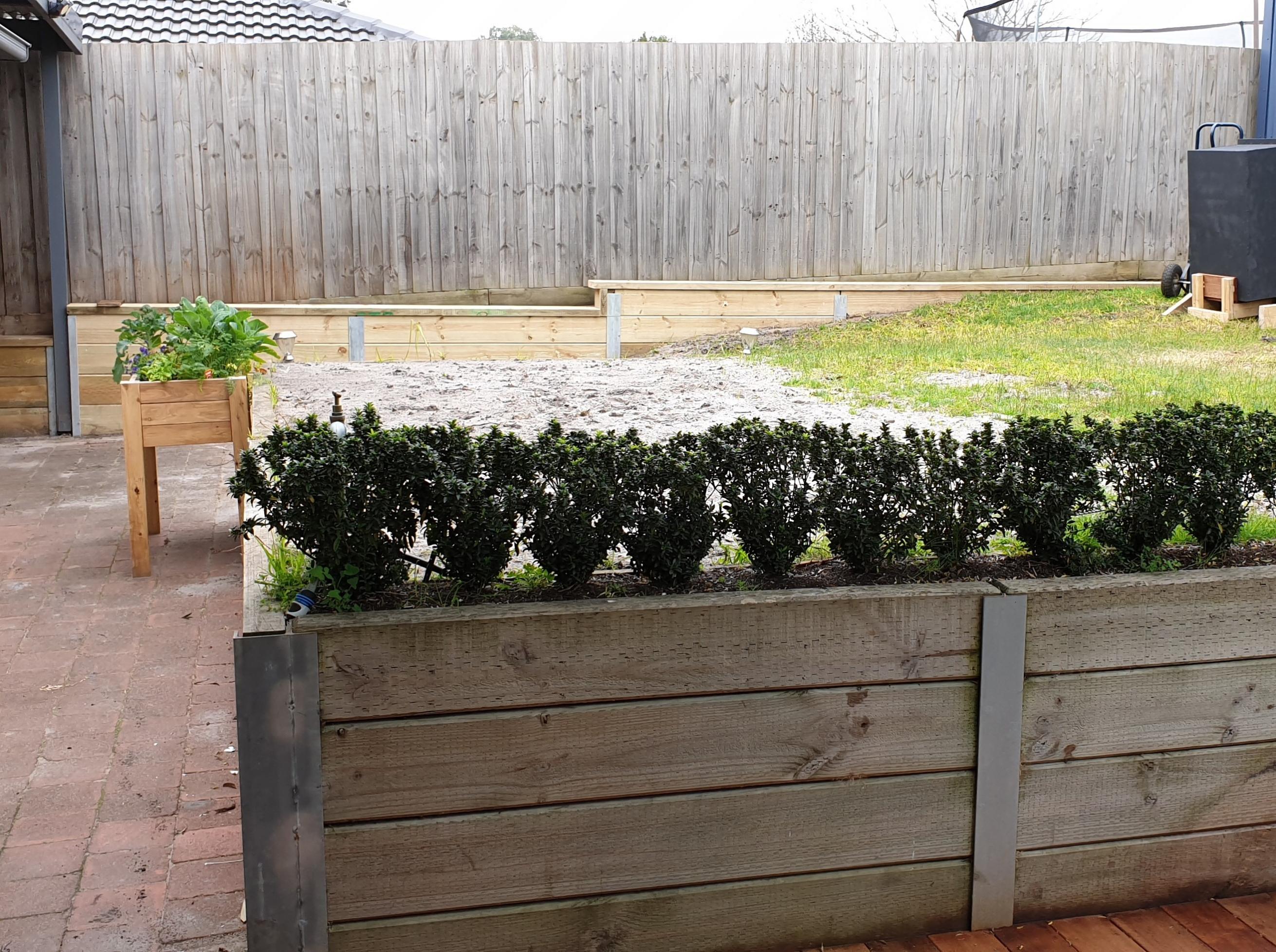

                I will attach a few photos, so far I have bought some sheet steel cut to size, welded it up to make a fire wood storage box, painted it, then cut a hole into my retaining wall and recessed it in, removed dirt, removed garden tap and plants, boxed it out, put in some plastic and mesh, I bought the concrete and just got a local concreter to do it, thats it so far...... it turns out the concreter has built a heap of ovens and also has a mobile pizza oven business and gave me some tips which was great, 1st one being that I should reconsider my finished floor height as he thought it was too low, my finished height will now be 1100mm off the deck.
